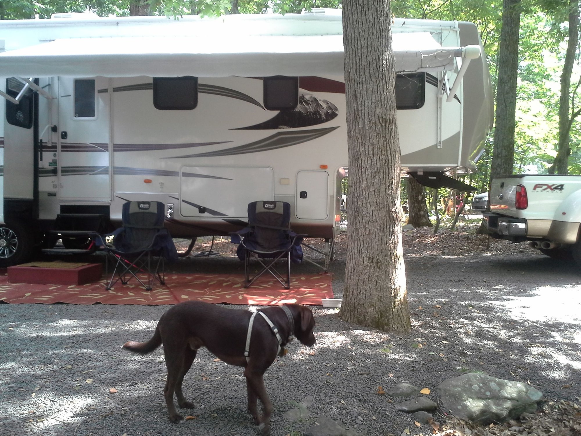

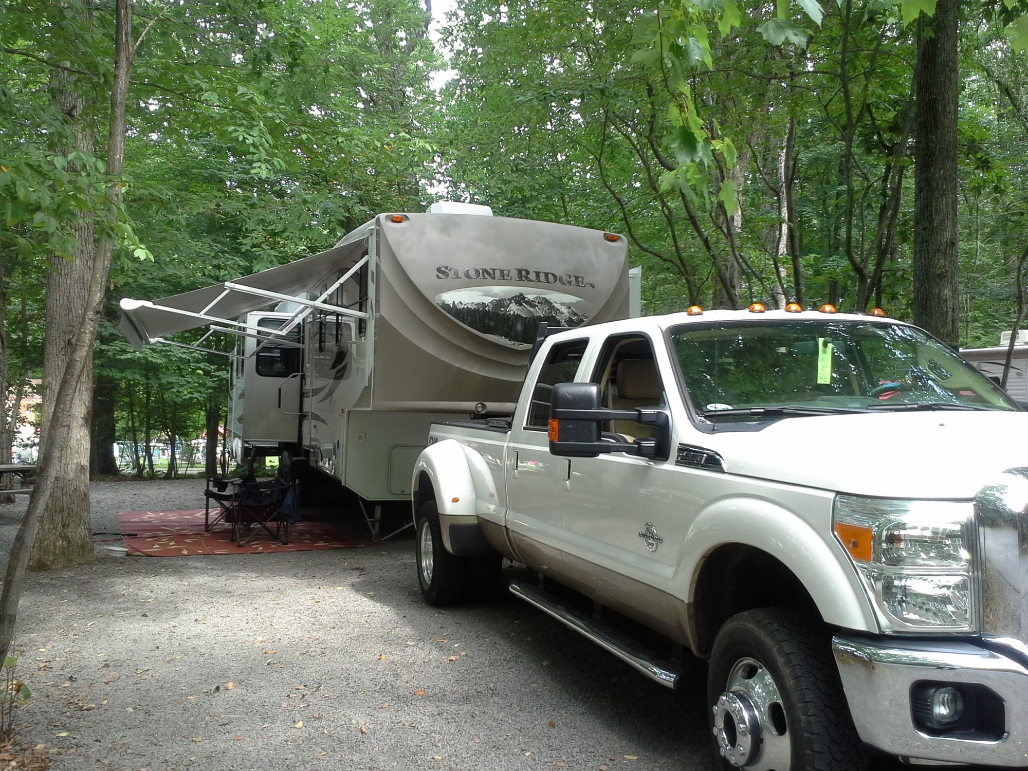

Taking a break in the mountains of PA

Looks peaceful Scott.... I'm envious! Someday though......

Looks like a nice CG. Can I ask where you're at?

Otter lake.
otterlake.com

Very nice Scott! Looks like a great place to unwind. I like your awning. I don't care for the newer ones that stand exactly straight out from the camper. They provide little shade and can't be reached without a ladder. Very disappointing to see the newer rigs with awnings that just aren't that easy to use anymore.

This is what we like about it.

What kind of light is on the inside edge of that awning? LED?

It is an led strip that is recessed into the awning.
