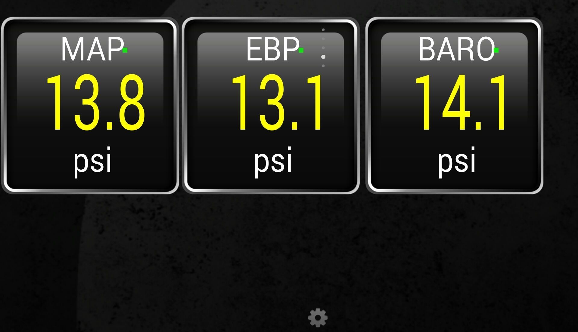

Thanks Pikachu and Tugly. I tried those and now my Baro is working, but my EGP still isn't. It does weird things and stalls the truck if it's running. I tried deleting the PID and reentering it, but it doesn't help.
I did use Torque to check some sensors, and this is what I got:
What do I need to do to get these to be closer to equal?

I wouldn't chase that dragon unless you had issues. The only thing that can be done is replace the EBP sensor, and I can't see doing it for being off negative 1 PSI. It can't hurt to puff up the EBP sensor with a known air pressure (no more than 35 PSI) and watch the resulting reading. I've taken a sensor out, connected it to the cable, turned the key on to connect to Torque, and used an air compressor with a regulator to test a sensor before - it works well.
Bad EBP sensors are usually biased with a higher reading than MAP and BARO. It sounds like your versions of Torque and Android don't like the combination for EGP. I had to reload Torque and manually configure all my gauges to correct a similar problem, making sure I disabled Torque's ability to send commands to the truck.
Settings/Plugins/Allow plugins full access is not checked.
I also tell Torque to not calculate MPG. I don't want Torque to spin its wheels on something that I'll figure out at fill-up.
