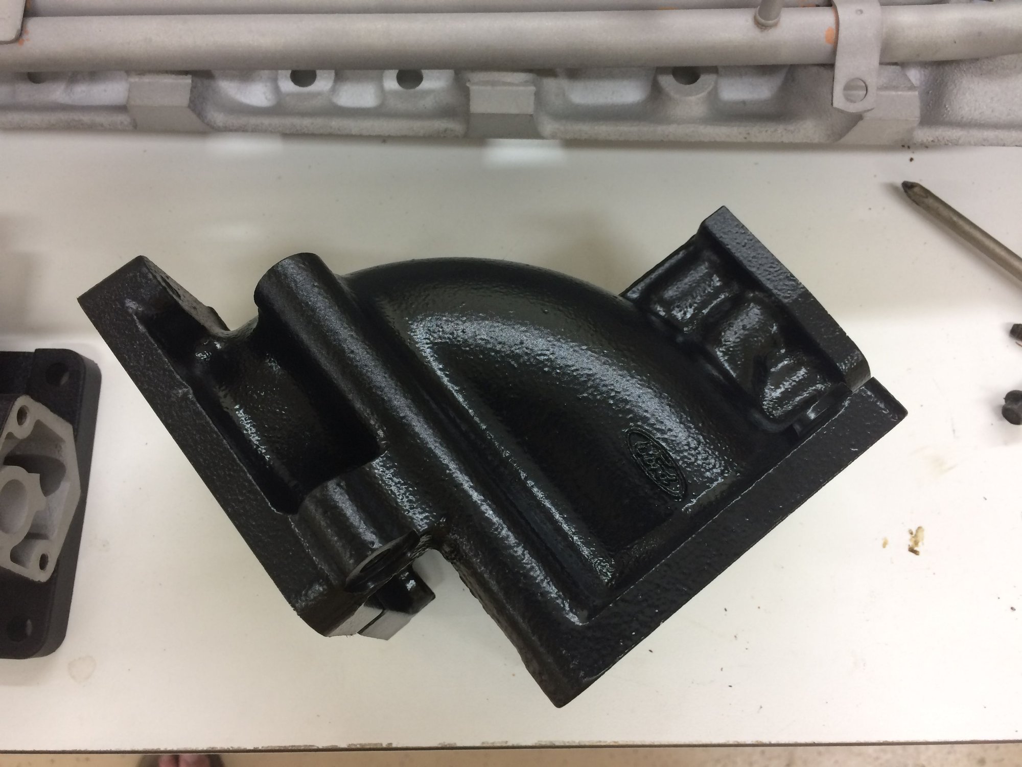

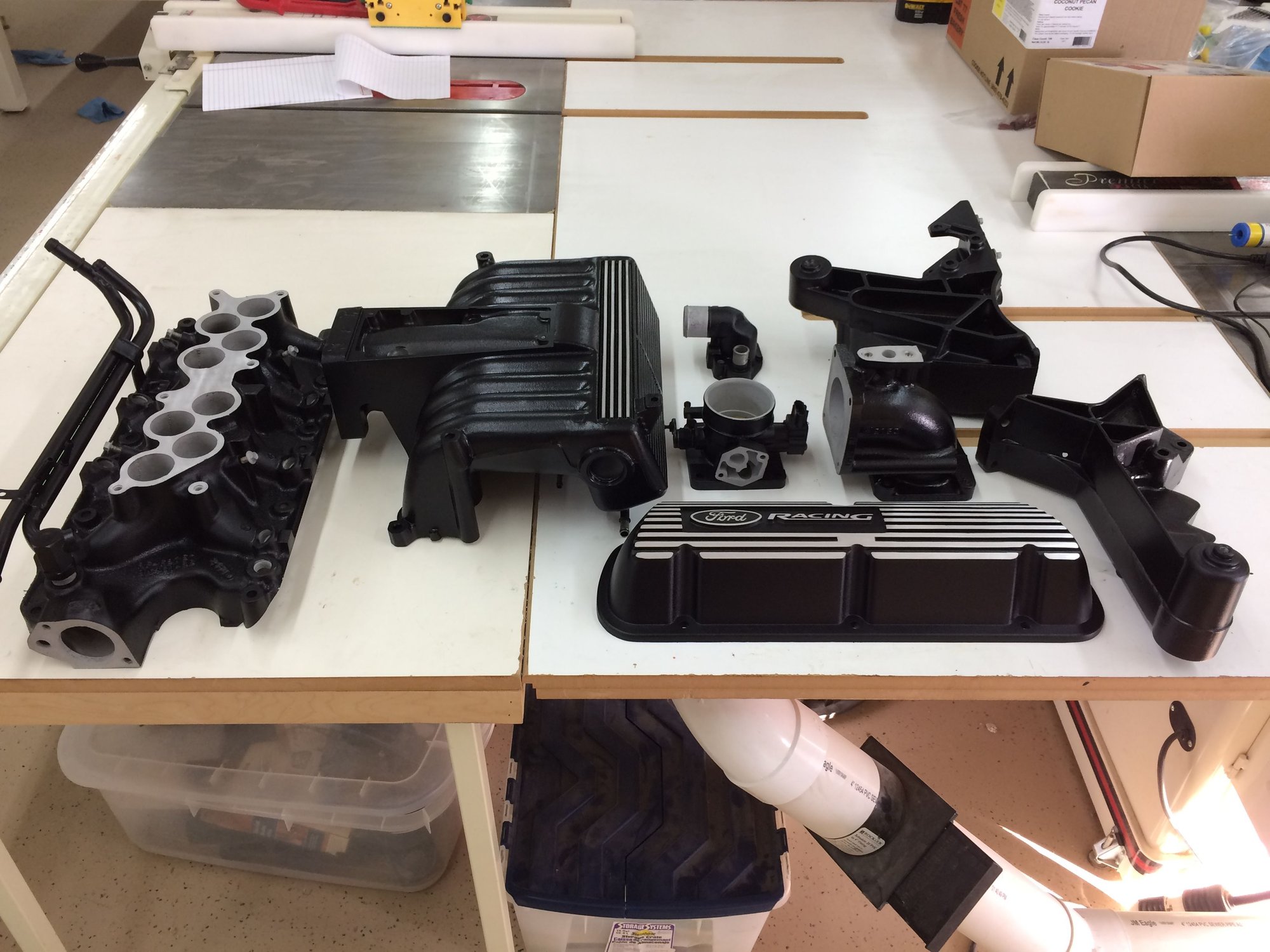

The trans is a 4r70w. computer controlled (no TV cable). The Throttle Body is normally attached to an EGR elbow and points forward. I removed the elbow because I removed EGR from the tune (EGR is fully external on the 2000 Explorer), and with the elbow the oil filler tube on my new valve covers blocked the TB and air intake.
I bought the Sanderson Headers made for the P heads, so they clear the plugs ok. A little tight on #8 because of the dipstick mounting.
All of the intake and the accessory brackets are powdercoated wrinkle black to match the valve covers. EGR Elbow (deleted)
I am going to have to fabricate a new throttle linkage bracket because the throttle used to attach to the EGR elbow, but that shouldn't be too tough. I'll just use the old bracket to determine the geometry.
