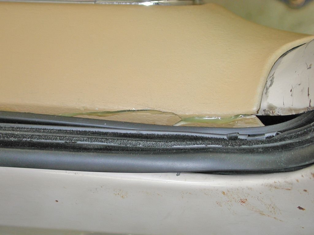

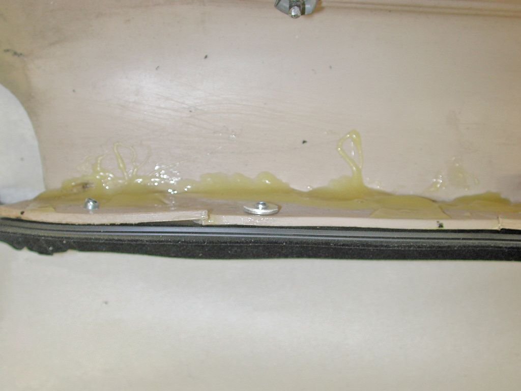

Sorta finished up the interior on Rusty today. Here's the inside of the repaired door panel. Note the pop rivets that David suggested. I used 1/8" OD aluminum rivets 1/4" long. Worked well, but the #8 washer I used on the one on the left was too big. The #6 on the right was just right.
Here it is on the outside. Not perfect, but the West System epoxy is good stuff.

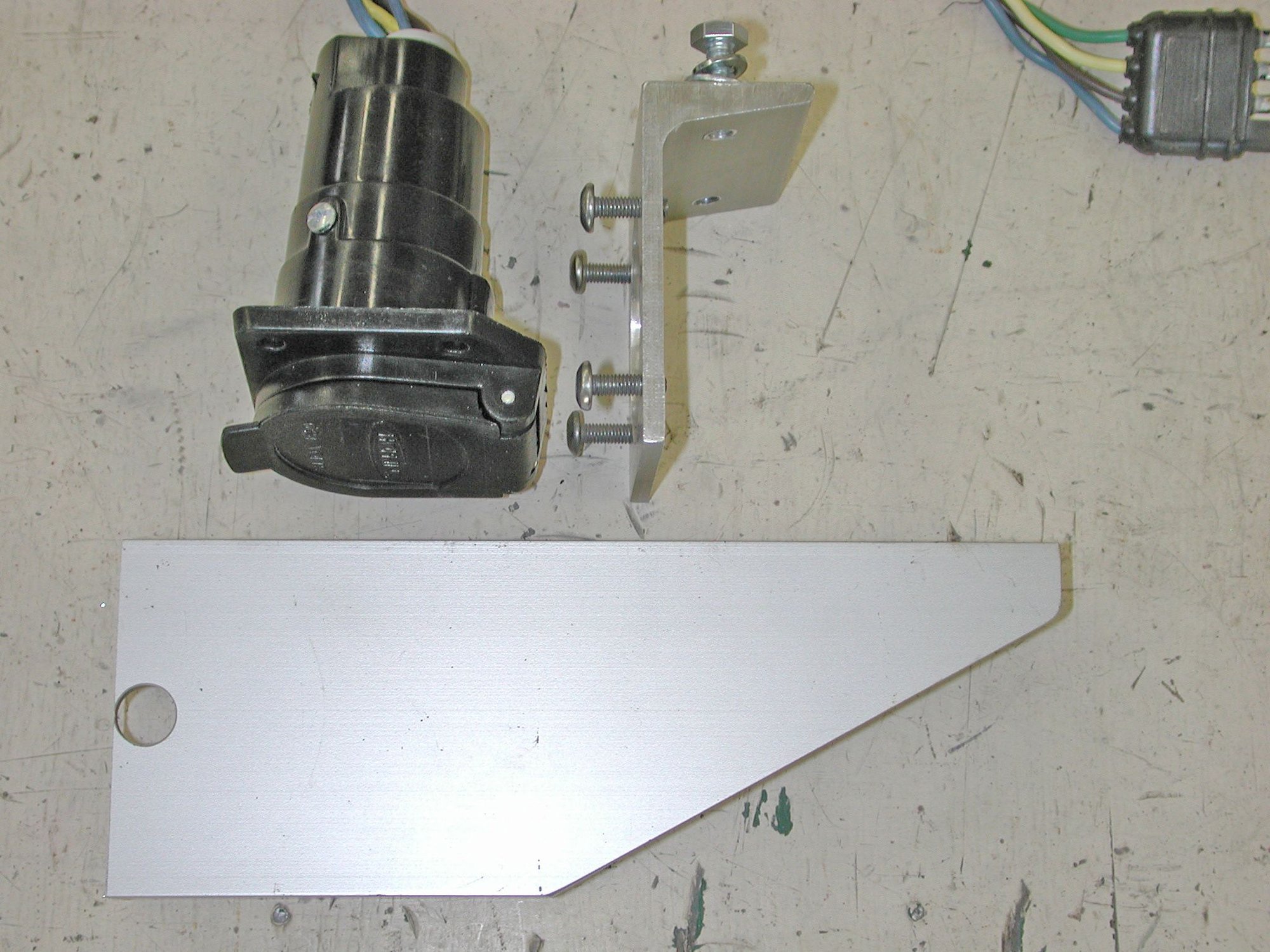

Just posted this on WHYDTYTT, so if you think you are seeing double you may be. But, I wanted to capture it here in Rusty's thread as well.

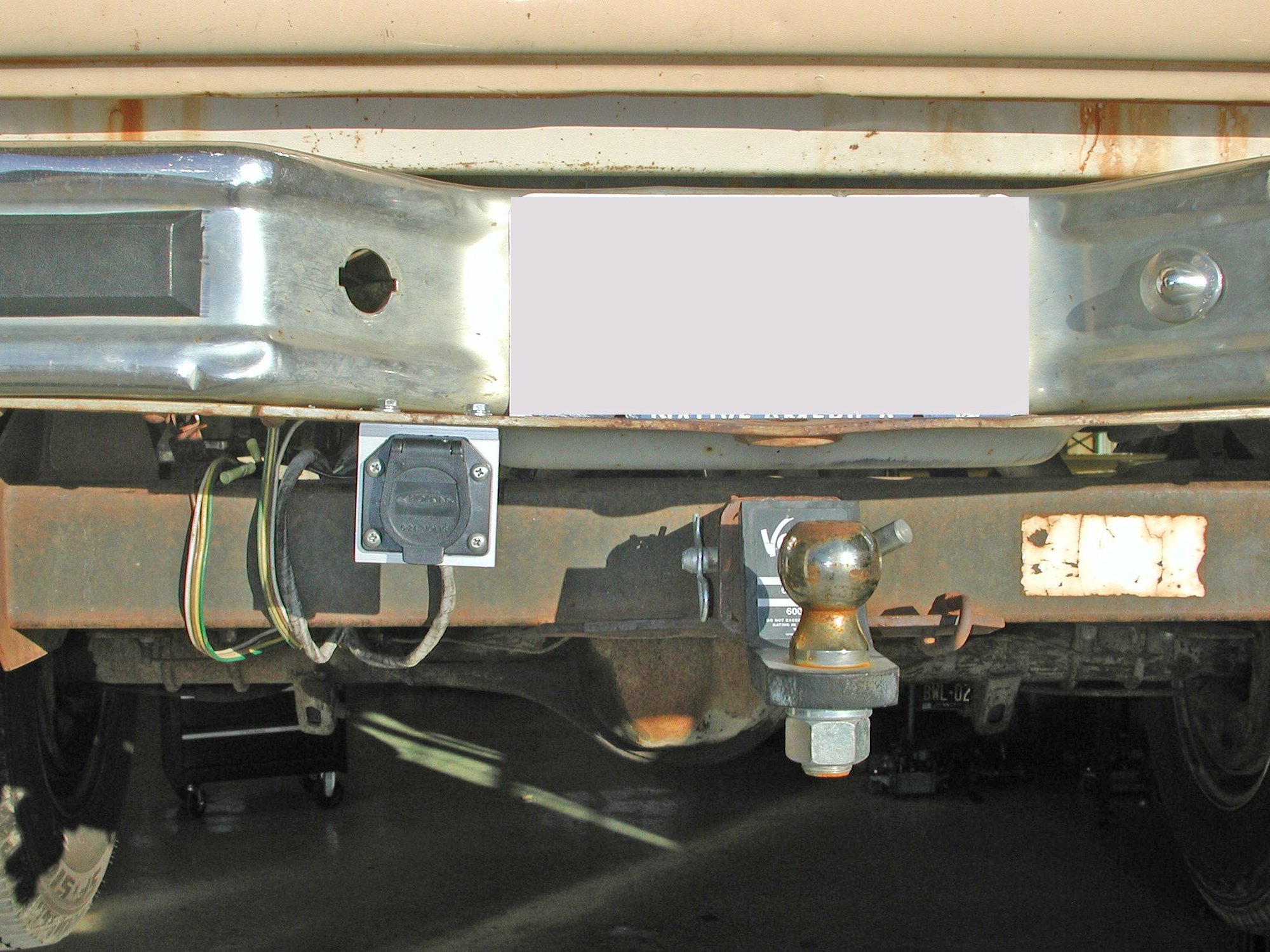

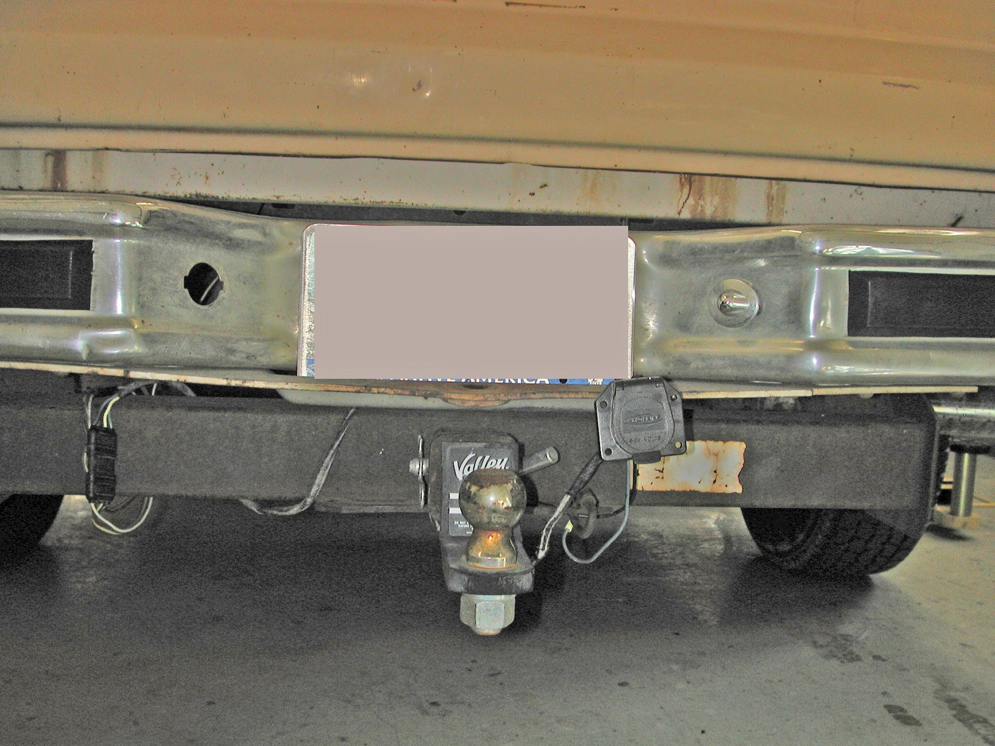

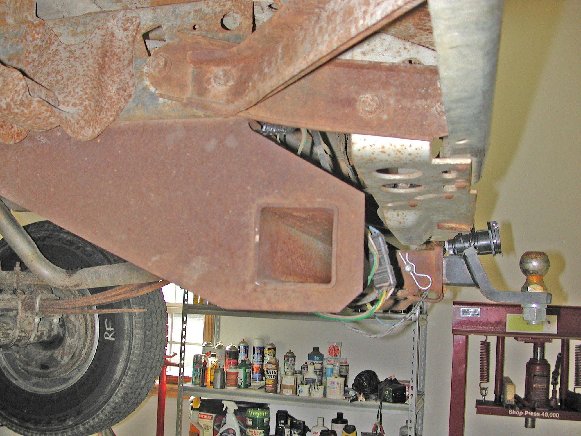

Well, I posted these pics of Rusty on a different thread earlier today and that reminded me that the trailer connector's attachment was ...... tenuous to say the best. It was held on with 4 tie-wraps and it kept slipping out.
So, I made a project out of making a bracket to hold it properly. These two pics show the type of aluminum channel that I made it out of as well as a couple of views of the finished bracket. In fact, the bracket came out of a piece exactly like that one.
And, finally, the bracket installed on Rusty. Works well and is recessed so it is somewhat protected from heads and hands, or they from it. But, now that I look at it I should have rounded the corners a bit more. Oh well, it comes off with two screws, so....

Gary, I would say that it sucks you had to fix something that someone jerry rigged but lets face it. If someone hadn't have done that then you wouldn't have made such a nice fix for it. You sir, do good work.

Well, I have to be honest - I'm the one that jerry-rigged it. I was in a big hurry as my first body man had just fallen out with his "wife" and she kicked him out of the house and shop. So I had to get Dad's truck out of there immediately for fear she would confiscate it. I borrowed a trailer and discovered it took the round connector, so stopped at a parts store and bought one, tie-wrapped it on, and got the parts.
That was almost two years ago and it was still on there that way. But yesterday I shot some pics of Rusty's hitch for another guy and saw the connector. Yuk! So, having some time available, I decided to make the bracket. Now I have a nice bracket on a bent bumper with a rusty receiver hitch sticking out below. But, thst fits Rusty's style.

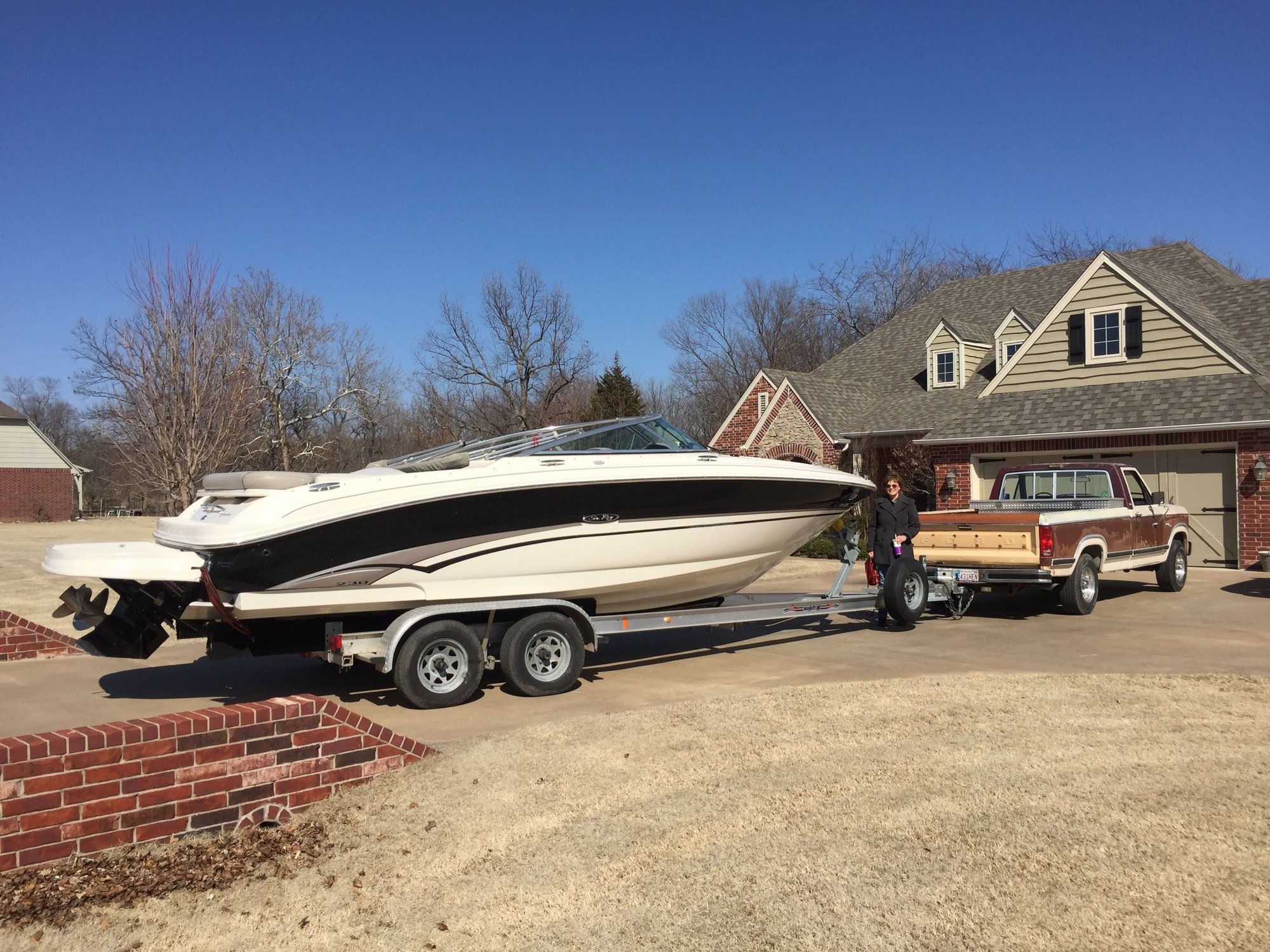

Time to update this thread. In the last two days I've prep'd Rusty for his 275 mile round trip to OKC to pick up the new-to-us boat:
The boat weighs 4200 lbs dry, so it will probably come in around 5200 lbs with the trailer as it is aluminum. Rusty shouldn't have a problem with that as he was happy with the '50 Chevy pickup on the trailer, which probably came in about 6500 lbs.

Made it home without incident. Rusty amazed me with how well he pulled the boat. I expected to be running @60 MPH, but he kept moving back up to 65. .
