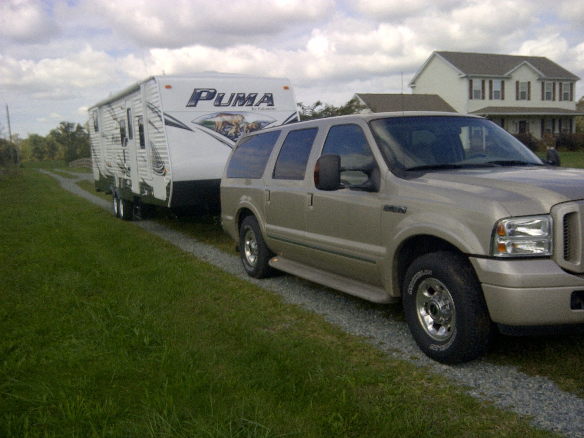

We just got back from our first RV trip. The weather in Myrtle Beach was warm and enjoyable. The Ex handled the camper just fine BUT my EOTs were high while my ECT was in range. The EOTs went up to 239 at one point. Looks like I need to do an oil and egr cooler along with a VC-9 flush (not in that order). I will also be looking at air bags to bring the tail end up some.
Below is a pic before we headed out.

Nice looking EX!
Sitting a little low in the rear!
Robot Check Robot Check
or
Amazon.com: AIR LIFT 57340 LoadLifter 5000 Series Rear Air Spring Kit: Automotive Amazon.com: AIR LIFT 57340 LoadLifter 5000 Series Rear Air Spring Kit: Automotive
The cooler is labor intensive but needed! I had similar issues with mine. I saw EOT go up to 240 F and water temps at 220 F while towing. Water temps recovered nicely, EOT did not! I will find out in a week if the cooler fixed the issue!

Keep me posted on the cooler repair. I am thinking about the Bulletproof modification with EGR cooler and the factory oil cooler rather than the external cooler. When that is done I will also do the STC.
My truck is a 2wd, is there a difference between the 2wd and 4wd rear air bags?

According to Firestone's website there is no difference in the kits for 2wd or 4wd.
When you say bulletproof modification with the EGR cooler, are you talking about an external oil cooler kit or replacing the internal cooler and deleting the EGR valve and cooler?
If you are talking about the external oil cooler kit for a bunch of $ that is your choice. It makes it easier to change the cooler in the future, but in a few folks opinion not worth the $.
