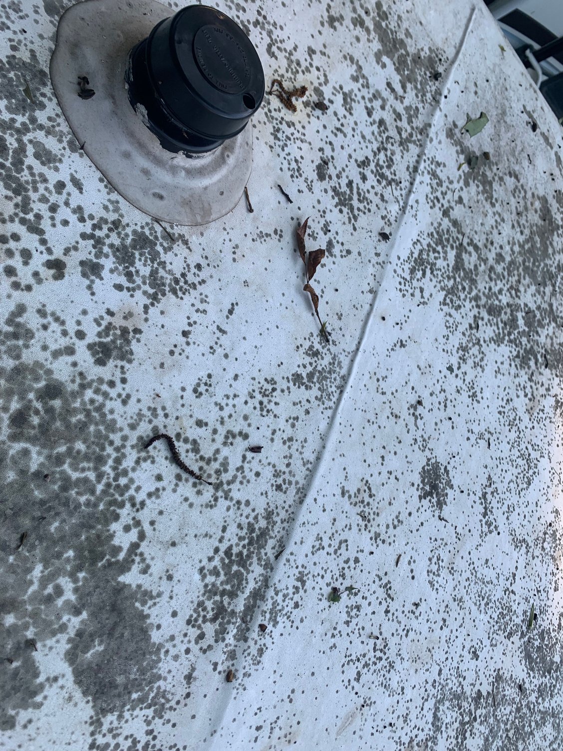

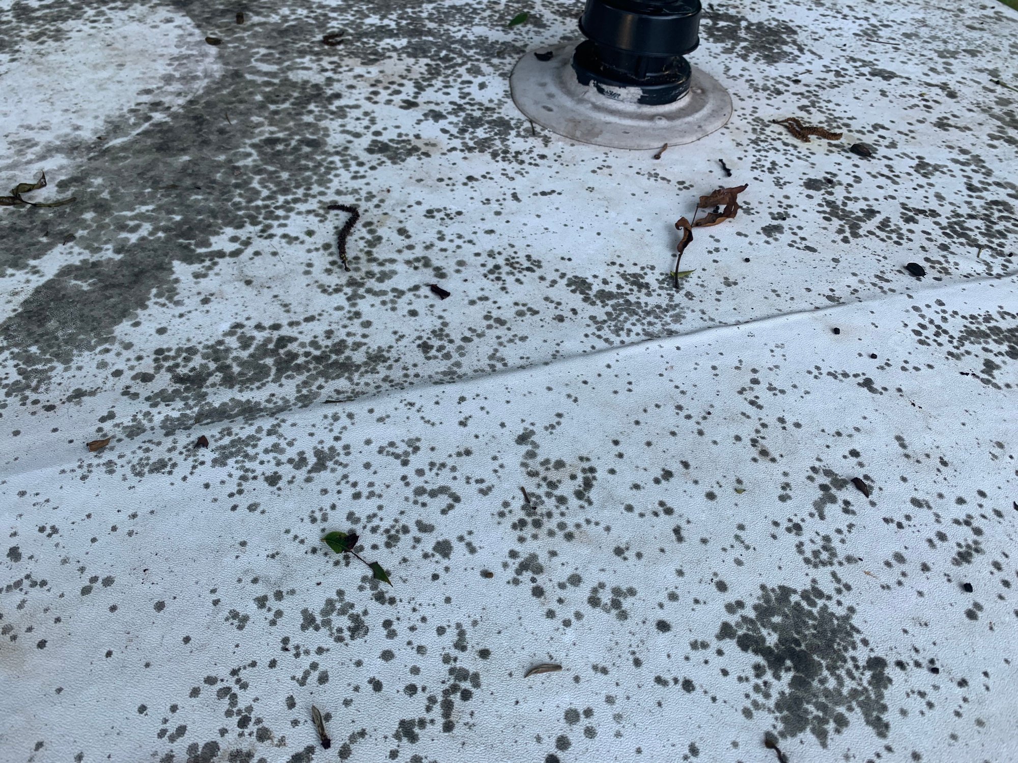

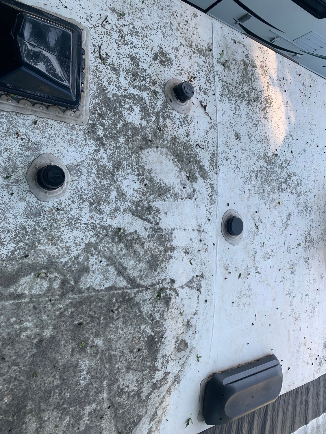

I might be purchasing my first travel trailer. I went and looked at one today that my wife really wants. It is only 2 years old and in good shape.
while looking it over I noticed something that didn’t quite sit right with me. I figured there is a lot of knowledge here so it would be smart to ask.
while checking the roof I noticed a raised crease/ bubbled area that went from one side all the way to the other side of the trailer. It looks like it is where two sheets of plywood come together under the membrane. My concern is that the membrane is raised in that spot. They pictures I took are not the greatest. I will post them hopefully someone can tell me if I should worry about this or is it normal.

I'm no expert, but the rubber roofs will wrinkle up a bit as they aren't really attached other than on the perimeter. What I'd be more worried about is al the junk on the roof and getting that cleaned off. Certainly hasn't been maintained IMHO. It's gonna take a whole lot of scrubbing to get all that off.

I clean my membrane roof every year, you can use the Thetford roof cleaner/conditioner. Also the StarBrite mildew stain remover. The roof board is most likely OSB, and the membrane glue just doesn't work well there. There are many cases of air pressure getting under the membrane when driving lifting the membrane up like a bubble. I have experienced that myself. I would be most concerned about any possible odor inside the camper first.
