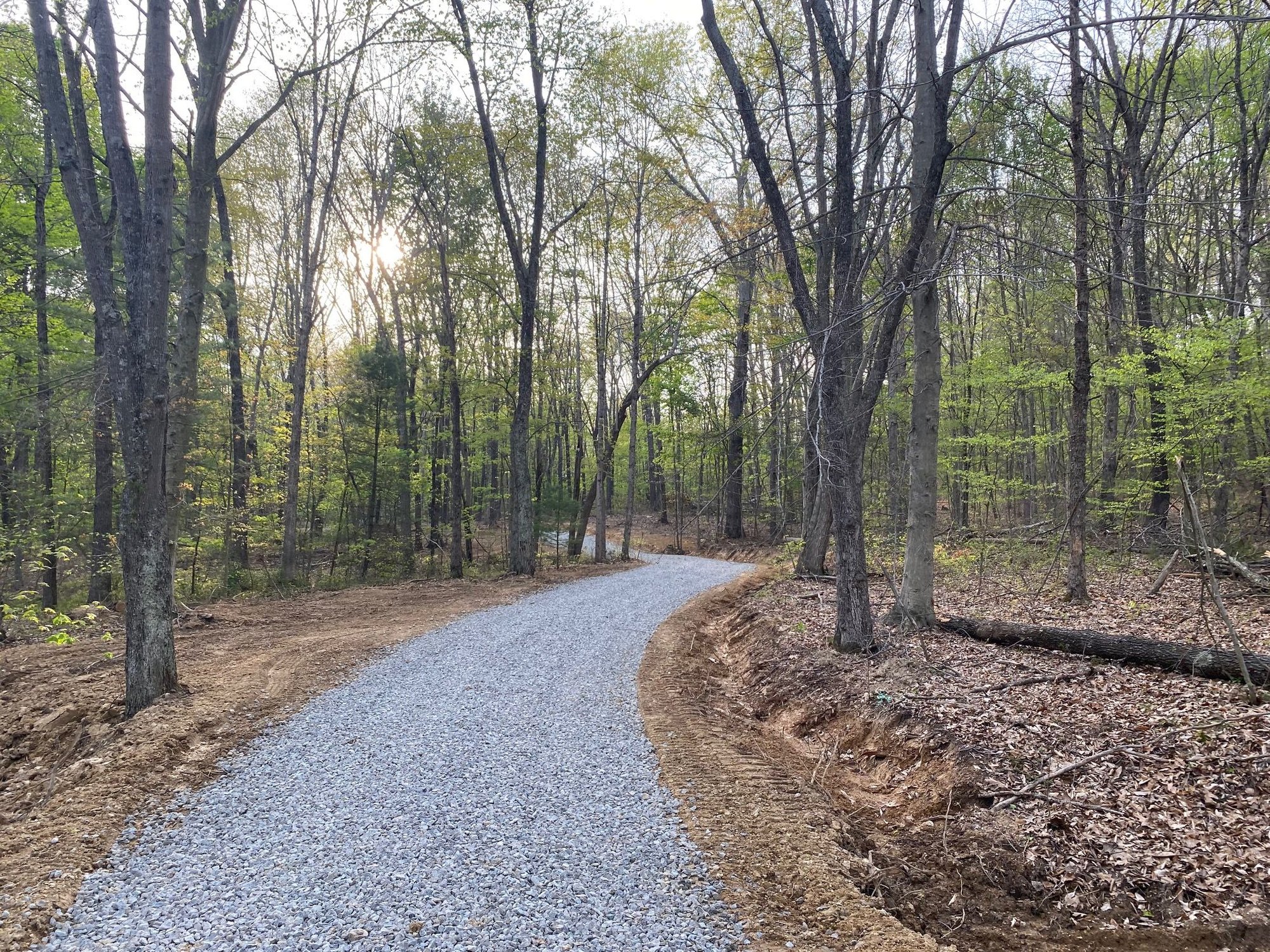

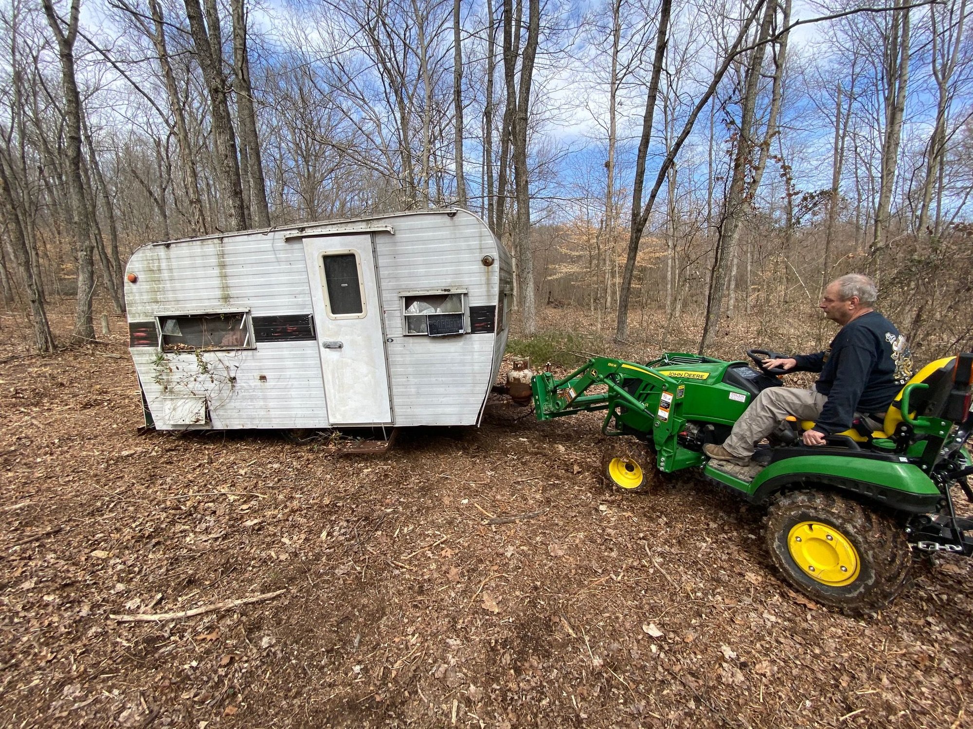

We are close to Waverly, just south of Chillicothe. It came with a camper, a bit rough.
A little bit of the 1600' of driveway that was just finished.

That's a beautiful area down that way. Spent a lot of time in those woods with the Chillicothe Enduro Riders. Don't ya love the long driveways? Mine between 1750 and 1800 depending on where the wife decides the front of the house ends up sitting. Won't drop 57s until the construction is done, now it's just roll your ankle #2s. You've got prime mushroom hunting in April down that way for sure.
