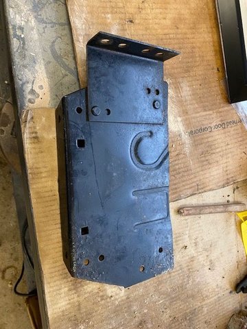

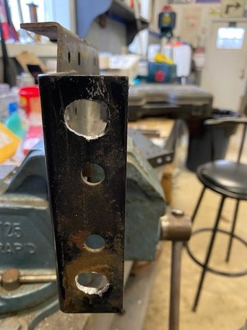

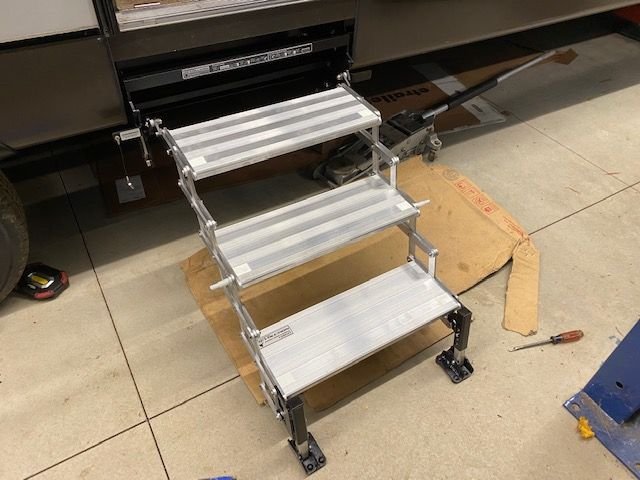

Installed a set of the Torklift steps yesterday on our trailer. Had to do a little fabricating, but not too bad of a job.
First job is to remove the old steps. According to the instructions, there are different ways some manufacturers hang their steps and with type A it works out to a simple unbolt old steps and bolt up the new ones. Jayco uses method B of course. 4 bolts horizontal through the frame and a couple of carriage bolts down through the floor. Of course the carriage bolts are rusty and spin in the wood. I just cut them off and replaced them with some stainless steel carriage bolts from the local hardware store. (Sorry, no picture of that) Fortunately one is under the door trim and the other was just slightly in front of it and was able to get them out by carefully peeling the flooring back without leaving a mark on the floor.
Once removed, I cut the mounting portion of the old steps off to use that as a bracket for the new steps to be bolted to. On mine, I needed an extra 3/8" of width to fit the new steps, so I elongated the mounting holes on the old step brackets to get a little extra width. Then some measuring and cyphering on the brackets to calculate where to drill holes for the new steps to mount. Bolt the cut pieces loosely back on the trailer and then bolt the new steps to the bracket. A little jiggling to line things up and tighten everything. Replace the trim and job done.
Very sturdy and well made, I think we are really going to like them.

I was surprised to see some manufactures still using the hanging 3 step RV stairs and not the Step Above type setup.
I like your setup, may have to do this when I am told to upgrade them. The more we shop the more we like our current camper's floor plan.

Looks good Eric, we recently installed the fold out Step Above models stairs, the ones you have were also something we looked at but the solid ones won out for us.
On your Jayco does that little amber light only shine when the awning light is on? That's how ours is, would be better if it was on when the awning light was off. Of course now with the flip up stairs installed I'm looking for a storage box to fill the old folding steps opening, but of course none that I have found match up perfectly and take full advantage of the room under there. And with a box there that little amber light will go away.

Yes, the light is the same. Sounds like you need to build your own box to the exact dimensions. We thought about the other style steps, but went with these. Knowing TorkLift makes a supreme product helped tip the balance.
