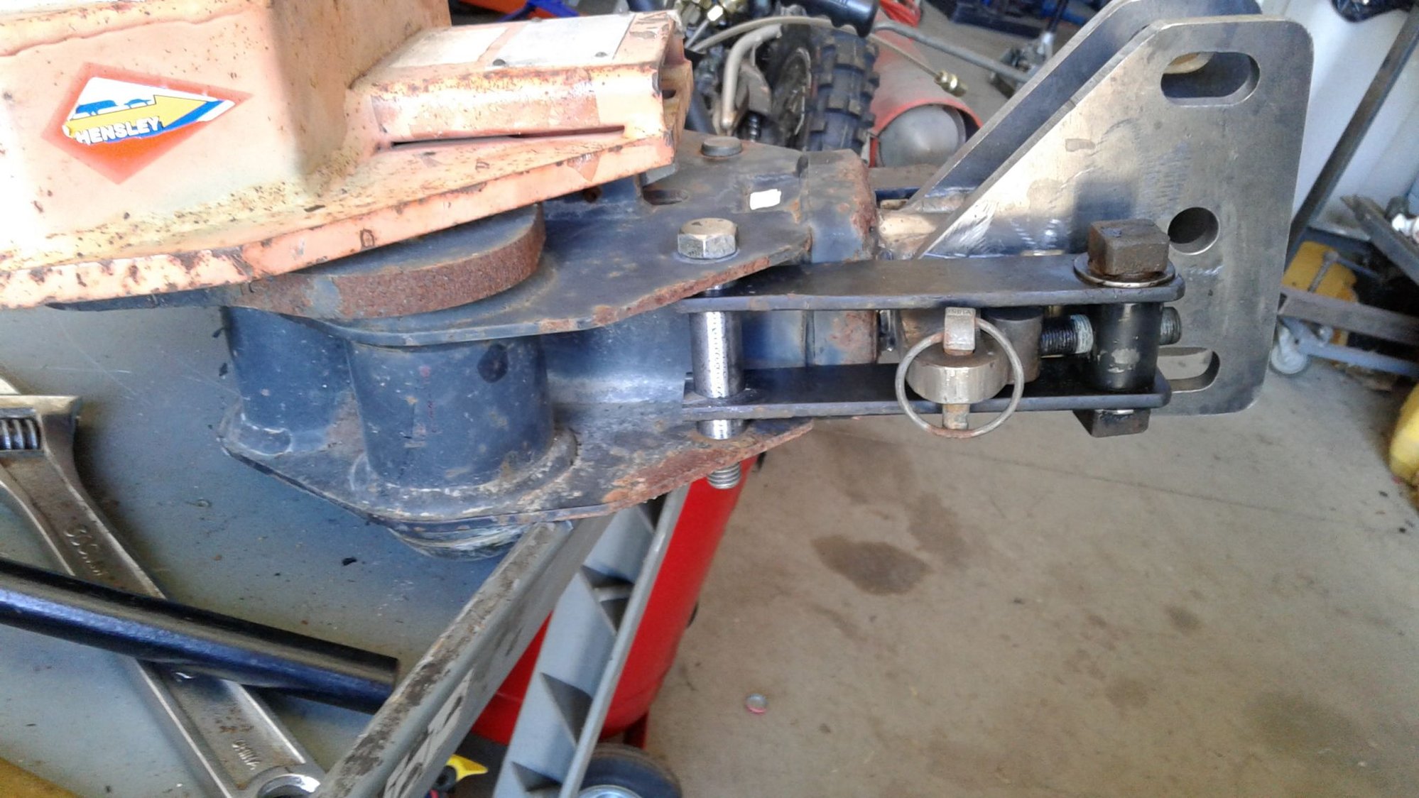

Worlds longest WD hitch build... After I completed the hitch bar for the Hensley Arrow to 3P conversion I bailed on the rest of it. The jacks for the 3P won't work on my trailer propane cover and as it's fiberglass I didn't want to modify it and cause cracks to form.
I just ponied up and bought the missing parts I needed, struts, jacks and brackets. In the end it was all worth it in the towing experience but the link bending long term might prove to be an issue or it might be fine, time will tell.
My version of the hitch bar has 3 3/4" bolts versus the 5/8" of the 3P. This also allows you to use pre-fabbed truck end hitch bars from any manufacturer. It still has the full range of adjustment like the 3P and the locking bolt to lock it once a shim selection has been installed. This change and shortening the hitch bar allowed me to put the OCL wings on the side of the hitch shank side plates. I was not worried about the stress of the wings on the 1/2" plates but decided it better to be safe than sorry so I drilled 1" holes in the side plates at the front edge of the OCL wing. This hole was rosette welded and then ground flat again to tie the side plate into the hitch bar. The OCL wing was then welded on the side plate. While I was drilling I moved the reciever hitch pin hole 1.75" to the rear to allow the hitch shank to insert fully into the truck reciever. With these changes I am close to the original Hensley ball to reciever edge distance maybe closer.

Nice work. I'm currently putting together a Hensley also. I was looking at the PP adjustable shank, but frankly, I like your design a lot better. It makes so much more sense to be able to use any standard adjustable shank.
What did you use on the side plates? Half inch ?

Yes, 1/2" A-36 for the side plates.
I originally was just scaling the patent drawings to get the layout but I didn't catch the bolt holes were 5/8" until I cut the first set of plates to test the design. I then found the bolt heads of the 3/4" bolts won't clear each other very well and the meat between the holes is pretty thin... I went back and reread the 3P owners manual and saw the parts list was for 5/8" bolts DOH.
If you don't relocate the wings to the side plates this thing starts getting pretty long, I think I was over 2" longer than the Hensly configuration. Since the whole goal was to tow better I didn't like that idea.
Another idea is to flip it around like 3P does and use the pre-fabbed shank as the HAHA bar and add the wedge/wings to it. For some reason I could not get into this idea even though it might be easier. I am weird.
This is the 3P bolt layout but doesn't work with the 3/4" bolts.
This is the 3P HAHA bar
This is the 3P adjustable bar
