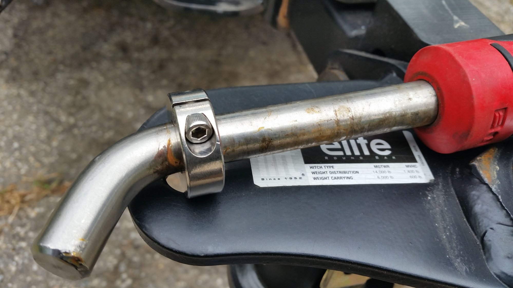

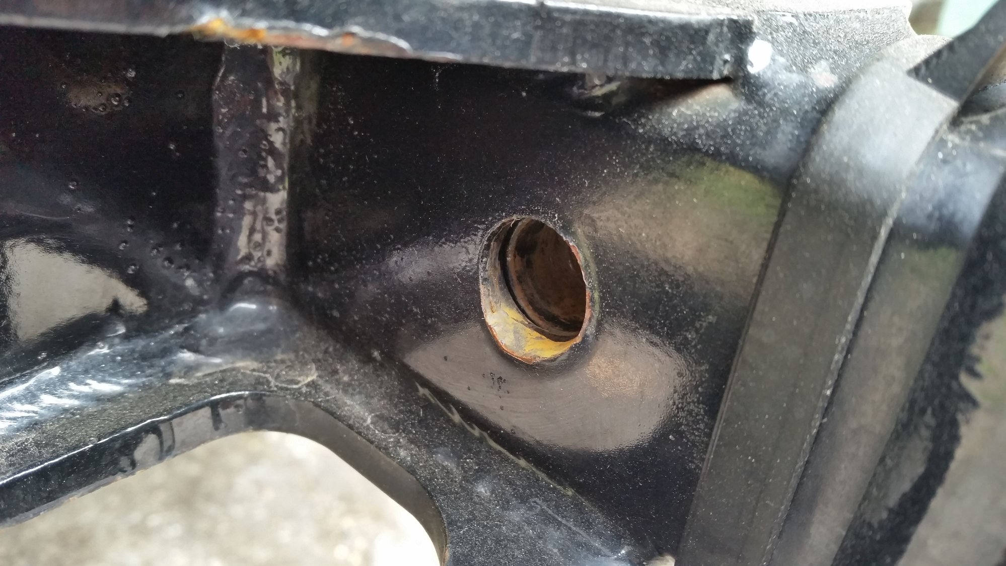

On our camping trip last week I noticed the hole for the hitch pin on my two year old Curt hitch was starting to get a little egged on the bottom. I'm pretty religious about not letting the bent end of the hitch pin get near the hole, but apparently it's time for some insurance.

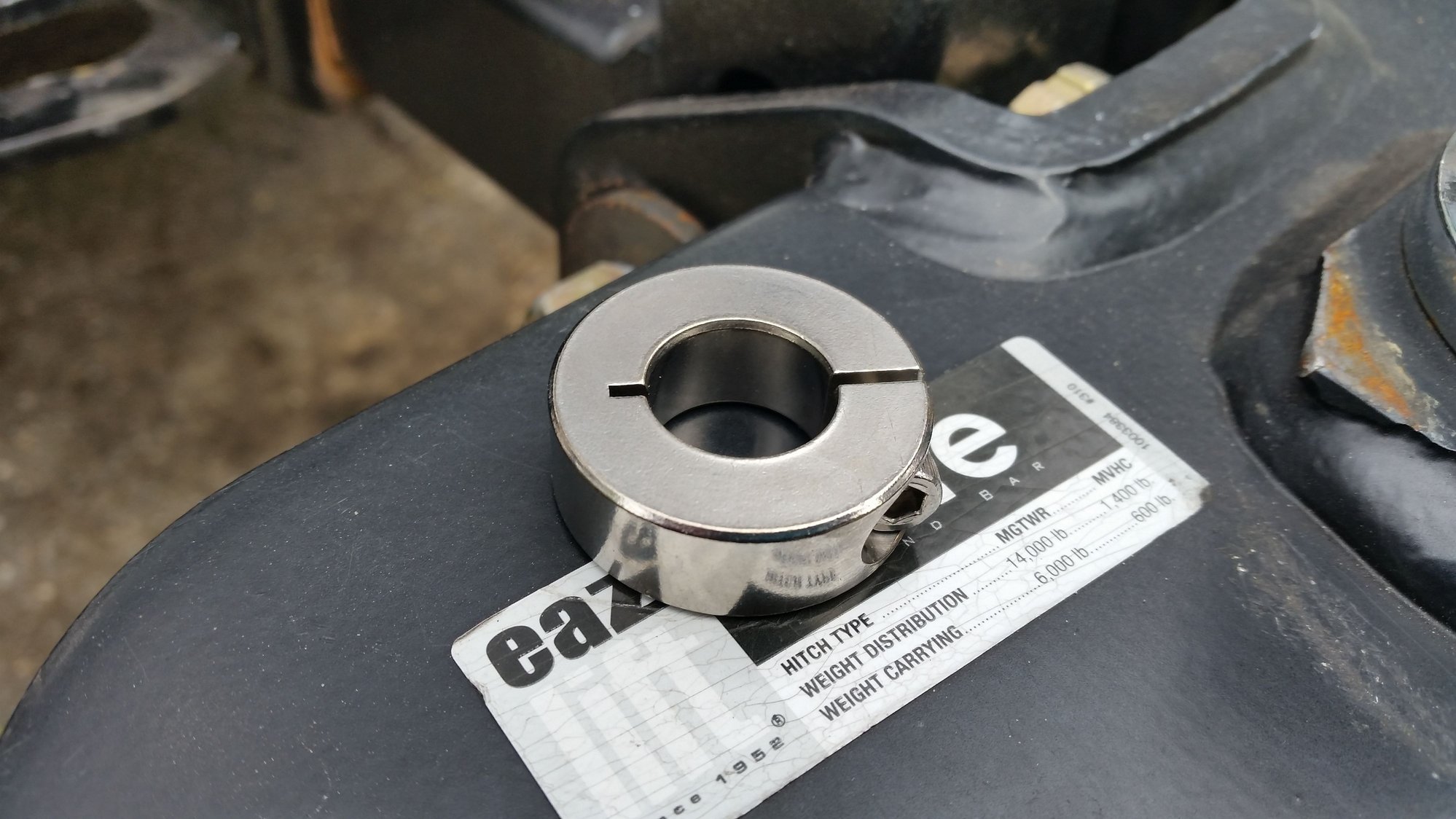

I ordered a stainless steel 5/8 clamping collar from Amazon.
https://www.amazon.com/gp/product/B0...?ie=UTF8&psc=1

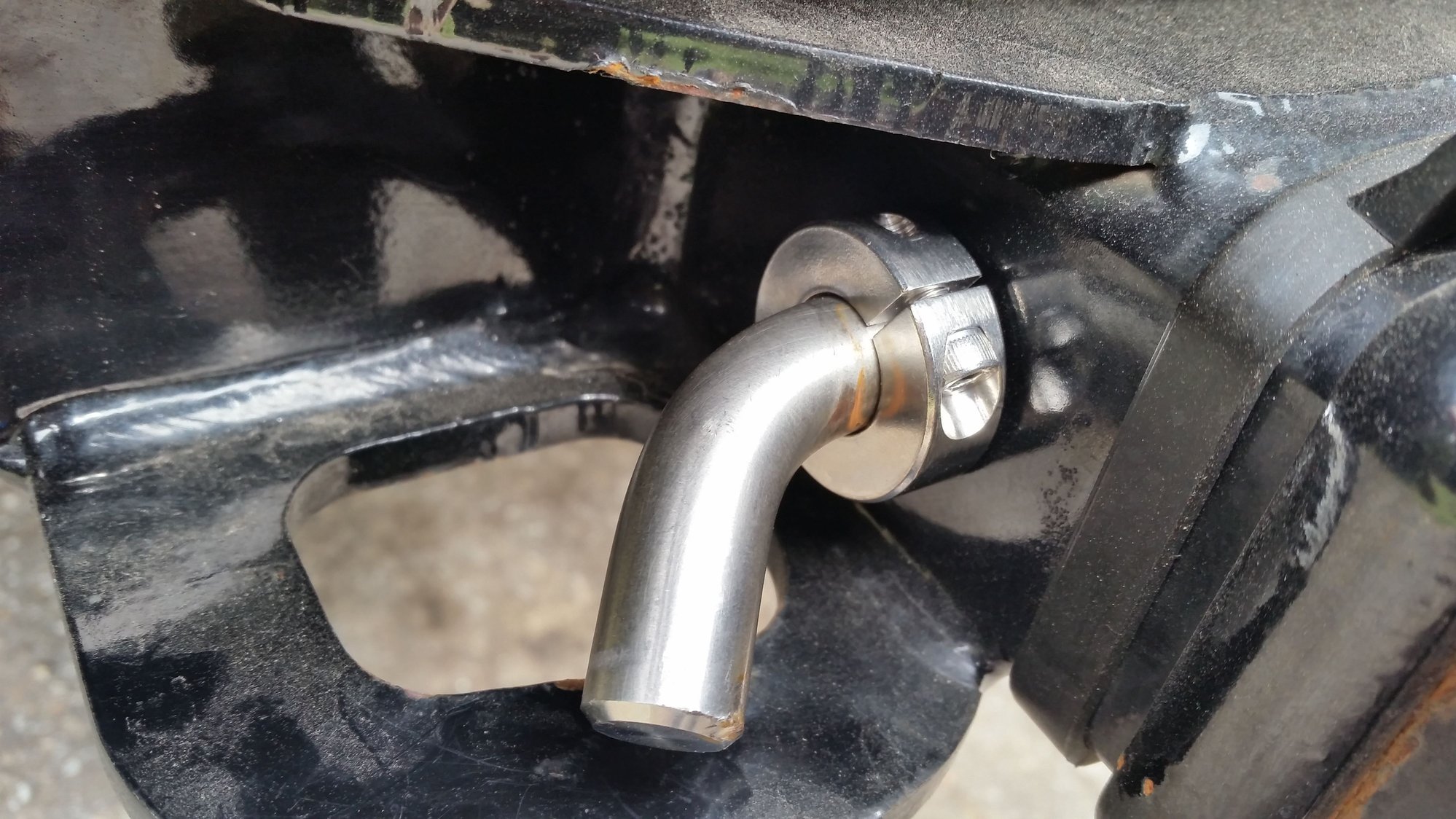

Installed it on the hitch pin and tightened the bolt. This should keep the bent end of the pin from egging the hole anymore.
Just an added note.... I absolutely love my Bolt brand locking hitch pin. I have a couple of their hitch pins and a couple of their padlocks, keyed to my Excursion. One padlock on my trailer coupler, one for a cable to lock the generator, bicycles, etc. I never have to look for extra keys.

wow.. that shouldn't happen.
Would one of those anti rattle clamps help?
https://www.amazon.com/OxGord-Hitch-...i+rattle+clamp

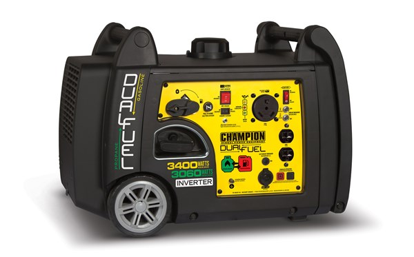

new generator for out Alaska trip next year...
3100W/3400W Dual Fuel Inverter Generator - Champion Power Equipment

We have the same one. So far so good just a bit bulky.
Edit: Actually think we have the 2800/3100. Is this the new model?

Unless you have a straight bar pin, it will always happen (eventually) with the bent bar pins without a clamp.
I have a straight bar on the Ex, so no clamp there, but for my truck I have the same pin lock as you do, and since they don't come in the straight pin style, I am continually checking the worm clamp to make sure it hasn't moved.
I like that clamp you found. Much better than a worm clamp. I'm gonna have to get one for my rig. Rep!

It was a little over $7 when I ordered it. I see now that they have sold out and raised the price to almost $10 .
