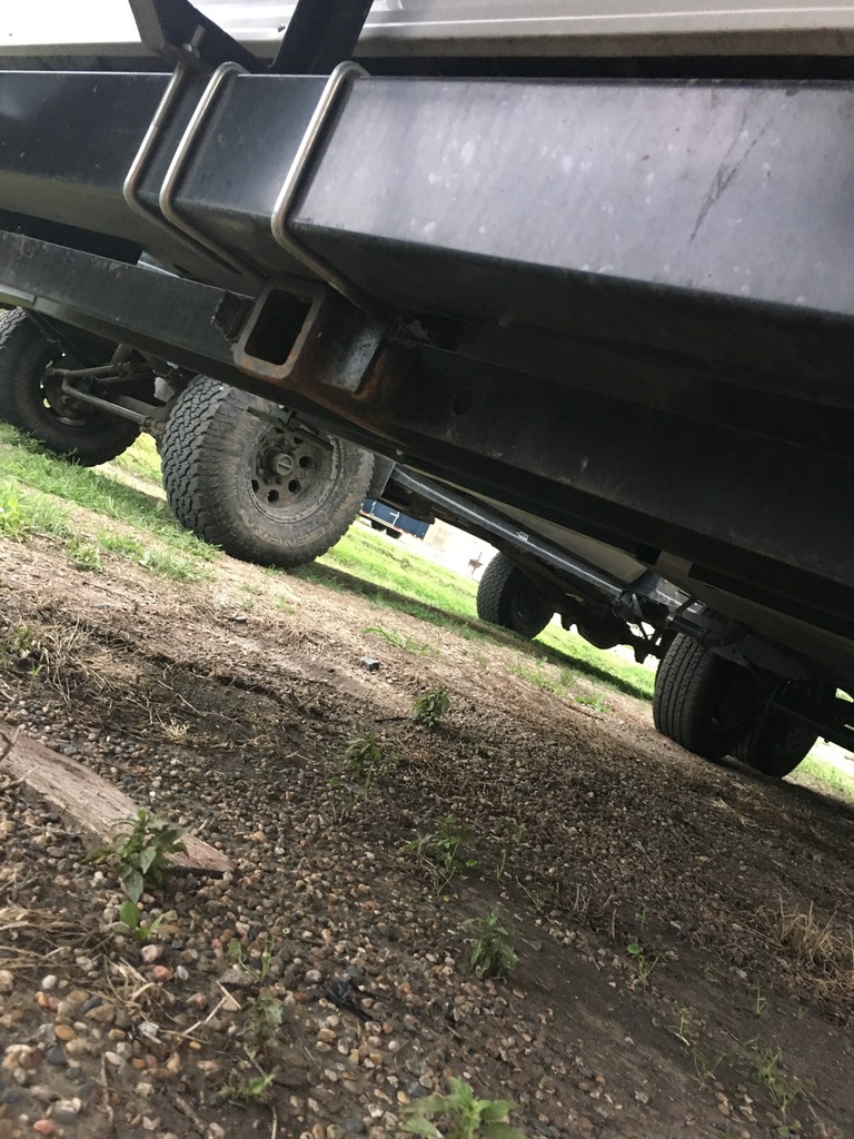

Hitch and storage. I got this covered.

Hitch is welded to bottom of bumper and thick strap up to frame. Also bolted to a bracket that would be used for manual jacks. Than u bolted to the middle of the bumper. The toolbox is unbolted to the bumper. Have had this setup for 2 yrs now, and pull a ATV trailer behind it. I've also put a basket back there to haul fire wood before because my generator goes on the tongue under the propane tanks.

I like the storage box on the back.

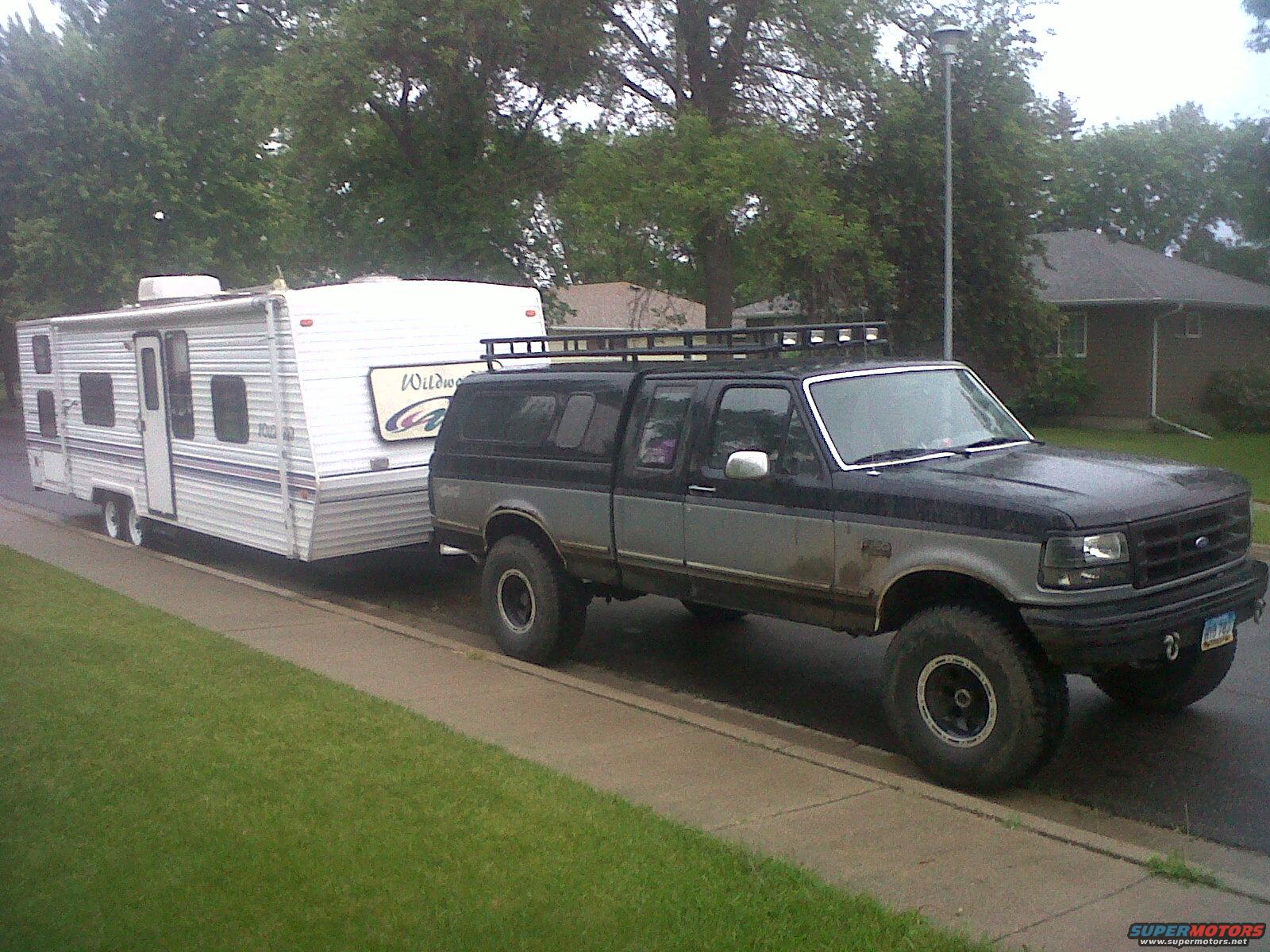

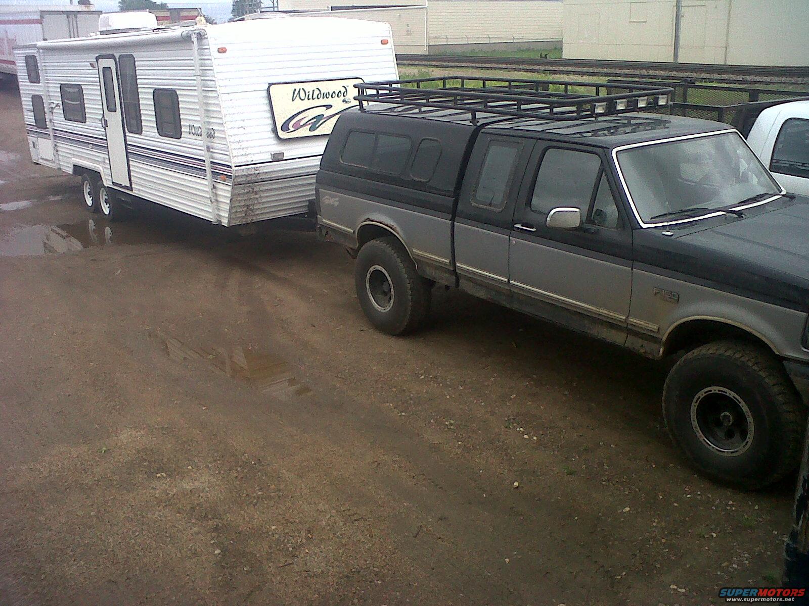

Originally Posted by devovino
Yeah that's what I meant tho say, I think it would lift the trailer up a for 3 or so inches, and that's about whst my excursion has, 3-4 inches, and my wdh is of a drop hitch. Also, I do plapla on adding some airbags soon to compensate for some squat, all those things together make sense.
The flip is easy as hell on a camper. I did it to my old one. Just buy some new spring perches to weld to the axle tube. Use a tape and square to make the new perches parallel with the old ones and weld them on. Bolt the axles back on. And done. The hight difference will be the thickness of the leaf pack and the axle tube.
Here's a b4 and after pic. Not the best pics but you can see the diff at the tire to fender clearance.

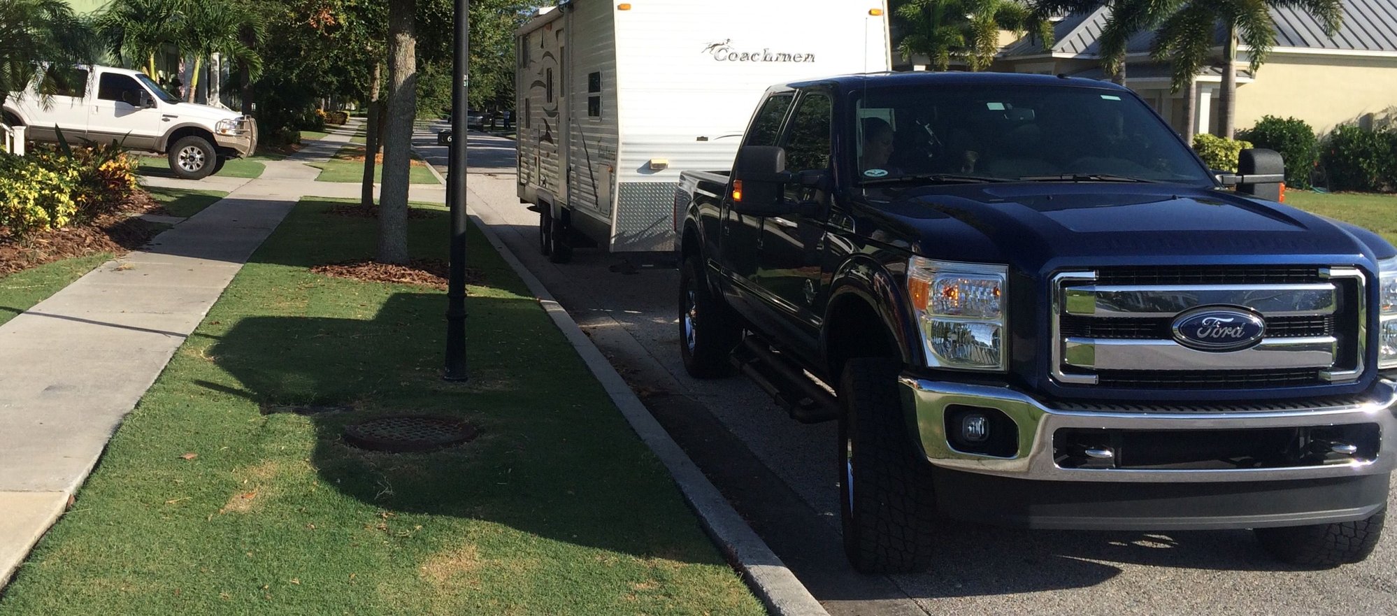

Kind of- I left the X in the driveway. We pulled the 32 footer to the Caverns State Park 5 1/2 hours away. Temps are 93-97 outside and the truck seemed better suited. However, caverns themselves were in the 60's and the blue hole swimming spring was mid to high 60's(takes your breath away after you do your best Ron Burgundy cannonball impression". Great trip so far.
