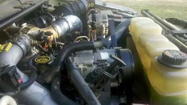

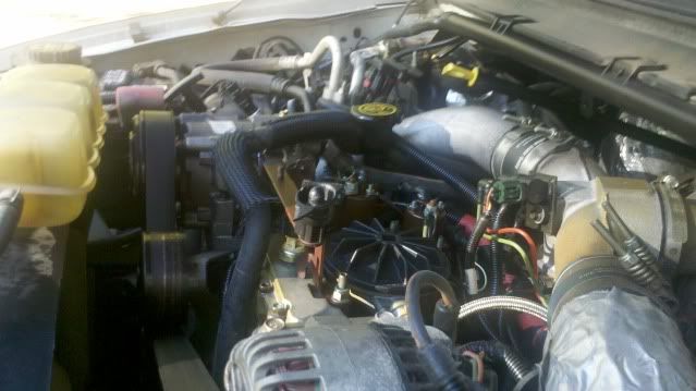

Pics of the engine compartment the morning after diesel blew out, back in Canada. I see where the HPOP reservoir is, and the fuel filter. The glow plug is on top. That's about all I know.
