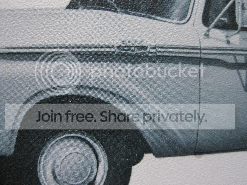

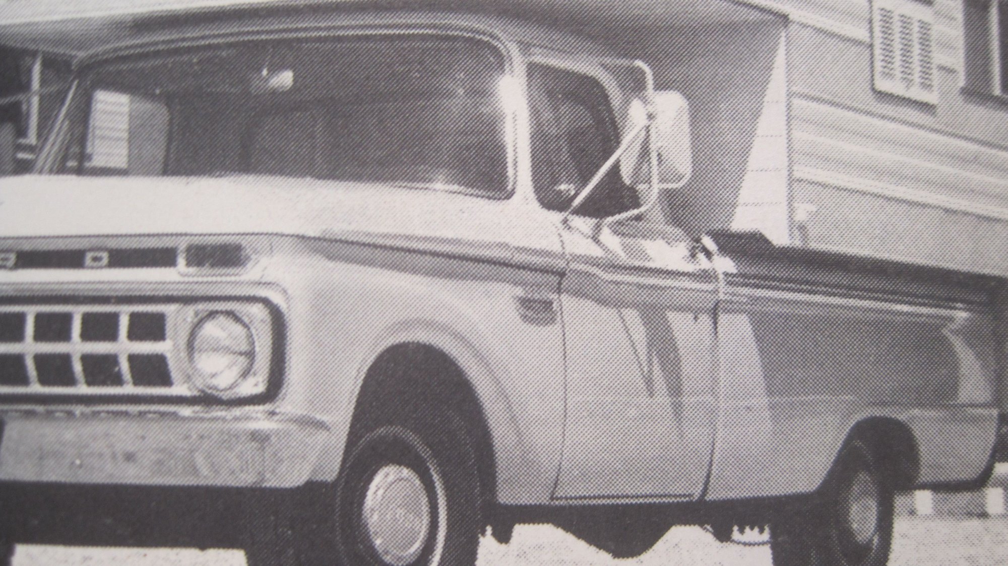

The Camper Special option alone may not be very rare on a '65 or a '66, but I would say it was very very rare on a '64. THe option came out late in the '64 model year and there is almost no literature available on it. Rare period photos with these Camper Special emblems. Emblem used on early '65 Camper Specials also.
