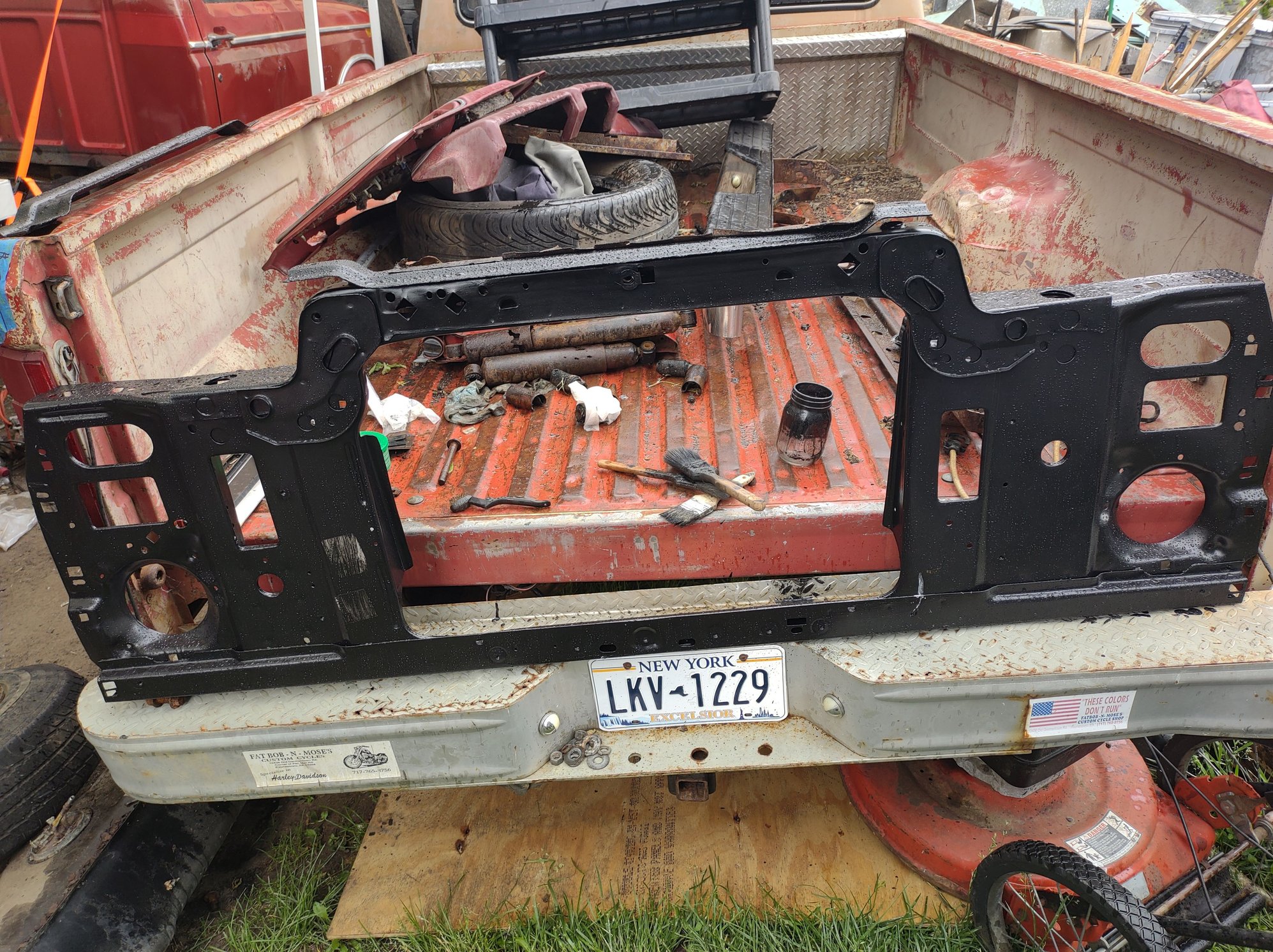

So the last few days have been quite busy... There aren't many pictures but my buddy and I have managed to check off a few items on the completion list...
Rear axle cleaned and painted.
Leaf Spring cleaned and painted, bushings replaced
Complete Rear brake job: Drums, Shoes, Hardware, Cylinders, Hard Lines, Hose and "E" Brake Cables all replaced
Frame Work: New Rear Spring Hangers, Shock Tower Installed, Crossmembers painted and installed ( I ended up using the old diagonal brace from the passenger side for the fuel tank hanger and put the "bad" one on the passenger side).
New brake line from the Porp valve to the hose
Rear Fuel Tank repaired and painted, rear tank straps (upper & lower) painted. Will be installed this weekend.
Old core support removed, new core support painted. Frame area under support encapsulated. New support will be installed this weekend as the mounting hardware will arrive today along with the battery tray.
Front "E" Brake cable installed
Remount axle to to frame. Truck is now sitting on the axle again. Still need to flush the pumpkin.
Gauge Cluster: Repaired the circuit trace and cleaned & applied di-electric grease to all electrical connections.

Rear Fuel Tank
Painted Core Support

Core Support Note: The old support is out of the truck but I needed to repair the crossmember that sits under it. Someone hooked a chain or something to pull it out of something and twisted it all to hell. Once I straightened it out I encapsulated it... I'll reinstall it once I get the valve cover bolt fixed as it is easier to get to it with the support out of the way.

So the last couple of days have been very productive.
Items that have been checked off the list...
Rear diff flush and fill: CHECK I'm actually glad I opened the rear diff as it had a fair amount of water in it and there was a coating of rust on some of the mounting hardware and rust sludge that came out of the tubes. There was so much that I think I'm going to do this again during the 2nd phase of this job.
Valve Cover bolt repaired. I reluctantly used a "Helicoil" as the bolt would not come out at all
Trans cooler line repair. I ended up just using a rubber hose for now and will replace the lines during the 2nd phase.
Core Support and Radiator installed
Battery Tray Replaced.
