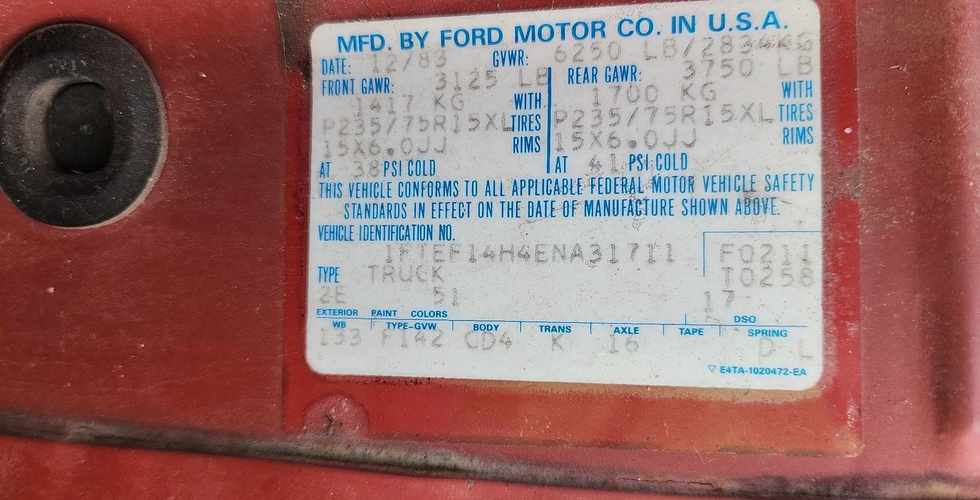

It's in my sig Dave...
1984 Ford F-150 4x4 Long Bed 351W Vin Code "H" C6 Trans

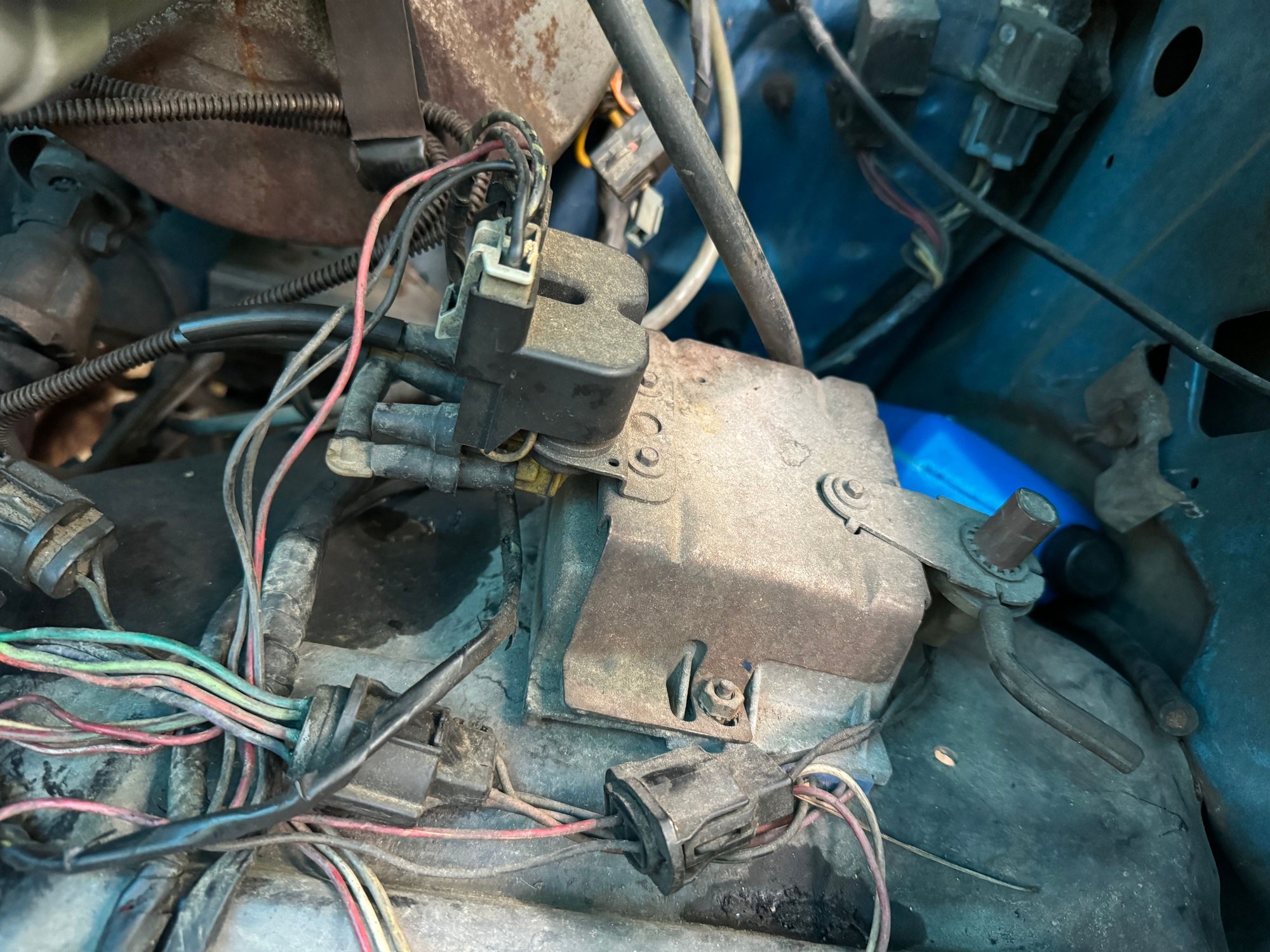

My truck has (had) this same bracket. All the emissions stuff was hacked out before I got it, so this is how it looked when the truck came to me:
But same as yours, mine is a 351w 4x4 C6. Since this didn’t seem to go to anything I pulled it off. I’m definitely interested in finding out what it was for.

If it had vacuum lines going to them as it looks to have, then they should be on the vacuum line routing sticker on the radiator support.
It will not say the full name but have 2 but most likely 3 letters ie: EVC Egr Vacuum Control (just made up)
Once we know that the letters are we can then tell you what they are and maybe what they did.

Unfortunately that sticker was damaged but is mostly readable. IF I'm reading the diagram correctly, it looks like the 2 valves / switches would be 2 "SOL V" & 1 "VCS".
The only things that have vacuum connected, that I can tell, are the Dist, Cruise Control, HVAC, Brake Booster and a line that goes to the trans. There is no PCV, EGR or anything going to the exhaust.
