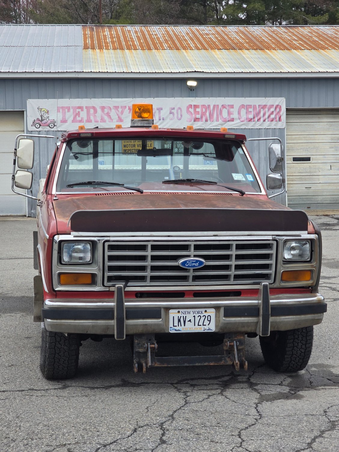

Does that windshield visor have lights in it? Looks like it. Pretty slick if so. The whole truck is cool. Happy to see you’re still making progress.
Yes they are Yellow/White LED flashers that I will most likely remove because they weren't available till the 2000's and don't fit the era.I did test them and they do work. Besides white flashing lights are not legal in NY for civi vehicles and I don't need the headache.

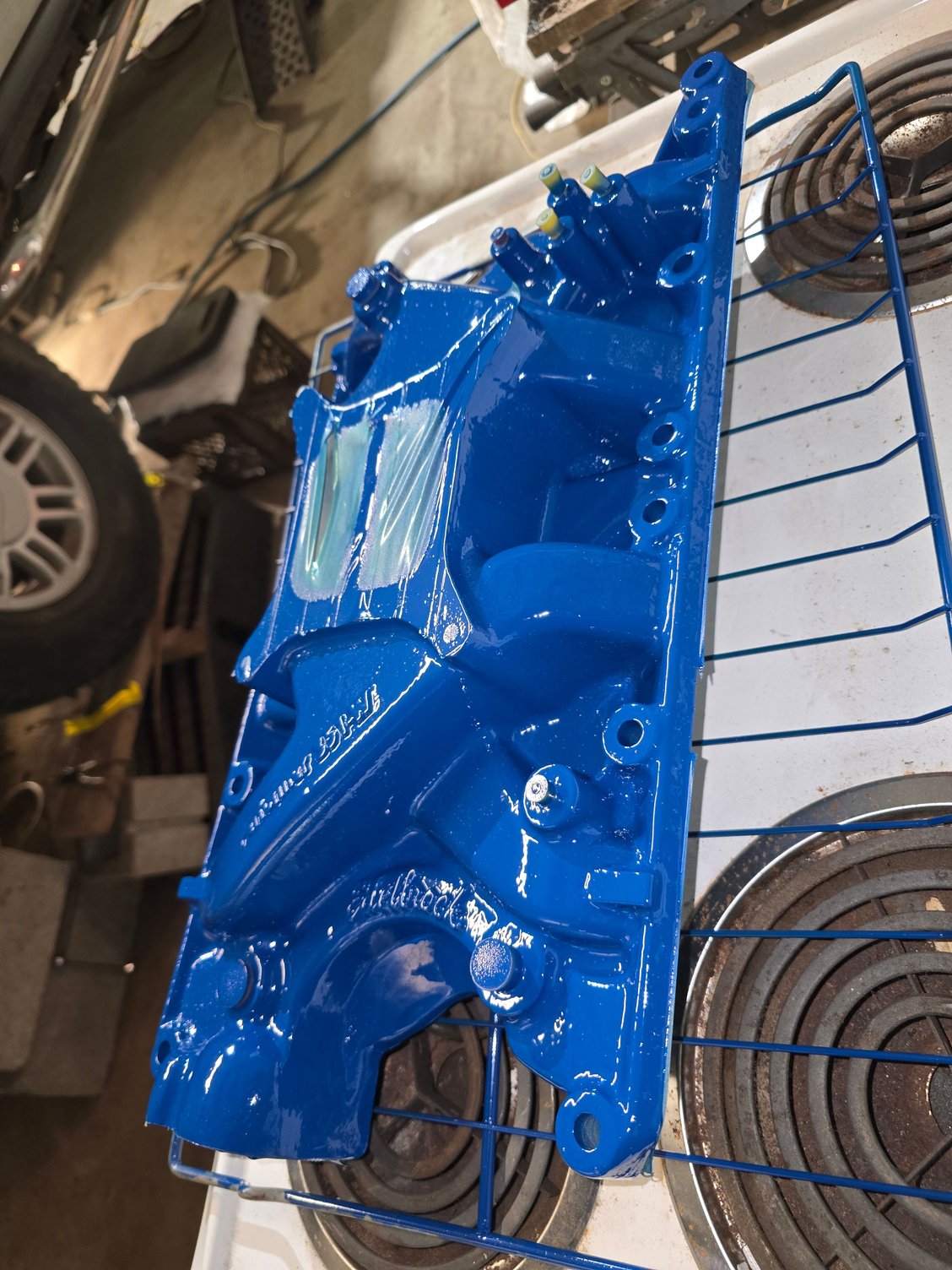

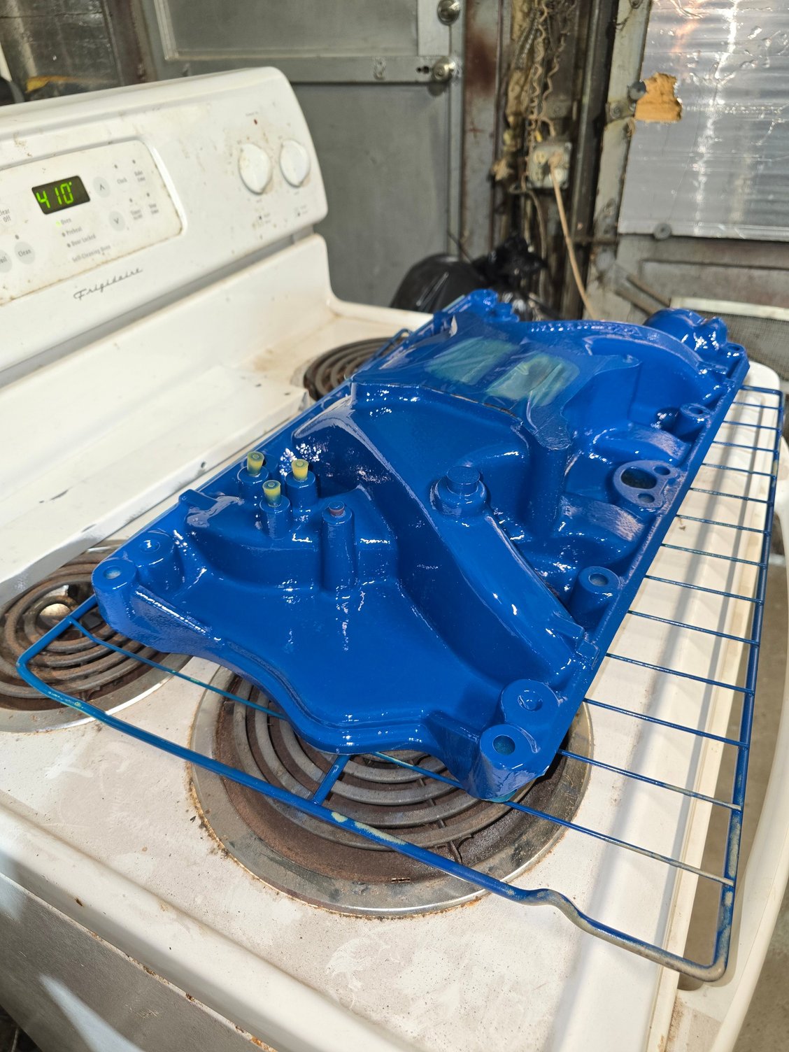

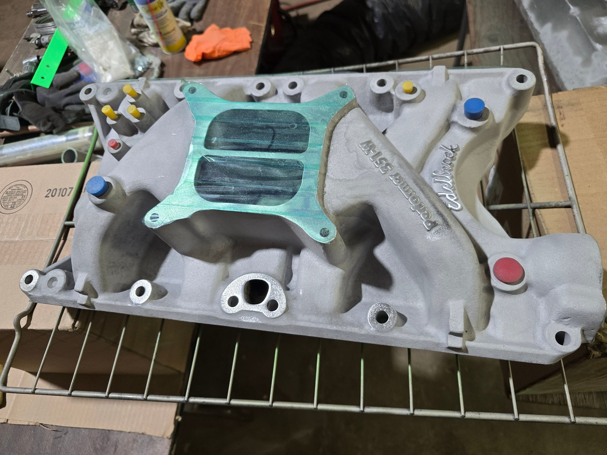

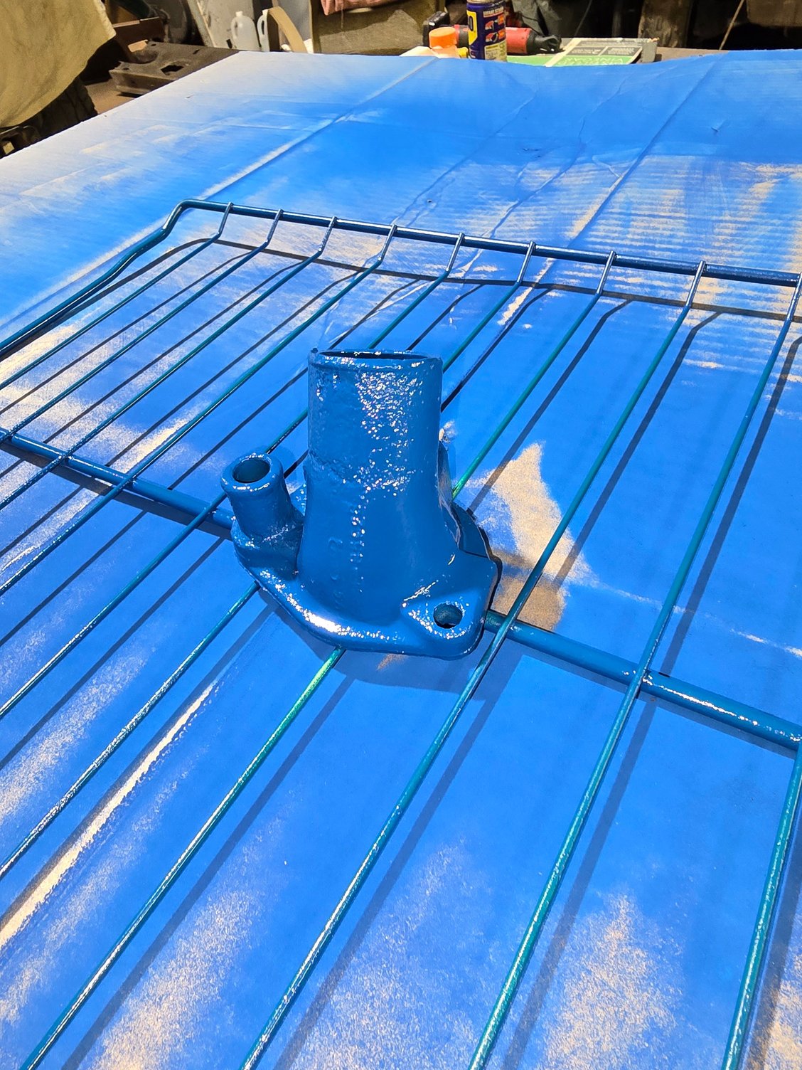

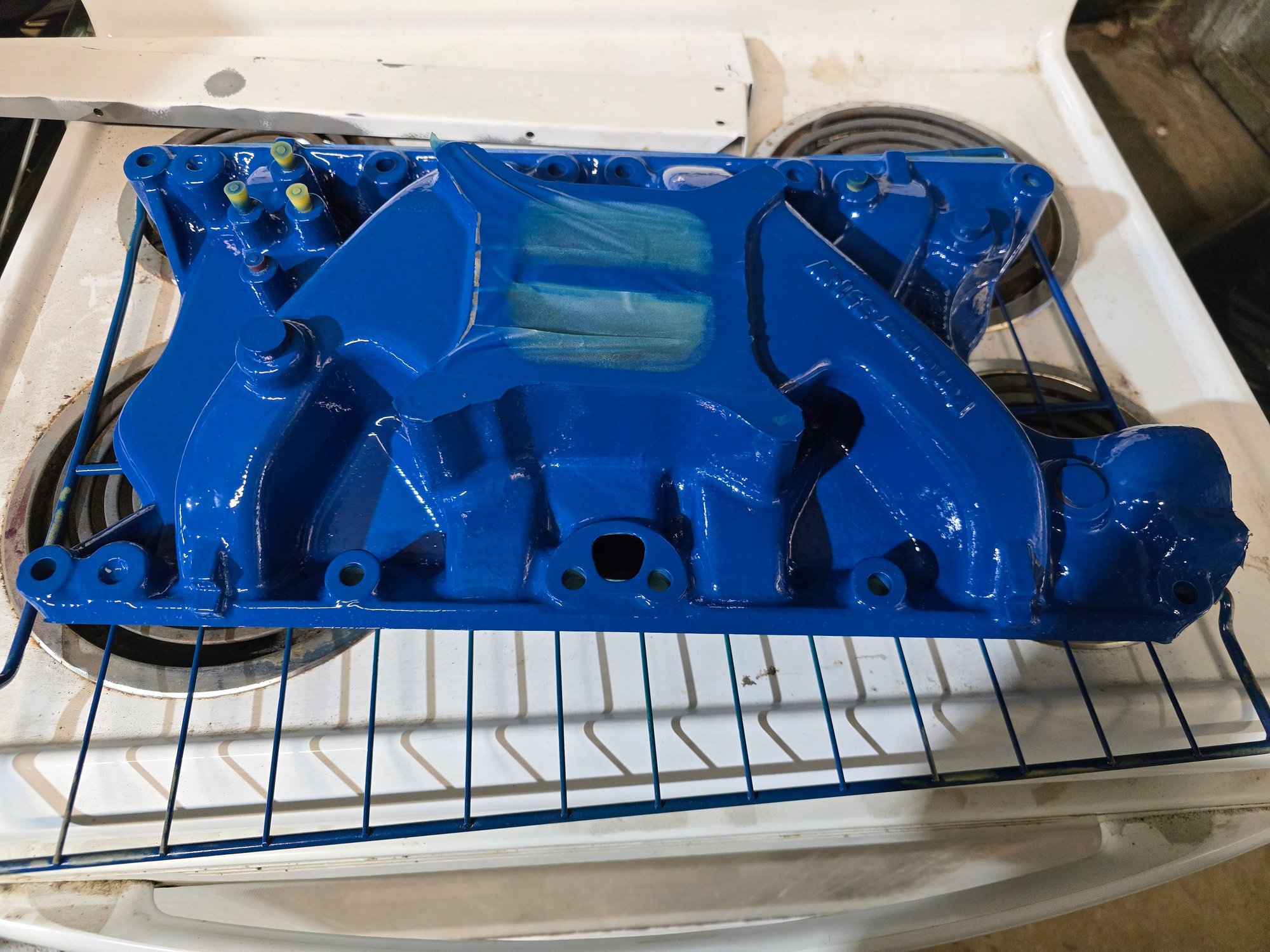

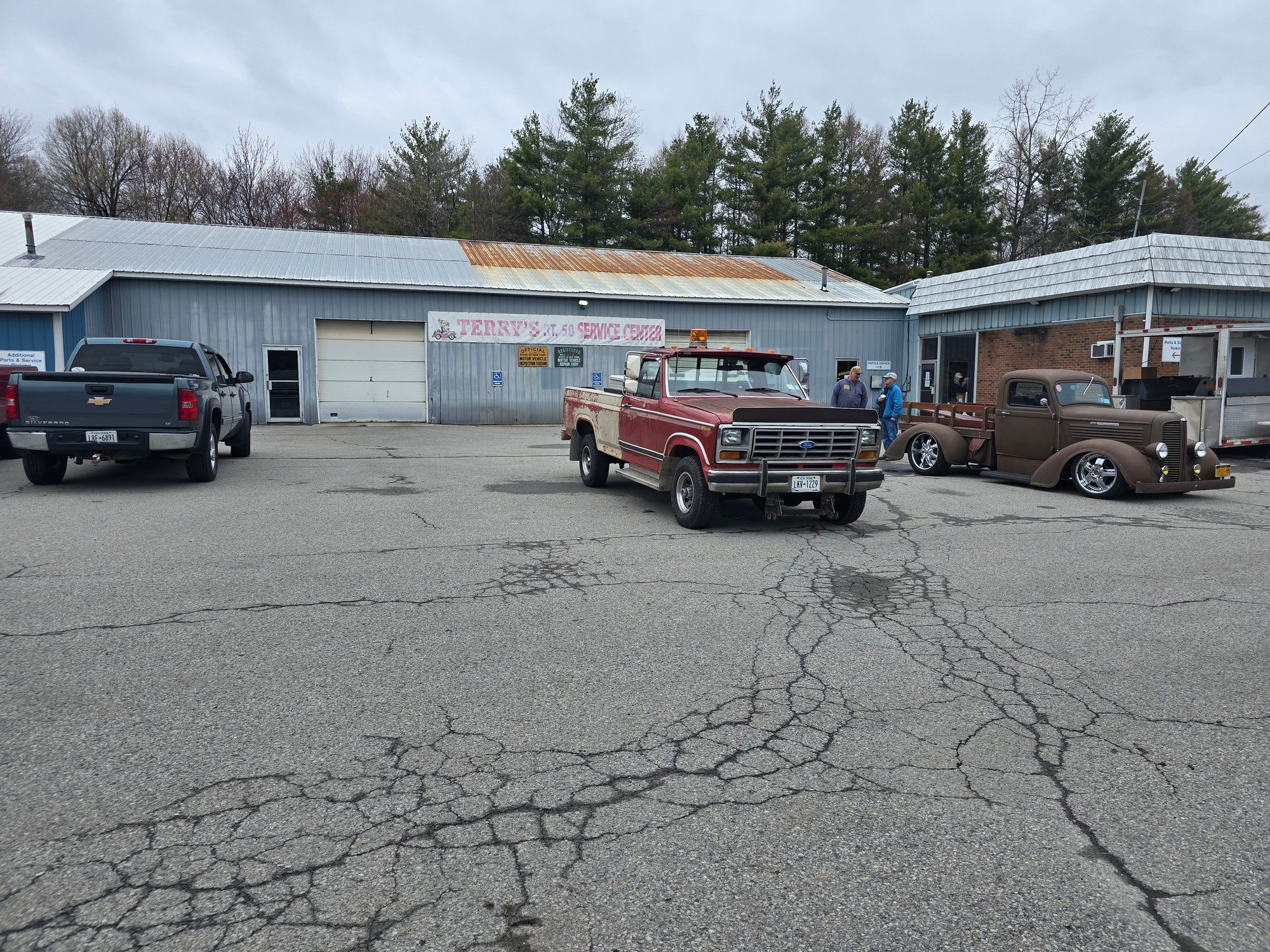

So the last couple of weeks have been very slow and not a lot has been completed as I've been busy with work. I did manage to locate the primary source of the oil leak. All along I had been thinking it was the rear main seal and the passenger side valve cover gasket (I still need to drill out and fix the broken bolt, it currently has a helicoil that didn't seat correctly) but, now that the truck is being driven more, I've been seeing more oil in other spots on the engine. The oil pressure valve in the oil pump is stuck or not opening and closing properly and oil is bubbling out of the breather on the valve cover and the dipstick. So at this point when I pull the motor, I will be replacing the pump and cleaning the pickup tube. The local machine shop is going to get the heads for hot tanking and properly fixing that broken bolt.
I think I found that noise I was chasing. I believe it's coming from the transfer case but I haven't gotten under the truck to check the oil level yet.
This weekend I did finish the intake manifold. I decided to powdercoat it and it came out great, the water neck didn't turn out as well as I had hoped but it still looks good. I still need to do a little bit of cleanup on the intake. I also took Red to a swap meet / car display show on Sunday. No prizes were awarded to any of the shown vehicles but I did have a good time.
As per usual, here are the latest batch of photos.
