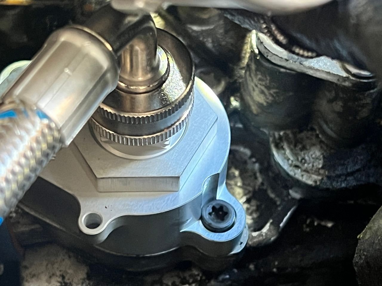

Got an email that the white truck was going to deliver my Red ELC from Rockauto. This was the last of the pieces that I needed to have in hand before doing a cooler back flush. I have a new cooler to install, but figured I'd give this a try first.
  • Removed the hot side CAC tube easily and installed the FixUr6 adapter. The O-ring on the original was pretty messed up. Taking out the T27's wasn't much of an issue. But putting them back on was a PITA, specifically the rear one. If the turbo comes out, then its easy-peazy. Reinstalled the CAC tube after attaching the water hose. *
  • Opened the petcock and drained out about 4.5 gallons of coolant. Unfortunately, I used a dirty tub to collect the coolant and couldn't check to see if there were any sediments.
  • Ran tap water through the oil cooler for about 15 min. I don't have a good shop air compressor. I tried using my ViAir 400P compressor, but that wasn't any help.
  • Removed the 8mm Allen on the Driver side block and continued to run tap water for another 15-20 mins.
  • Continued the same now with engine running for about 20 mins.
  • Shut engine, and water. Allowed all the tap water to drain.
  • Put the block plug back. Closed the cooler outlet and removed the hose. Tightened the petcock, but guess I was just too strong for the 19 year old plastic* Went over to Advance Auto and got a replacement Dorman petcock (Part#61127) and installed it.
  • Poured 2 qts of VC-9 into the degas and filled it up with tap water to the min line. Took the Ex out for ~30 min and drove at various speeds. The delta was still ~24 deg. Came home and allowed it to cool down for about 45 mins.
  • Drained the radiator as well as driver side engine block once more.
  • Went through 3 more rounds of flushing with distilled water.
* See pics
