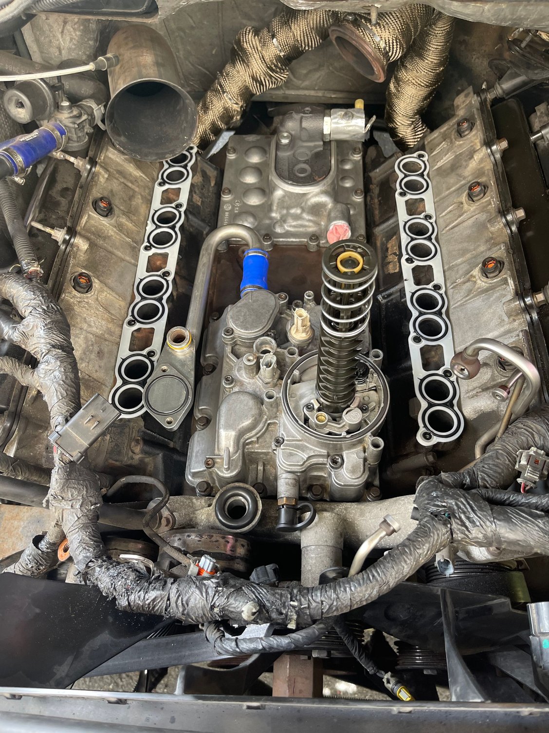

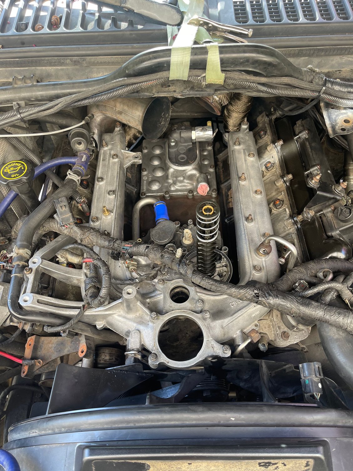

Heads came back from machine shop yesterday. Reassembly has started. How do I confirm that EGR has been deleted?
Old May 2, 2024 | 09:29 PM
  #75
Baylinerchuck's Avatar
Baylinerchuck
Joined: Dec 2021
Posts: 2,374
Likes: 992
From: Chambersburg, PA
That J looking pipe is the part that deletes the EGR. It routes the coolant from the oil cooler back the manifold and blocks the exhaust inlet on the intake. This pipe goes in place of the EGR cooler. The only thing left to check would be the up pipe on the passenger side. It would either be replaced with a straight pipe or the EGR cooler inlet would be welded or capped off.
