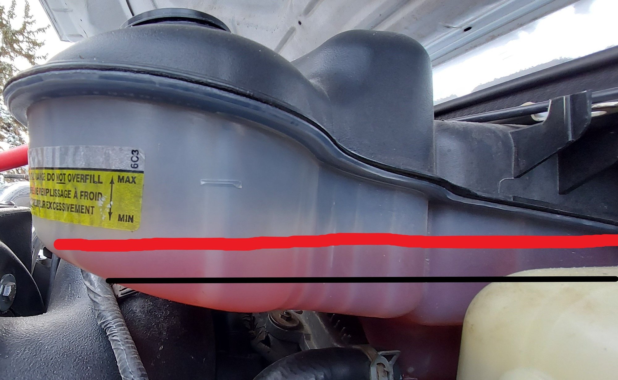

What "gasket" needed replacement btw and your degas bottle is overfilled. Between the red line and black line is optimal for our engines.
Also curious why you went with bolts instead of studs?
I am not exactly sure which gasket he meant. Will ask him and update. I will also check and reduce the coolant. Thanks for catching this. I have been traveling quite a bit for the past few weeks for work and personal stuff. Ordered the ARP studs which he says were the wrong kind. He called me while I was in the mountains of Rocky Mountains and I asked him to just get new OEM bolts from the Ford dealer. I am not convinced he's right as I got him the ARP 250-4202 through the Walmart portal. But, I am glad that the truck is back together
