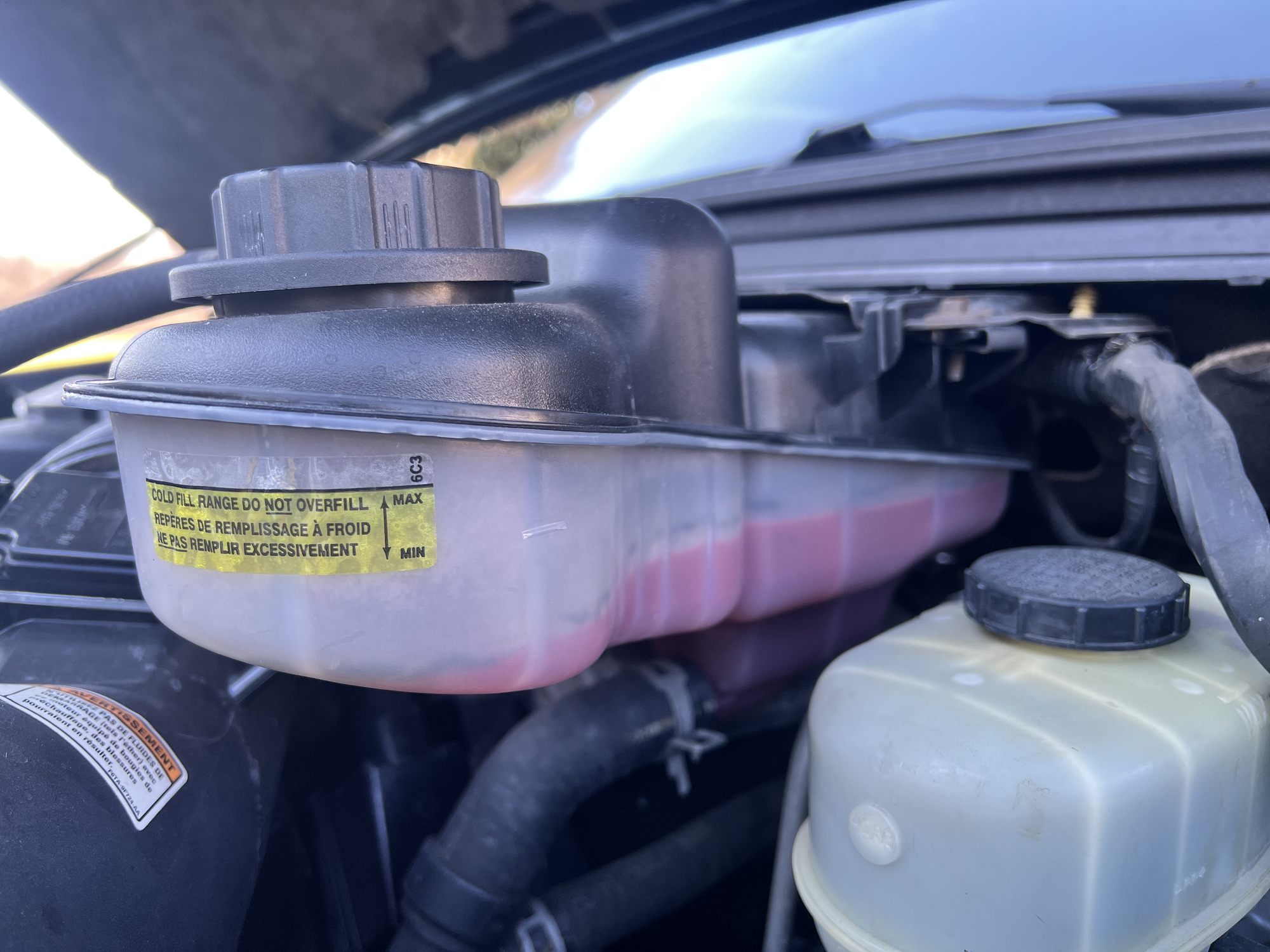

@Toreador Red @TooManyToys. Does this level of coolant look right? Picture was taken a few moments ago after sitting overnight (Parked at 6PM last night). Truck is running fine with ECT around 195 and Deltas maxing out at 12-14 deg. that drop within a minute of stopping to 4-5 deg.

That looks about the same as mine. I also run a pretty steady 10-12* delta when cruising on the highway. When towing heavy, my oil & coolant temps both go up, but they tend to run closer together.

Same as mine.

Thank you for confirming!!
