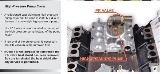

If you can manage to get a look at the HPOP we're all curious. Its under the turbo so pretty hard to see. In another thread a guy has a very similar build excursion with the throttle plate (04 engine) but the 05 HPOP. Which is good cause the 05 pump has been a LOT more durable.
04 Pump, you don't see the pump, just the connection for the IPR. Pic below is looking from the back of the engine forwards:
05 Pump, you can see the big oval top of the pump sticking out. This pic is looking at the front of the engine, looking backwards.

One observation/opinion - everything I have seen indicates that the 05 HPOP is what dictates an '05 engine (that and the number "5" stamped on the wavy oil rail end caps, and the "dividers" in the intake manifold EGR port). Looking over the list of changes for '05, clearly the HPOP and oil rails are the most critical of the updates. If the thread is the one that I believe you are referring to (the owner has an '05 Ex), I agree that that engine does have several '04 accessories in it (which IMO was done to use up spare inventory, but who knows for sure, lol). The E-series is an example of required mix-and-match to make the engine fit. All the E-series (04 and up) use the 04 front cover. As if the 6.0L isn't complicated enough .......
