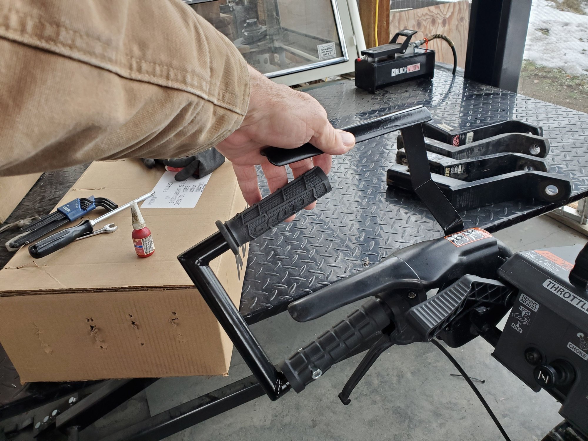

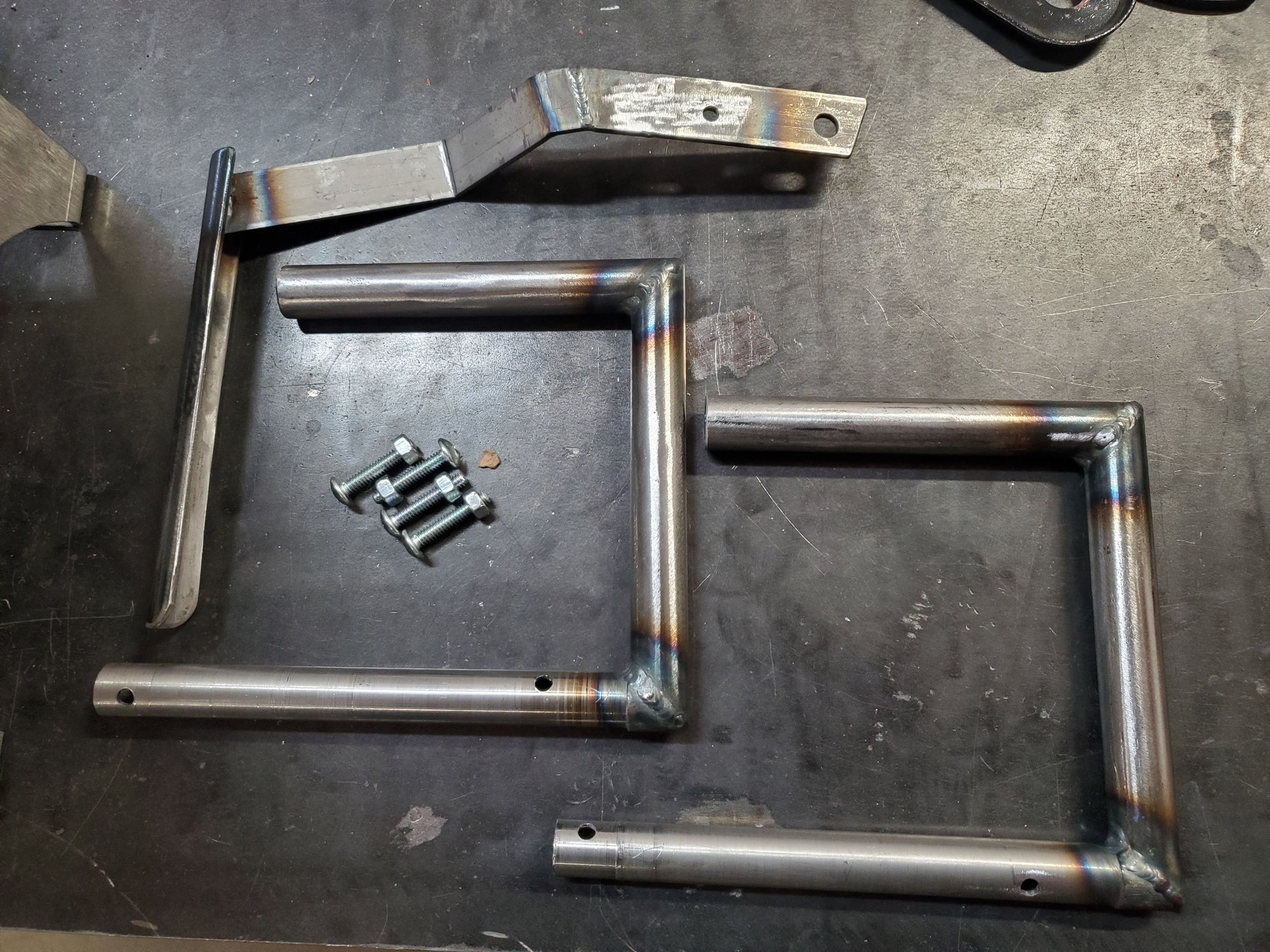

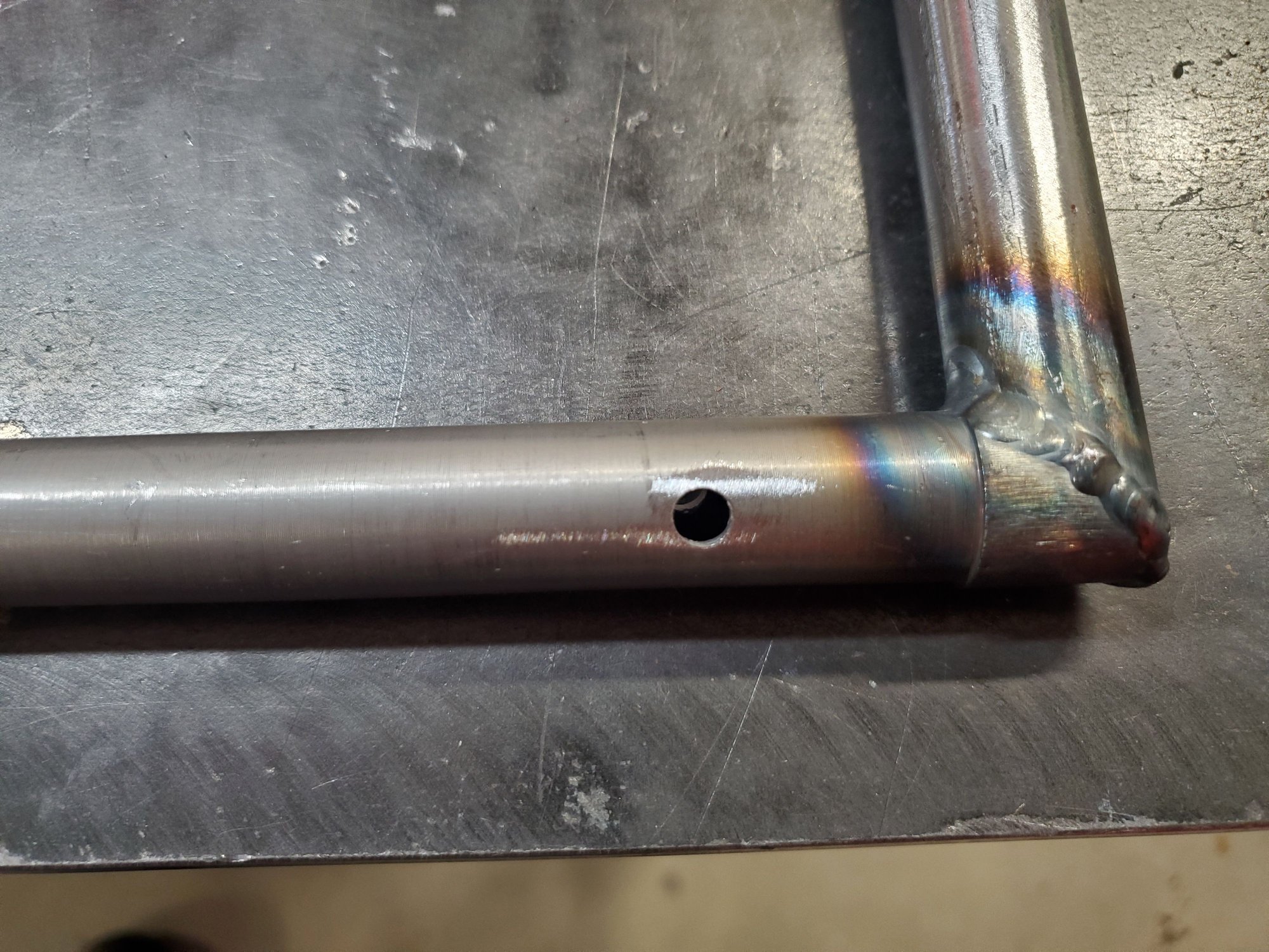

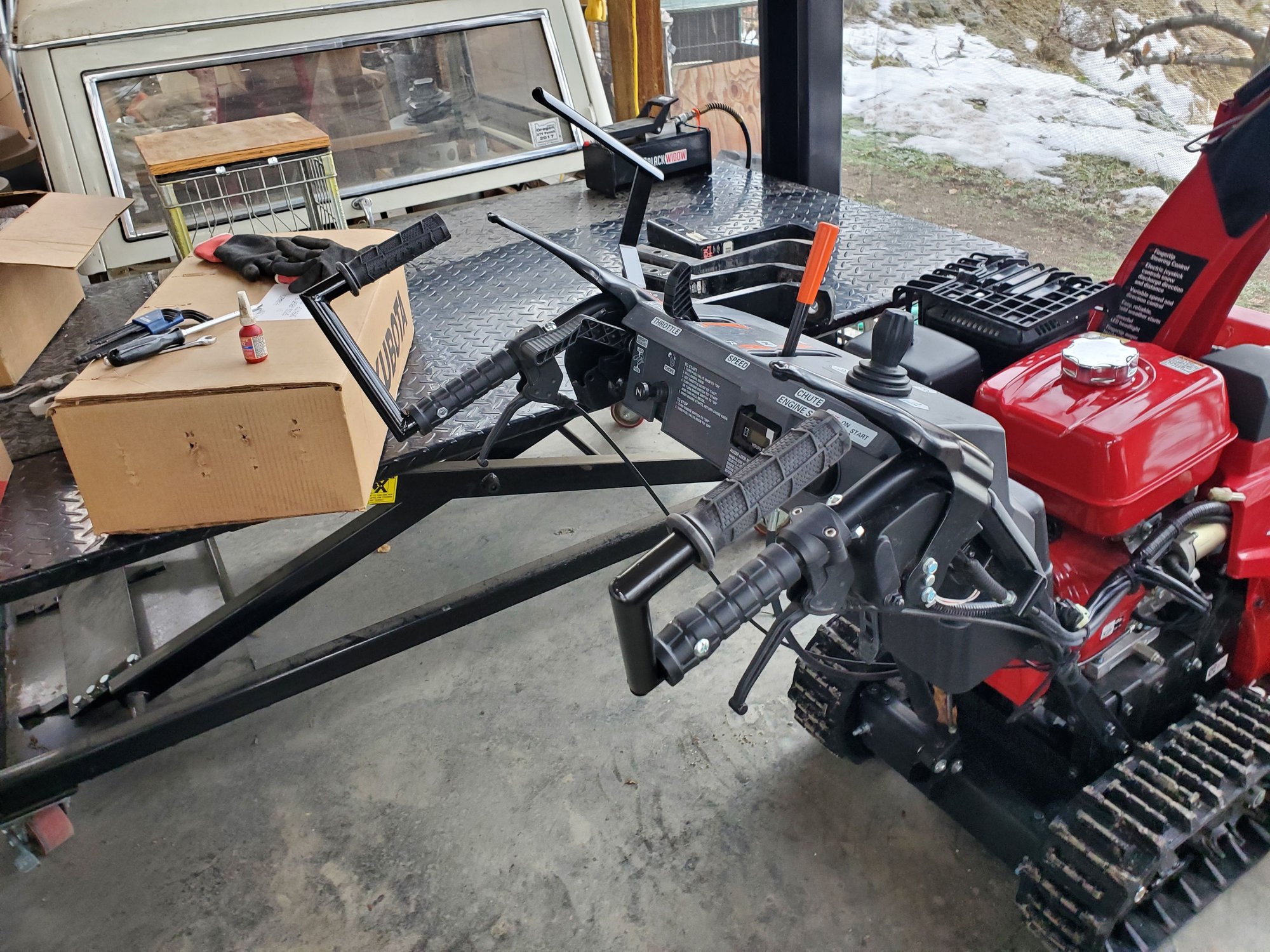

I modified the handles on snowblower this week. It's always been too low for me. Next mod is to figure out is how to move or extend the track release levers to the upper handles. This is not my design, I seen it on line somewhere but it wasn't as cut and dry as it sounded, I think there is a difference in machines. The original design called for 1/2" schedule 40 pipe, my handle bars where too thick. I went with 1/2" schedule 80 and turned them down on my lathe to fit the inside of my bars. I also changed the lever extension to my design.
I think I will cut out the original grips for the screw heads!

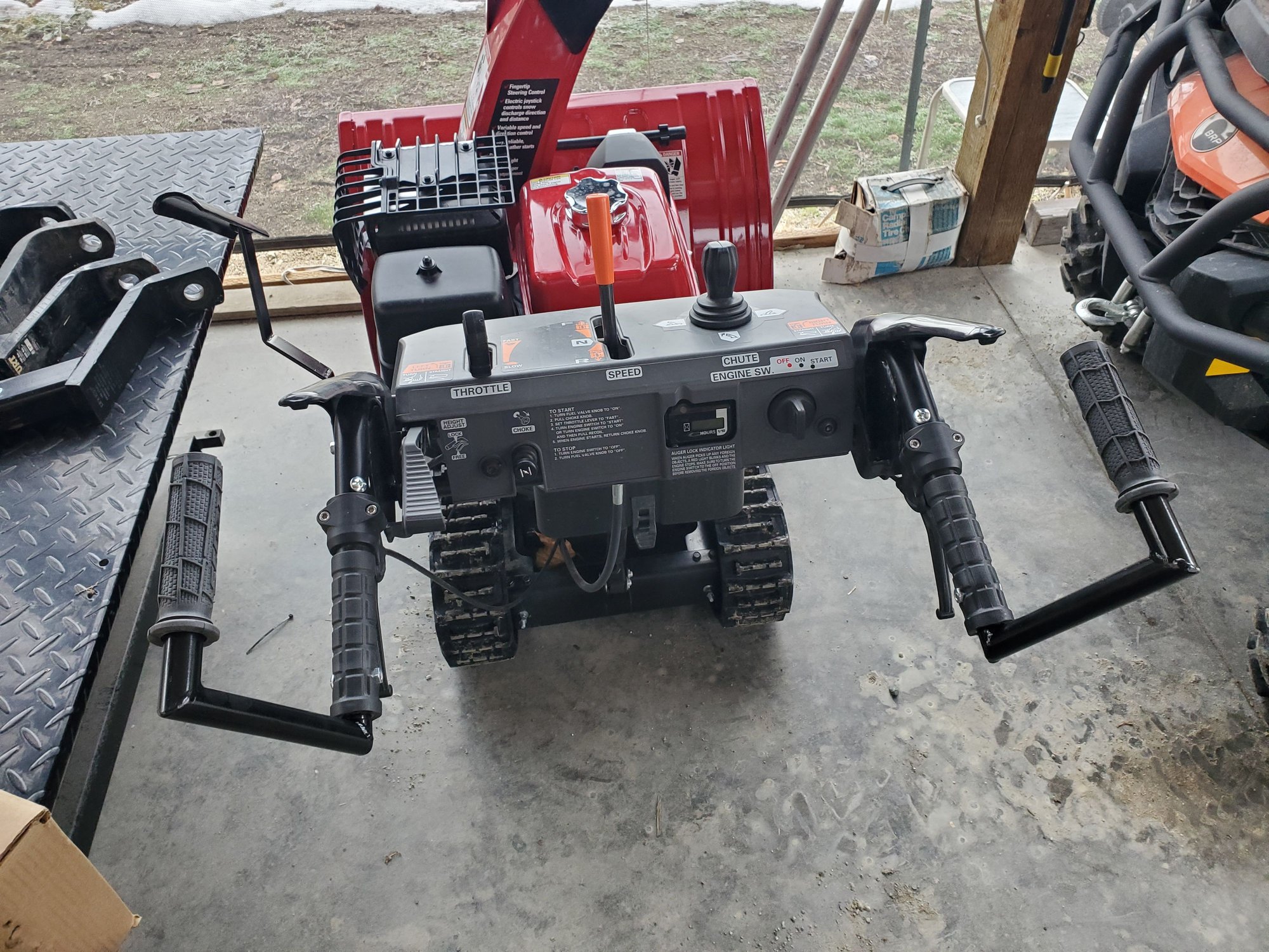

[size=16px]My new snowblower handles sure made a difference, they worked extremely well. I hacked up a couple of wire extentions for the steering levers, they worked, that's about all I can say. I'm not sure I can 3D print something that will hold up. I'm thinking of just printing a little beefier mound (the orange thing) and making the actual pull handle out of aluminum.[/size]

Tim...great job on the mods for the Honda...that was my only complaint about the machine...handle bars too low.
