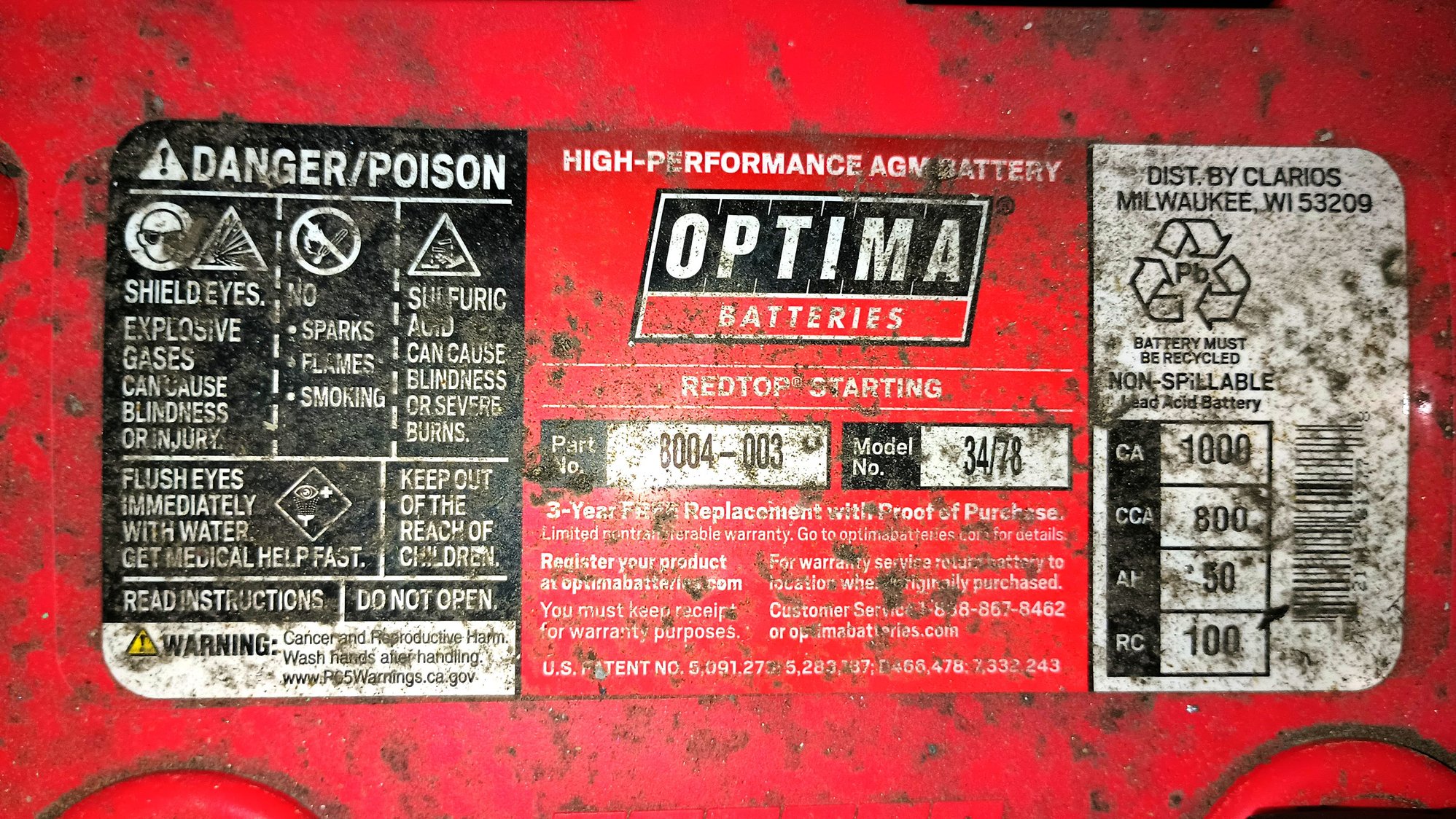

I got the truck back from the body shop. The battery was dead. It jump starts. But once you turn the truck off, it won't start again without a jump. I took the battery out, and the battery charger shows that the battery is charging to full. Now let's see if the battery will hold the charge. I have to unplug the charger, and let it sit overnight. Then measure the voltage. I've seen this before. Batteries will take a charge, but not hold the charge. Very disappointing. This battery lasted about 20 months.

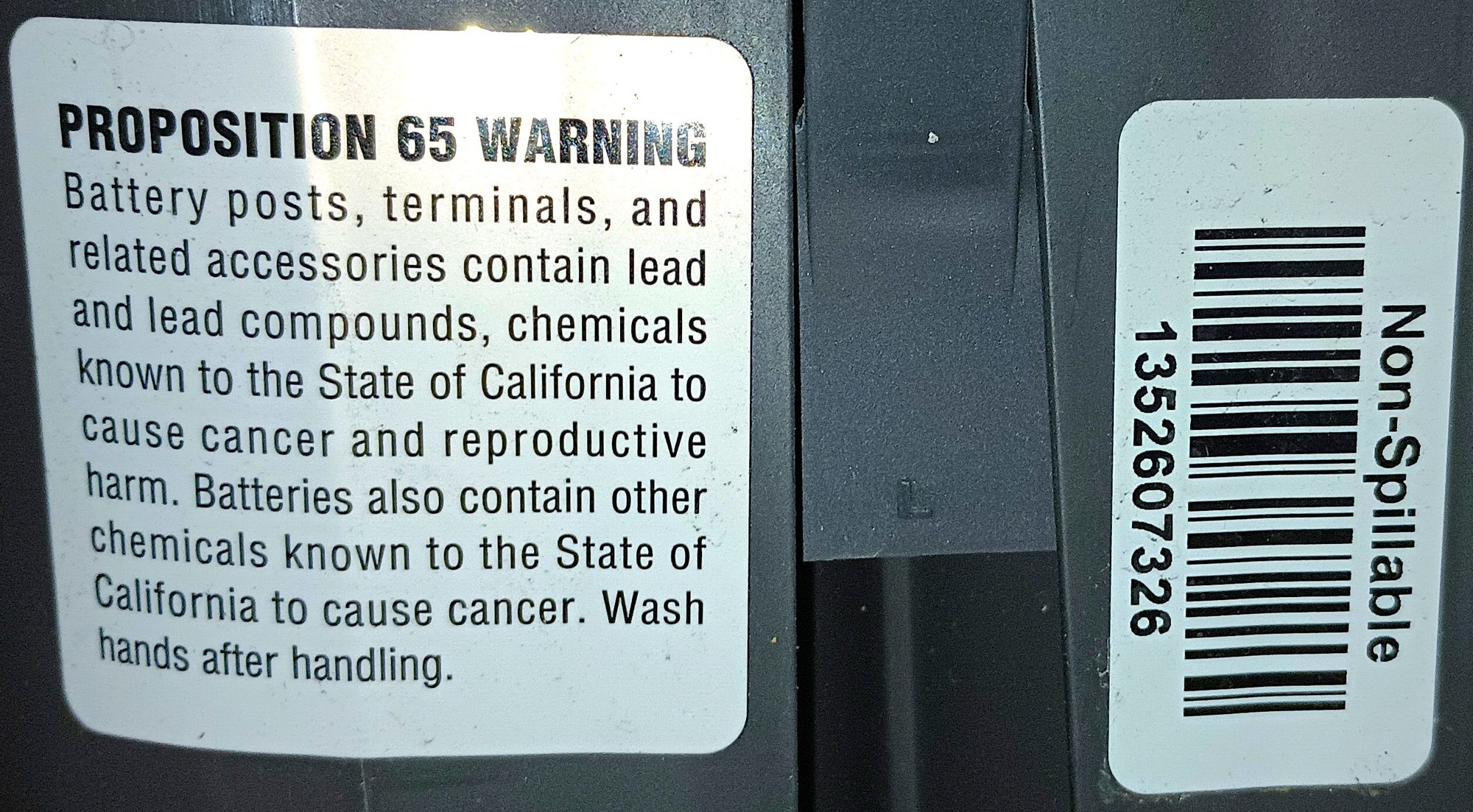

Here is what I learned. Typically, the battery seller is supposed to test the battery to determine that the battery is bad. On every Optima battery, there is a barcode sticker on the side. It indicates who sold the battery. Optima batteries are sold by auto parts stores, battery stores, etc. And they all have their own unique bar code. If that retailer did not sell the battery, they will not even touch it. If the retailer sold the battery, then it's up to them to honor the warranty. If you did not buy it from that retailer, they will not honor the warranty. If like me, you have a battery that you bought online, no retailer will help you. And Optima does not have their own Optima outlets. So you can't go to an Optima shop. Not even the local Optima distributor will help.

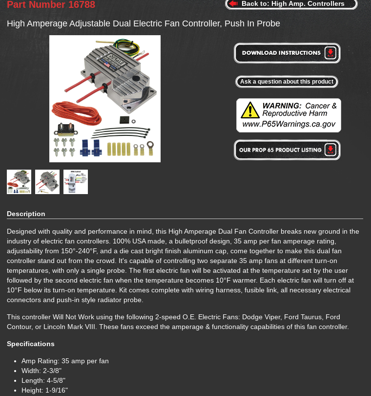

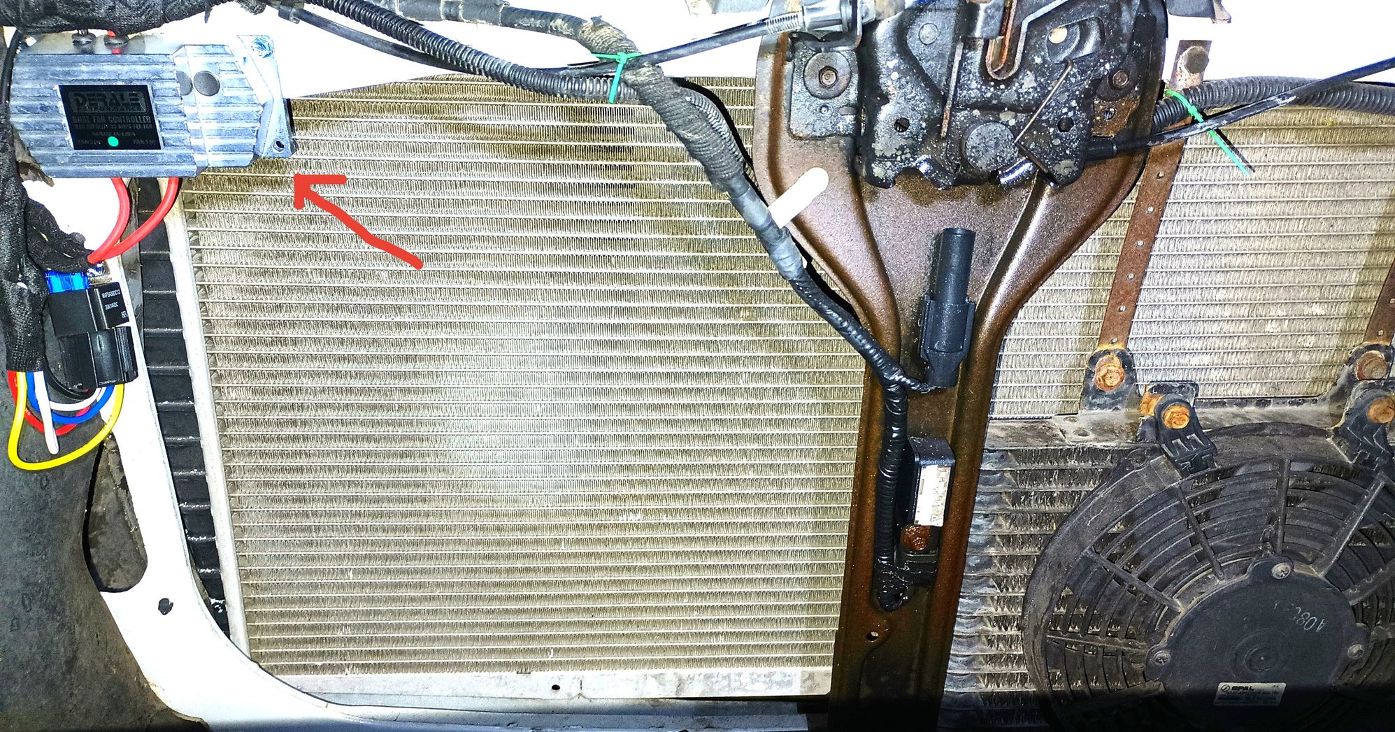

Since I had to replace the battery, I decided to take care of a few other deferred projects under the hood. I installed a new fan control unit for the electric fan. It was just time. The old style controllers had relays and the new style is a solid state device. I also installed a relay onto the transmission cooler fan. It also gave me a chance to clean up the wiring attached to the battery terminals. Strange that the transmission cooler fan is designed to be powered directly from the battery. The fan would keep running from the temperature sensor, even after the truck was turned off. Sure, there's residual heat, which activates the fan motor. But the truck is off, so the transmission pump is off, and there's no ATF in the cooler. A relay activated with an ignition source wire fixed that. I was just dismayed that for the prices that these parts sell for, a simple relay was not included.

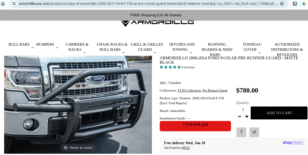

Not much to see. Collision repair is finished. The body shop installed an aftermarket grille and guard.
The electric fans on the truck were purchased from Mike Troyer Performance. The F-150 Fan Kit was a very popular modification, and often posted about. The fans and the new controller work flawlessly. If done correctly, electric fans are more efficient on older cars that were built with a mechanical fan. I've done this on several vehicles I owned in the past. I was happy with the results every time.

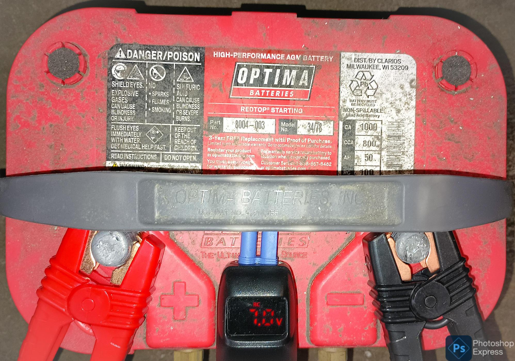

This is my final battle with the Optima RedTop. I've read whatever Optima has posted about being able to recharge their deeply discharged batteries, and how to charge them.
Like a dummy, I have a battery charger which is supposed to desulfate and recover depleted batteries. It has a special setting for charging AGM batteries. I read everything that the manufacturer has posted.
So I hooked up my car battery voltage reader, and ran the battery through the "repair" mode.
I have never actually seen a bad battery brought back to life. I have my doubts about being able to reverse stratification and sulfation. Like an idiot, I bought an expensive battery charger which claims to be able to fix bad batteries. So now, I have to use it and hope that it could work. I am 0 for 2 with this. My 6 year old Optima Yellow Top did not come back to life. My 10 year +, Harley battery did not come back to life. This battery is only 20 months old. But I do not have high hopes. I have no faith in miracles. My Dad says that it was a waste of $100 to buy a charger for fixing dead batteries, because you can't fix a dead battery.

The battery is no good. Charged it for 8 hours with the charger sending 13.4 volts. It read 12.1 volts immediately off the charger. The next morning, it's only 7 volts.
That's just like jump starting it, driving it, and not being able to start it again.
