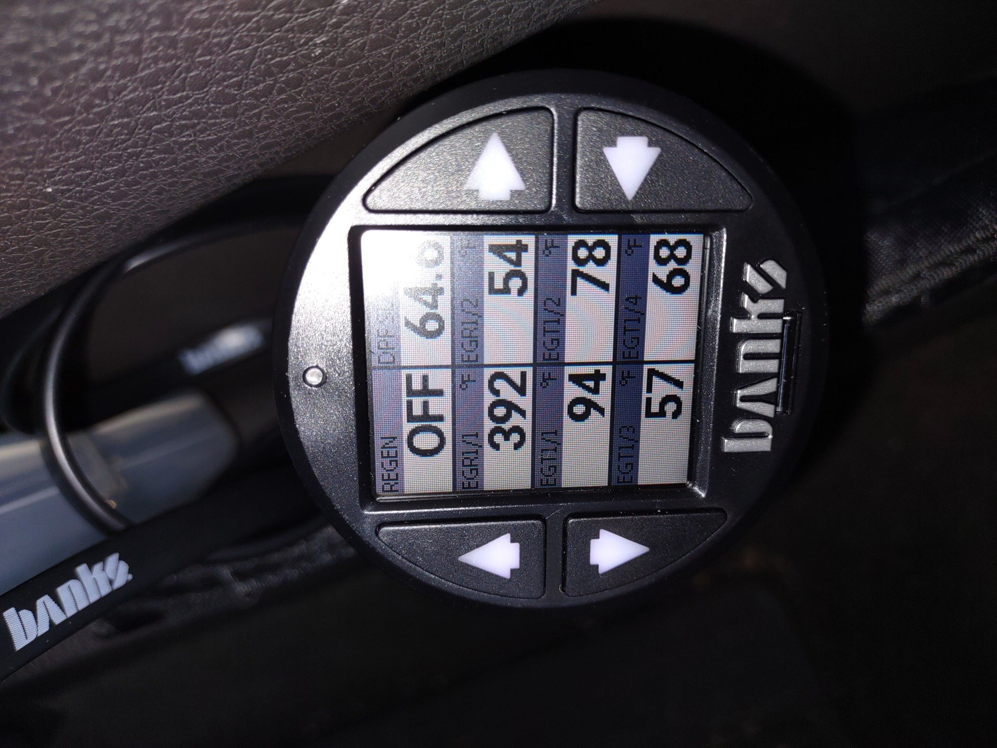

Whenever I start the truck egr1/1 is always at 392°, I talked to Banks and they suggested a soft restart on the idash which I will do after work today. The temp also goes up and down quite a bit too.

EGT vs EGR. Two different things.
On the banks the EGT sensors read EGRT. That is not the EGR valve.

I'm on my second day off today... I'll switch to my regen screen and see where my truck is at but like Scott says, EGR is different from EGT. EGR1 is exhaust gas directly from the exhaust manifold and the EGT PIDs are in the exhaust with EGT1 right after the turbo... So EGR1 will be hotter because it's coming right off the engine.

Pic of idash at start up.
