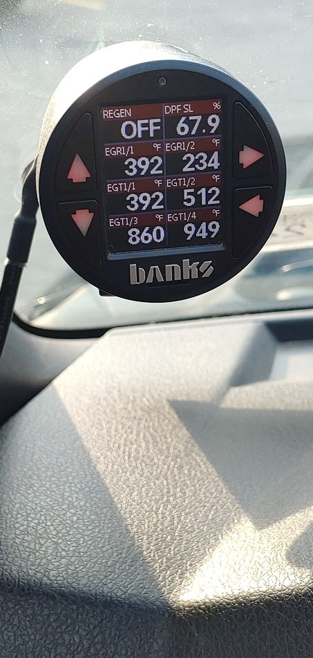

The Banks iDash can trigger a manual regen when the vehicle is warmed up... I once posted the procedure and parameters...
I had an active regen this morning... It came early for some reason... Before I even had 300 miles since last one which burned down to 15%... Been awhile since I saw an active regen take the soot load down that far.
Truck went FULL, iDash went up to 147% then started dropping once EGT4 was hot enough. 5 miles later I was in the parking lot at work. Truck dropped to 90% and iDash was at about 68%. Put truck in park and let it idle to shut off the regen and allow EGT1 to come down to 400 degrees.
This is the screen I have set up for regens...
Just before I shut the truck off. EGT1 got down to 389 degrees. I usually like it to get to 350.
I this a custom screen? I had some time the other day and started working through the set up process. Fortunately I have only need to drive once in the past few weeks, beer run. Lol
Today looks promising for an hour or two to try it again.
Yes it is... here's the page on the Banks iDash thread to explain how to do this... credit goes to @chadstickpoindexter

Old Aug 5, 2023 | 10:07 AM
  #45
smr camper's Avatar
smr camper
Joined: Apr 2017
Posts: 185
Likes: 47
From: fulltime rvers
Does Regen OFF mean the truck is not in regen mode?
DPF SL is that the percent of soot that needs burning off?
