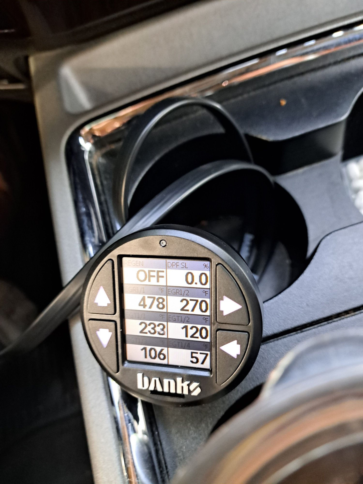

This is after we started up the truck and drove 200 yards. EGR 1 started at 395 and bounced all the way up to 740 during the initial drive to the store, it maintained a constant temp on the way home.
one is during regen, at one point I saw the soot load at 1.7.
this is the first time I drove the truck since settling up the Idash.
2nd regen
1st pic

Looks good. I would assume the pcm is commanding regen based upon your mileage and not the actual sl or soot load.
Dpf_rg will give you a time frame for the next regen in the form of a percentage with 100% being a commanded regen by the pcm.

DPF SL was at 0 when we left, is there another screen I need to look at other then what I have displayed?
1st pic, bottom pic, is the display when we left to go to the store.
