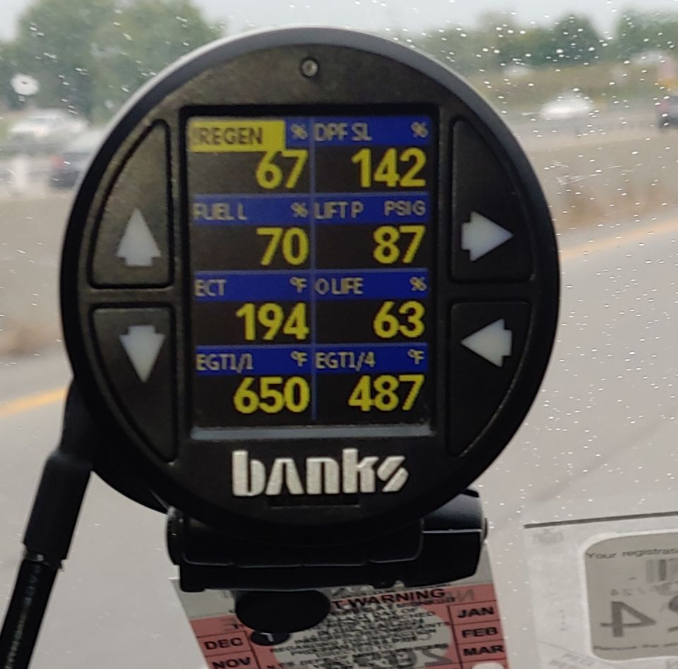

So the last 4 drives the message did not come up or show up on the idash. It would display after 4 miles and show up on the idash. These are the same and 2 longer drives than I have done previously.
Based upon your screenshot, you're missing EGT-4, which is the one that you really should be monitoring during regen, IMO. I believe mine is set up with EGT-1 and 4, with 1 being closest to the EGR and 4 at the DPF. Someone correct me if I'm wrong, going from memory here.
As far as iDash is concerned, I've observed on mine that it'll report the process as starting, but the temps don't really get cranking up to burn out the soot til some miles later. I reckon it depends upon the engine load as to how fast it gets up to temp. On highways it takes a little time at 1.5 RPM, for me that is.
Did you take it to the dealer and have them look at it... I forget now as I post and comment on my other threads...
I just realized that he didn't have that on there (EGT4) and can monitor DEF level %... especially on a 11 to 16 truck... I gotta check that out... maybe I'll turn on my regen background alert and replace it with the DEF level % screen...

Okay so this morning I followed the instructions found on that Banks YouTube short I linked to and activated my active regen background alert. I switched the regen status slot to DPF level %. I see the OP has a level of 67%. Mine said 69% when I switched to DEF level. It bounced back and forth to 70%... I'm having doubts it's actually accurate.. Time will tell.
