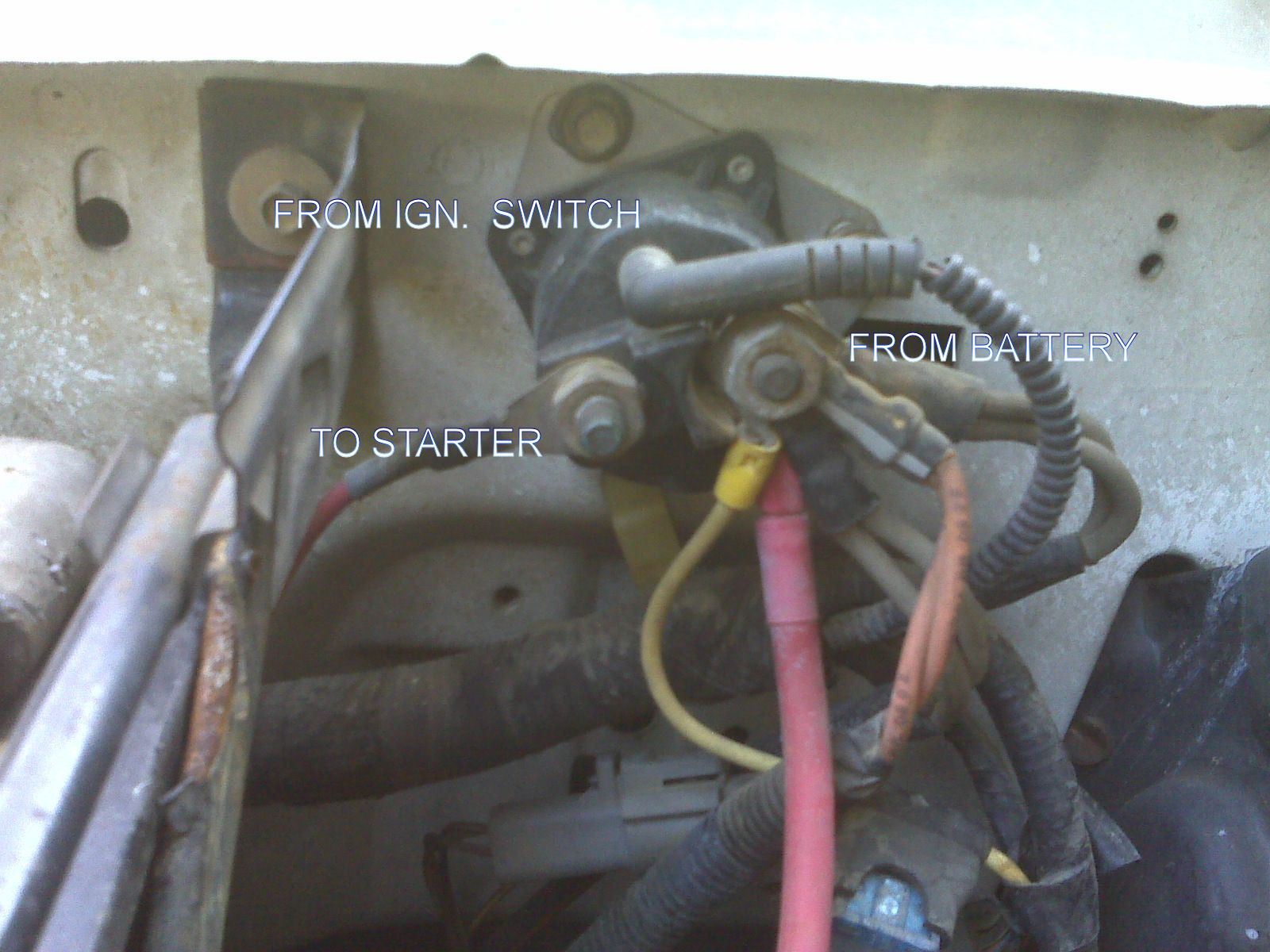

i found the starter solenoid:
i tapped it with a hammer (lightly) and nothing happened. I do have a electrical tester unit how would i validate its bad? the pic is just to confirm i know what im tapping, its not from my truck.
The truck is also parked outside in a desert and the wild life chew on everything.

With your multimeter set on V DC, test the terminal from the battery to ground, should see 12V. Test the wire/terminal from the ignition switch to ground with key to start, should see 12V. Check the terminal to starter to ground with the key to start should see 12V.

Details of how to test the starter relay are in this thread:
https://www.ford-trucks.com/forums/1...i-mean-it.html
You mentioned the interior dome light stopped working. How about other circuits, such as the headlights or horn? If all are dead, suspect the positive battery cable. Don't be fooled by the external appearance. The internal load-carrying capacity is what matters. This troubleshooting guide primarily covers the starter circuit, but the procedure is applicable to any circuit:
https://www.ford-trucks.com/forums/1...w-starter.html
Before even touching your multimeter, do you have this style battery terminal?:
If so, slam your hand in the door a few times as pennance. Then get yourself a proper cable assembly with pre-crimped terminals. A bad connection in either battery cable could cause the symptoms you have.

If tapping the starter relay didn't do anything check the wires near the passenger's fender. I had a connector that melted down and failed on my Bullnose truck. It caused the electrical to be completely dead like your problem.

If everything is dead, try this. Turn on the headlights, even though they won't illuminate. Wiggle the cables near the battery and see if the lights flicker. If so, you've got a bad cable.
If you insist the battery cables can't be the problem because they look good, I will hack into your phone and change your ringtone to this:
