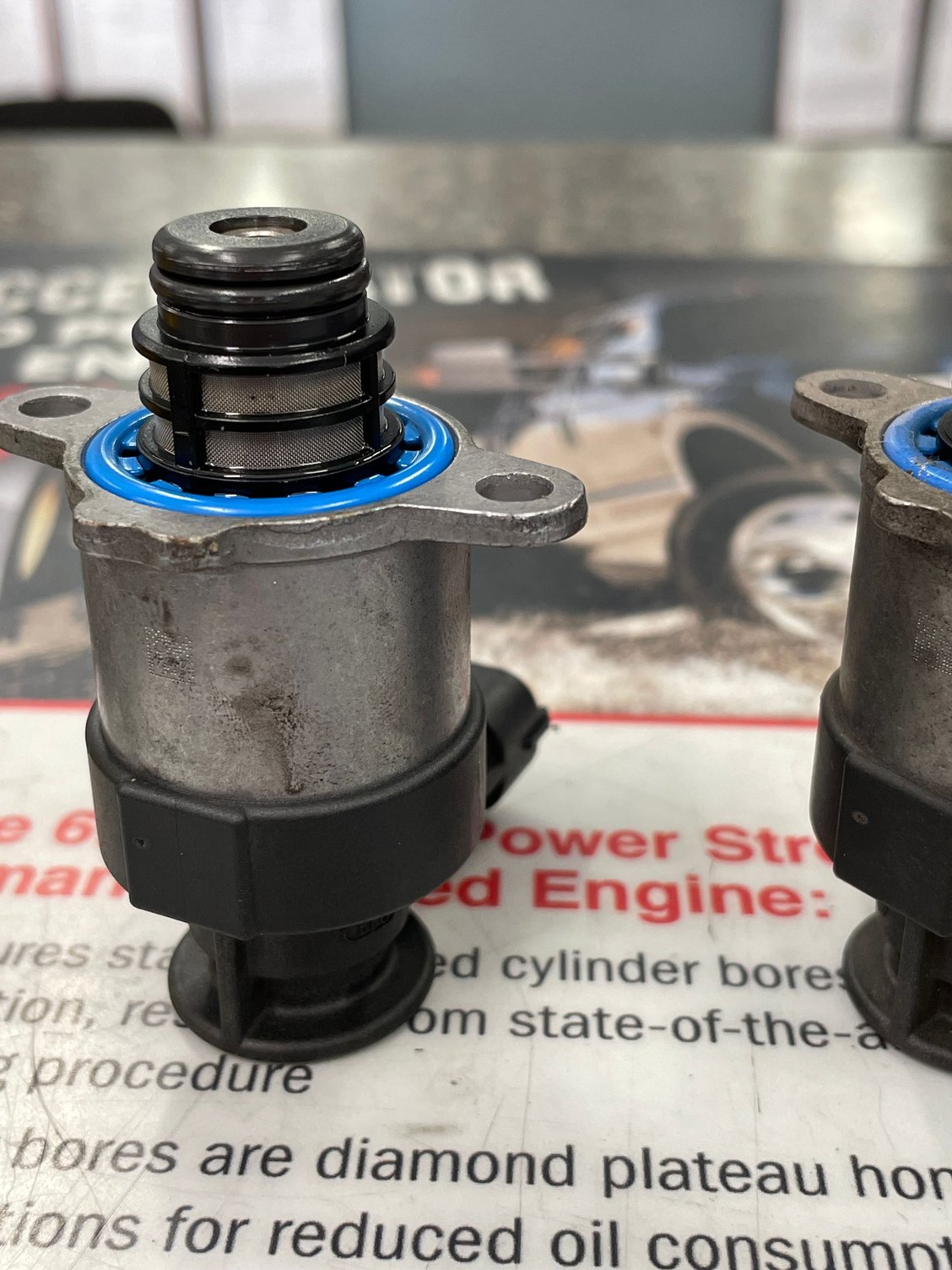

I had another shop pull the regulator. The picture proves that no metal is present, however the dealer mechanic says that the tiny speck of something is proof that my fuel system is failing and I will keep loosing injectors.

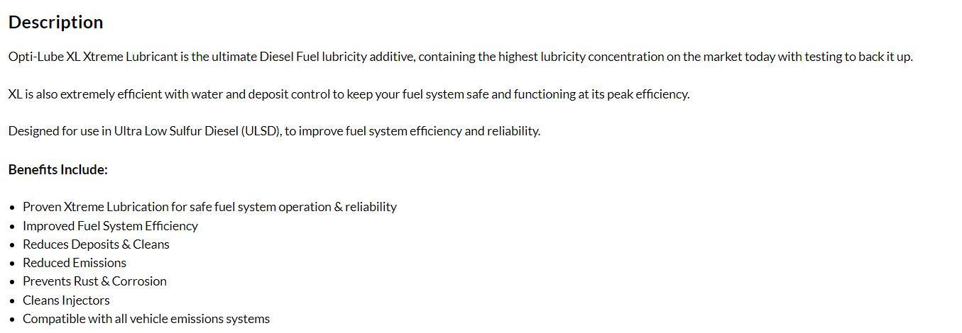

I use Summer+ in every tank and recently grabbed a gallon of XL and have been adding a shot of that to the dose. Cheap insurance in my mind.
Absolutely. I use XL (purple) for most of the year and Winter (blue) during the really cold months.
Don't see any claims it prevent's CP4 failures. Is the presumption improved lubricity prevents catastrophic failure? I can see it extending the life span for a normal operating pump, but not preventing the roller lifter from rotating and causing catastrophic failure. Curious to what your logic is.
