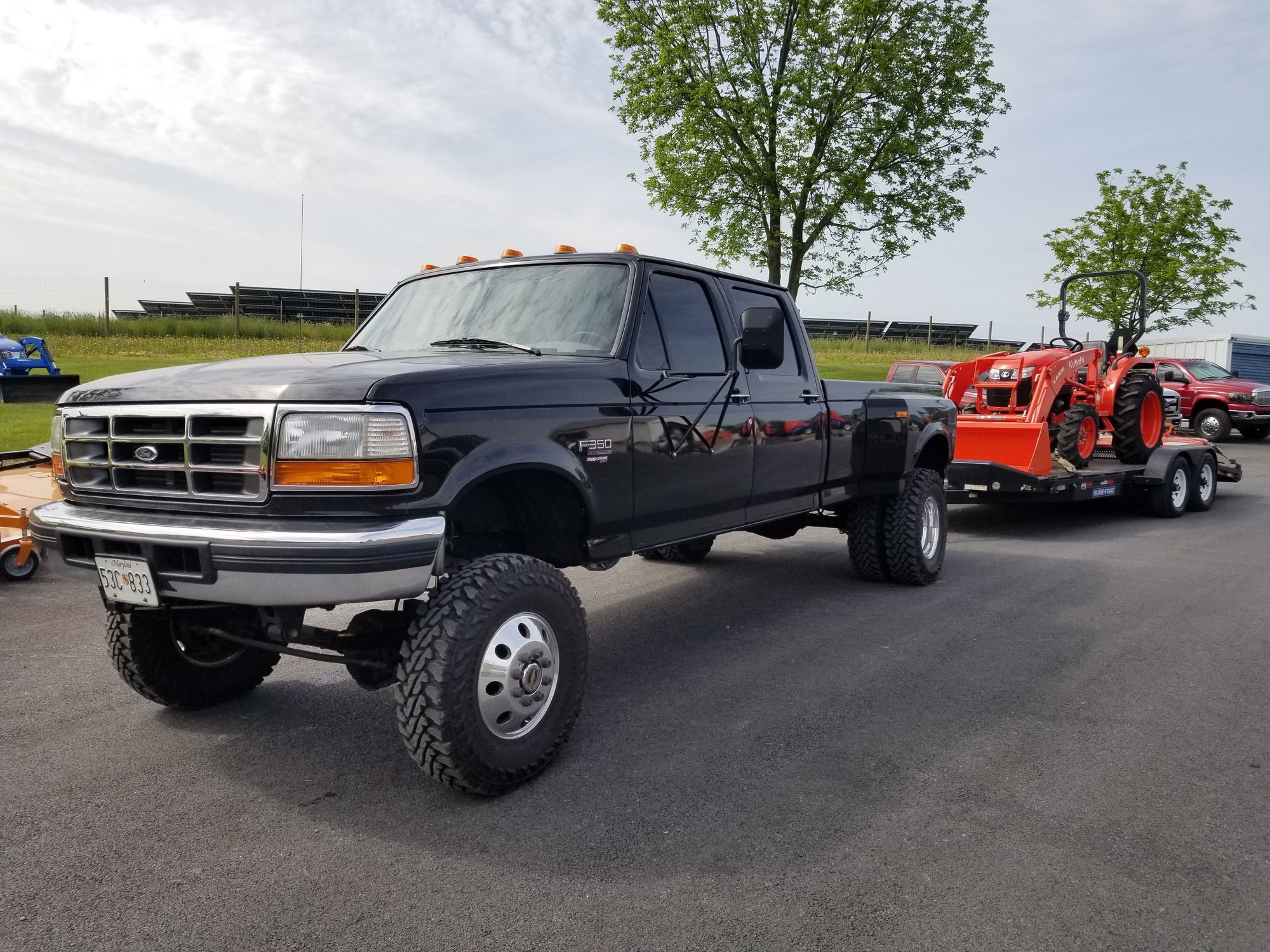

Originally Posted by Briansshop
This truck was converted to 4x 20yrs and 40k miles ago. No issues with the 2x frame.
I might have missed it,but what's Stage 2!?
Woah! That's a beautiful truck!
Thanks for the input on the 2wd frame! Can't fix stupid i guess!
Stage 2 is the drive-train, transmission and t-case!
It's currently done, i just need to load the photos and post the info. Not really anything to it. I think the hardest part was cutting the hole for the t-case shifter on the cab floor!
The drive shafts swapped right on with no problem.
I did have to drill holes for the 4x4 cross-member, common sense and a tape measure got it good enough, I thought there would be holes already but only one lined up.
