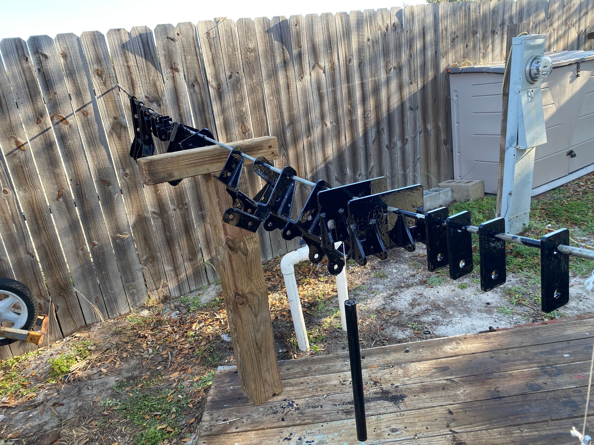

Prep Prep and more Prep
Alright, sister got married the whole family got sick took a trip but I’m back on track now!
I have all my Sky parts primed and painted, I also took off everything I will need from the donor truck, u bolts sway bars and mounts etc etc and have sanded and painted them as well!
I’ll put together a comprehensive list of do-dads and what-nots you’ll need from the donor truck here shortly!

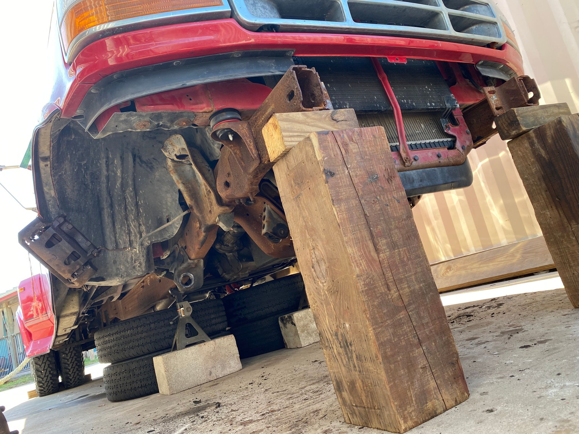

Out With The Old
I started tearing off all the twin I beam stuff, shocks, axles, springs and steering it all came off in 30 min by myself.
Removing the rivets was a chore but not as bad as I thought it would be, all that needs to happen is to grind/cut the head off and pound it out with a drift.
My two brother-in-laws and I removed both TIB brackets, coil buckets, pitman arm, brake lines, control arm brackets and steering stabilizer in 2 hours. The easiest way was to use a cut off wheel and metal grinding wheel to cut off the heads and pound it out with a drift but we did use a torch on a few of them but all that did was get the rivet hot enough it kinda welded it to the frame and was much harder to pound out.
The pitman arm was a pistol! Good grief! Gear pullers slipped off, got an actual pitman arm puller and it bent it open even while I beat the tar out of it with a hammer as I pulled! Finally made two relief cuts with a cut wheel and it dropped right off!
This afternoon I’ll strip the frame and paint it, should be adding the new parts by the weekend!

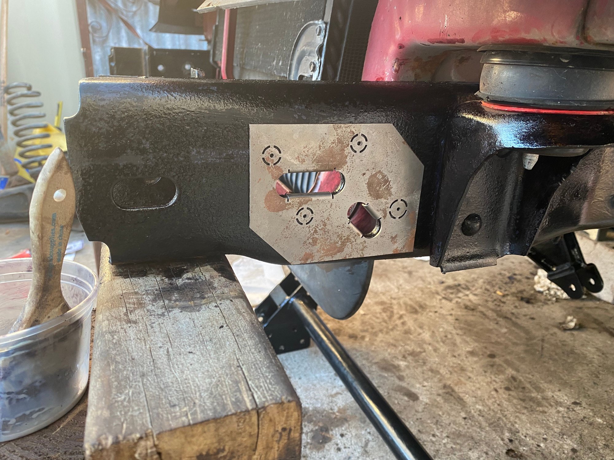

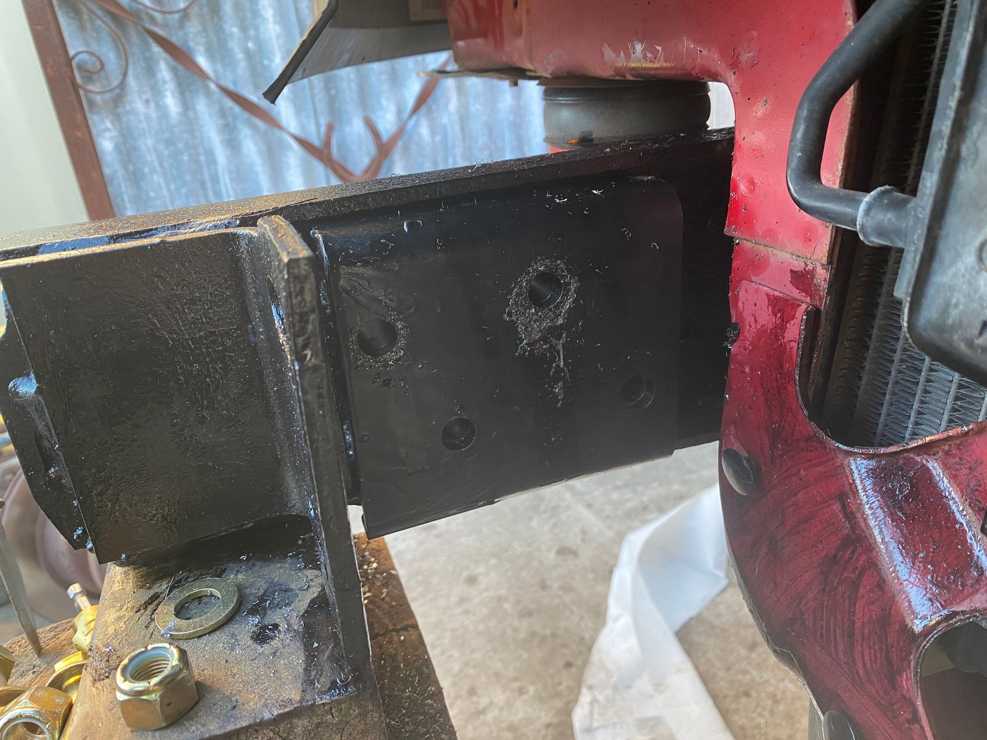

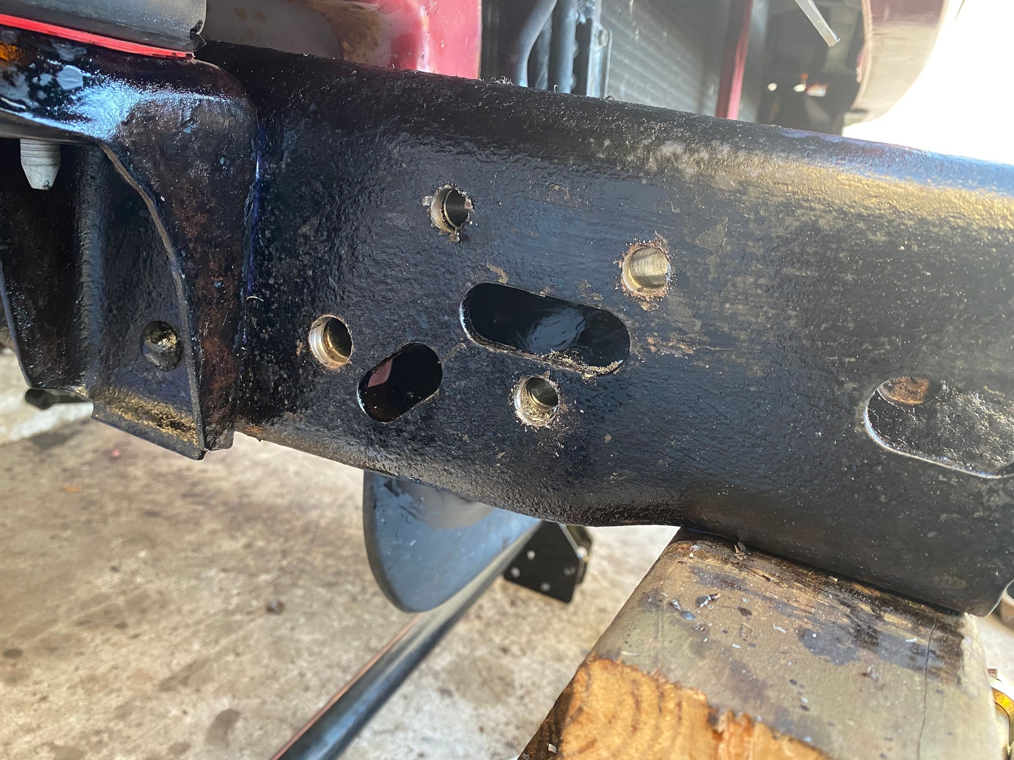

Frame Boxing
Got the frame cleaned up and ready! I started installing the front frame boxes.
Instructions say to drill the one 5/8” hole on each frame horn, mount the front RSK then measure to the rear bracket and pivot the front RSK until you find your exact distance, which is the length of the leaf spring, and at which point you mark the rest of the holes and then drill.
But being I have no rear bracket holes to measure to I drilled and mounted the front bracket where it sat flush and then I will measure back to the rear bracket minus one & a half inch (1.5”) less than the length of the leaf spring (while under weight)
When drilling the holes, you use the template that comes with the kit to find the location of the one 5/8” hole and drill it using the template. Then put the frame box in place and snug up the 5/8” bolt to secure the frame box in place. Then come from inside the frame and drill the rest of the 1/2” holes using the frame box as your guide. The template didn’t always align correctly with where the frame box sat.
Do yourself a favor and buy some fresh drill bits. I used Bosch 1/2” bits and a dewalt step bit which made the job easy easy…. and don’t forget to add liberal amounts of oil!
Sky’s said to tack weld the frame box once the first 5/8” hole was drilled but the 5/8” bolt held just fine as there wasn’t any room for it to shift anyway. After the first 1/2” hole I also put a 1/2” bolt thru and snugged that up as well just for good measure.
I need to check if the spring measurements are taken under load or relaxed? But I’ll figure that out and post back!
