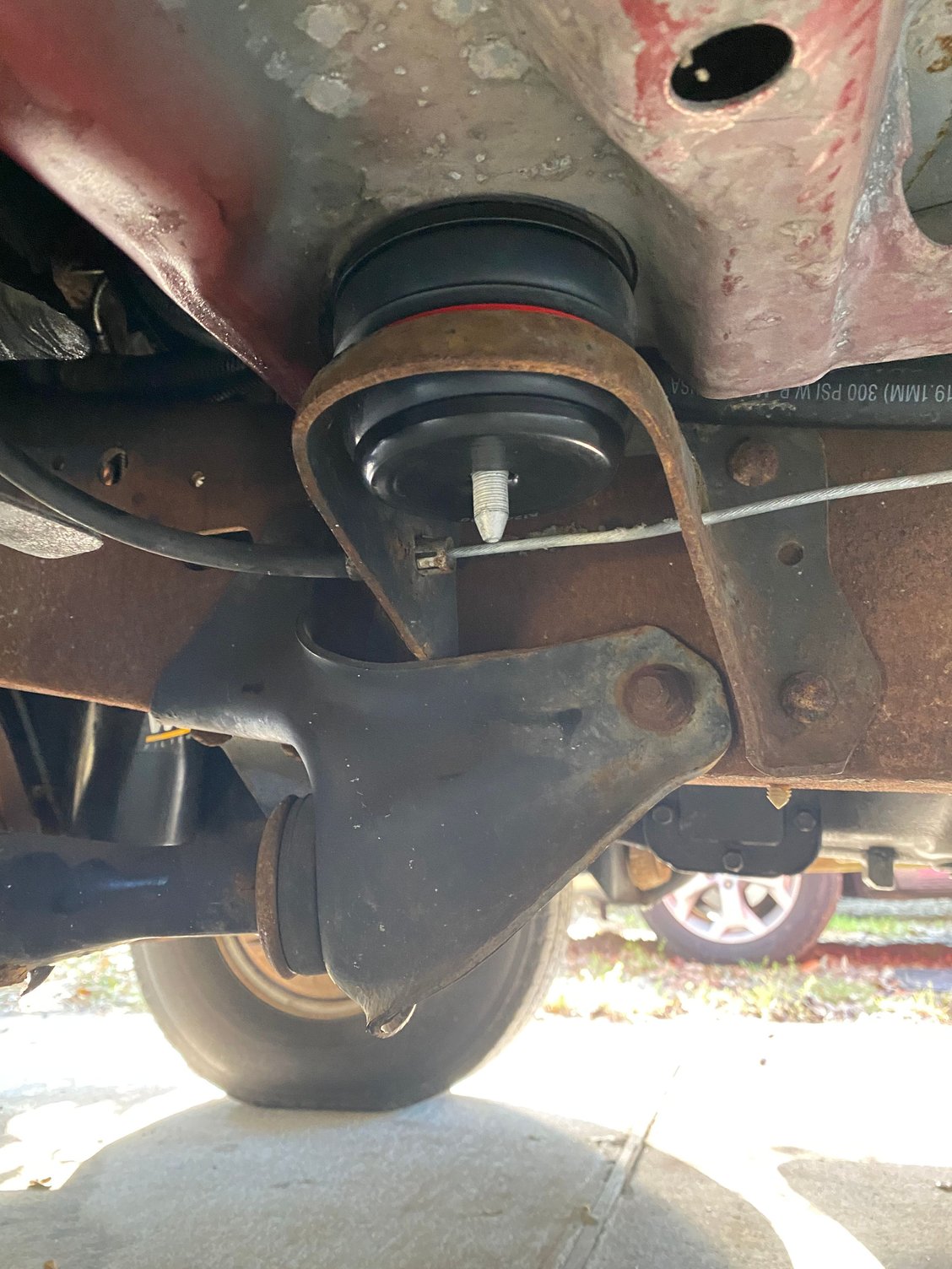

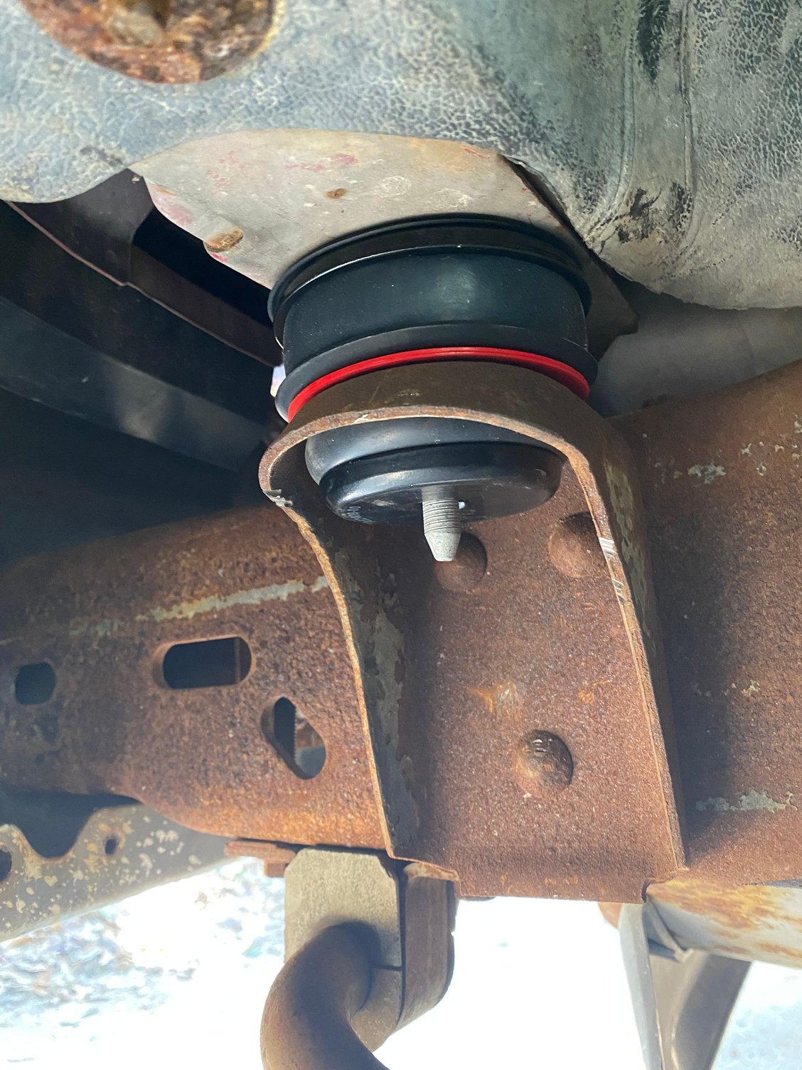

S&B Body Mounts

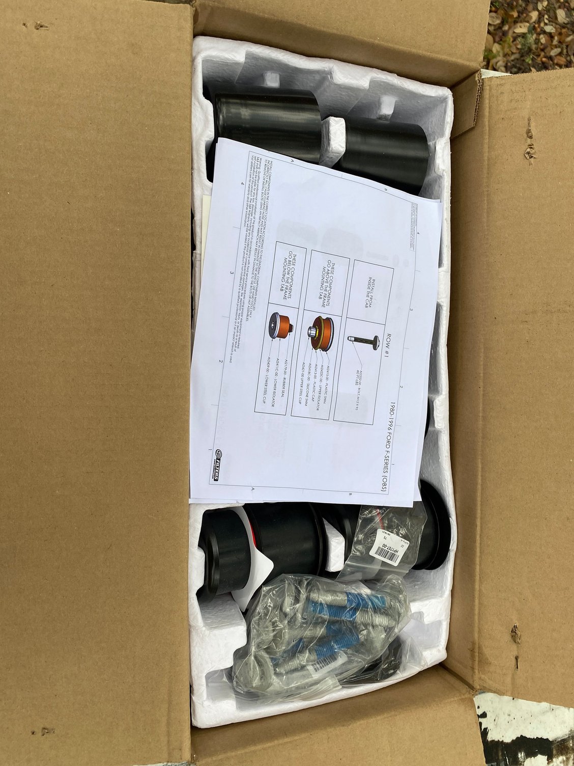

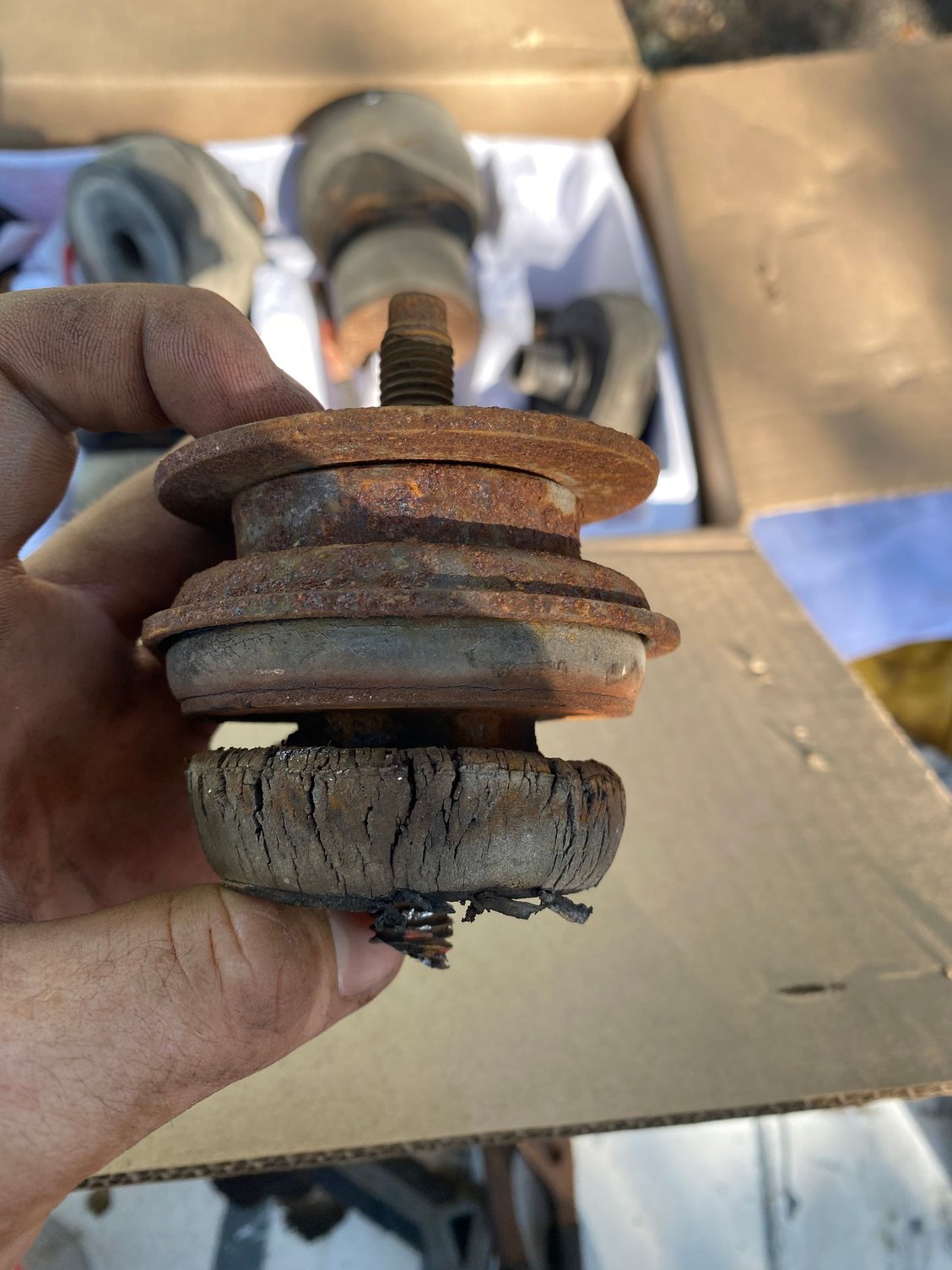

A little off topic but the old body mounts were trashed so I got me some S&B! I must say I do not like purchasing stuff from Californication but these folks must be one in a million, they called me a week after I received the mounts just to ask me if the install went well! Wow!
Shipped fast and was super easy to install thanks to the included removal cups! I was able to do it all with out dropping the fuel tank, you do have to take the straps off and lower it with a jack but everything can stay connected!
The front ones were so rusted I had to cut the bolts as the heads snapped off on the first zap of the impact! Other than that install was easy!

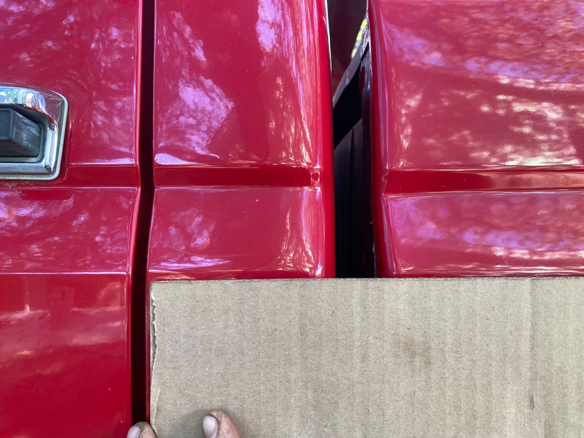

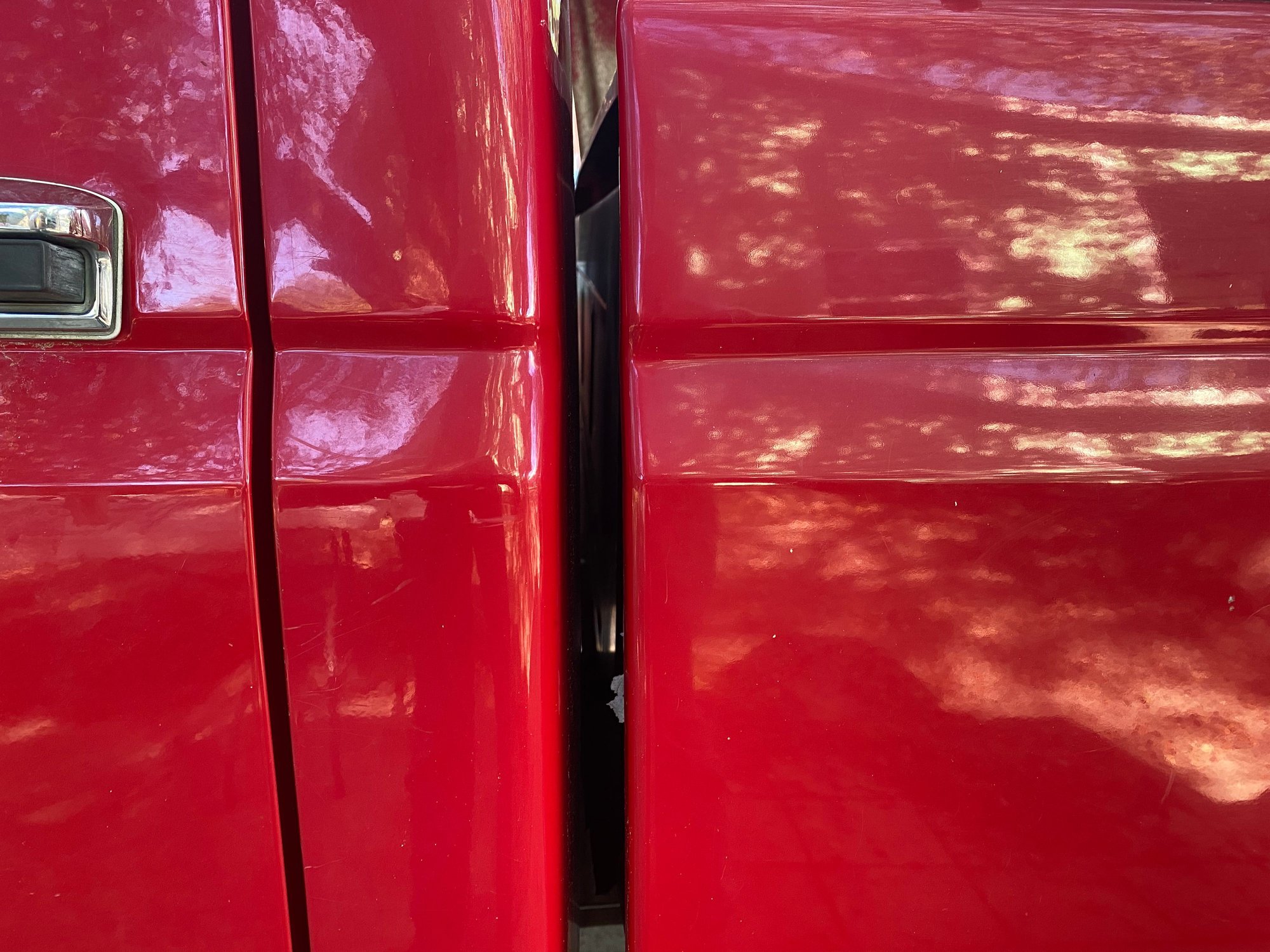

The truck rides without that terrible metal on metal sound! I used some of the shims to get it as spot on as I could, it looks good to me! I am cursed with level and plumb eye!
I really should have waited to put my 3” DP in when I was doing this, would have been a breeze!
