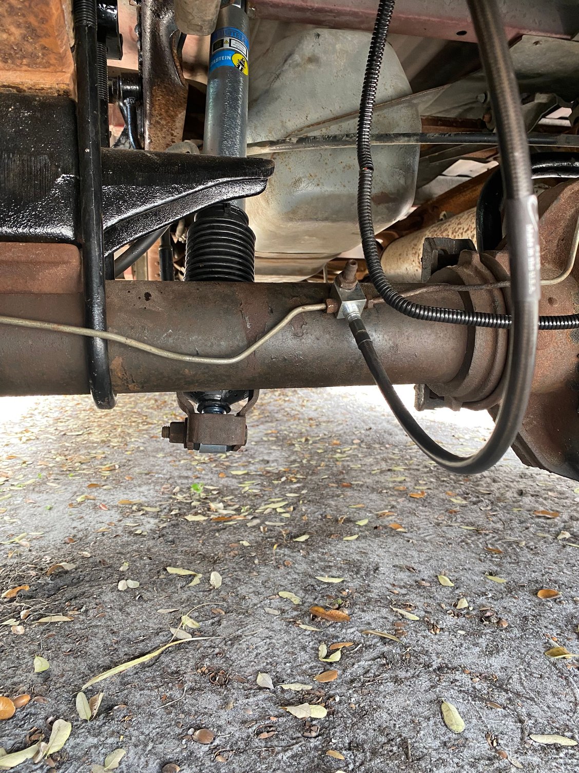

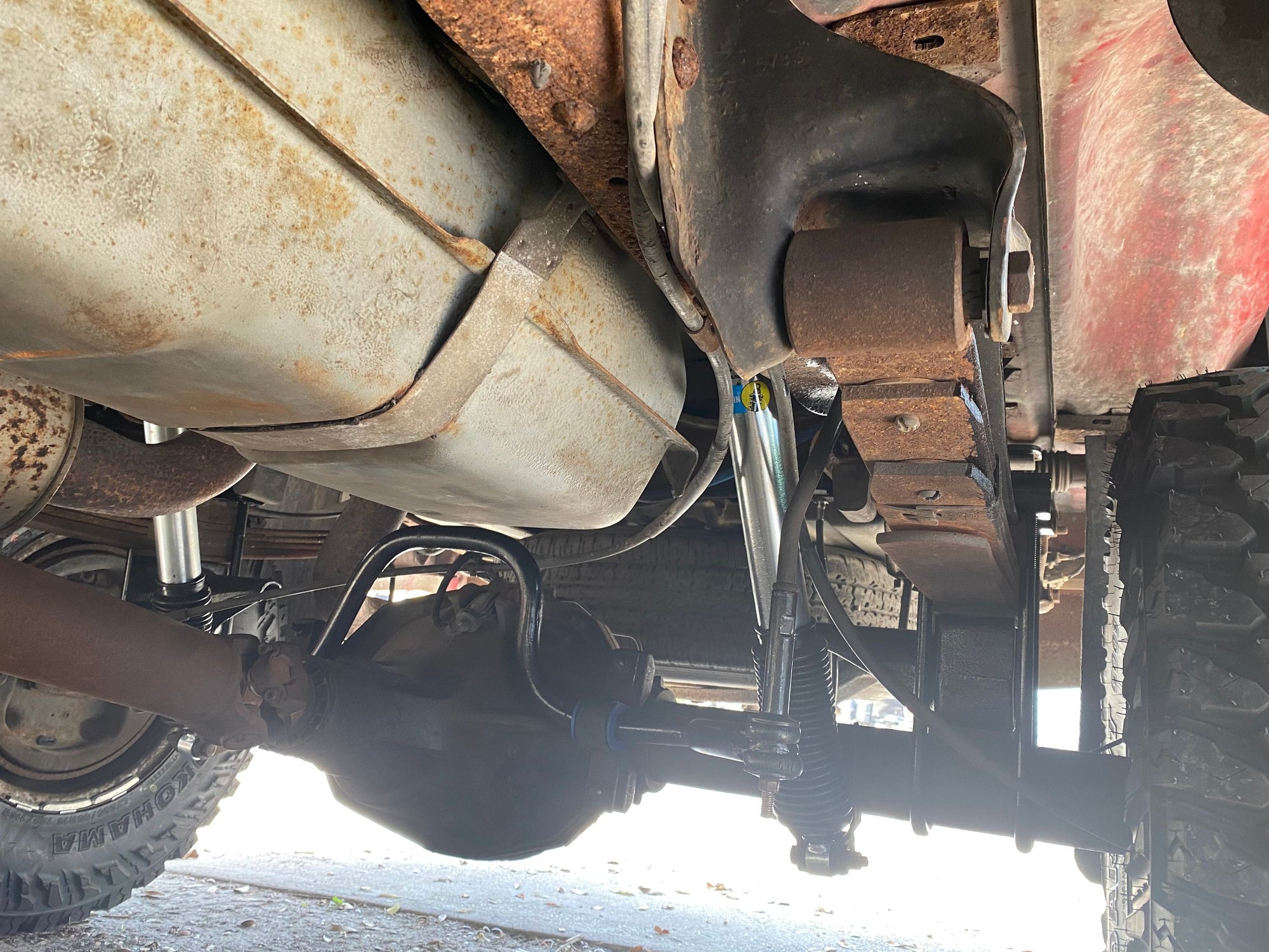

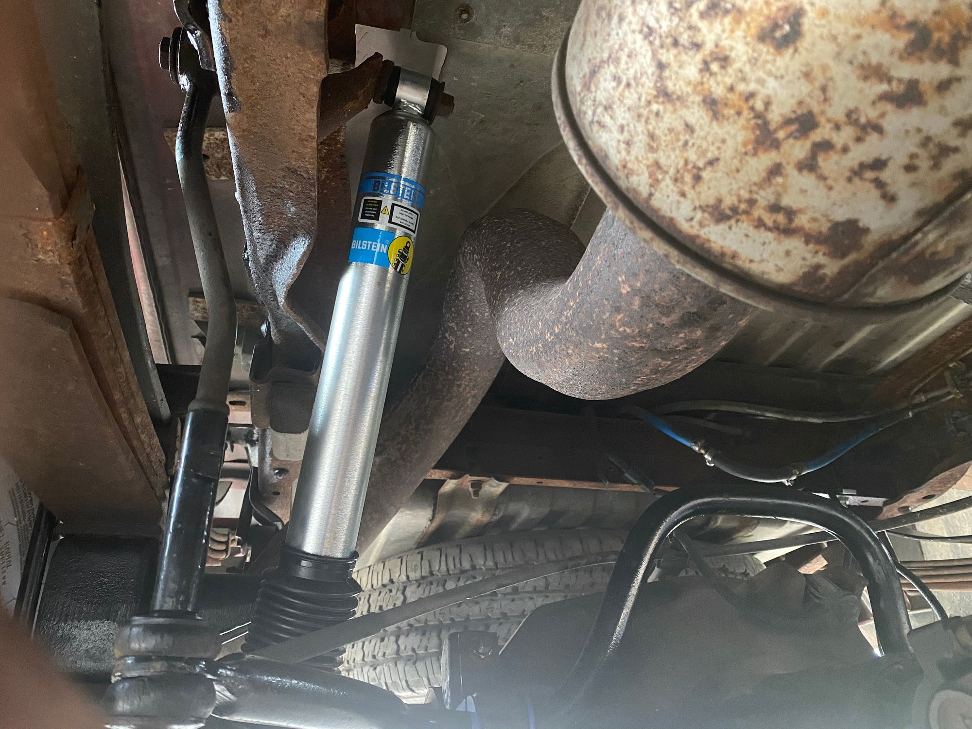

Alright I got the rear blocks, shocks and brake lines on and ready to go!
The stock 4 inch blocks worked just fine for a leveled truck tho it looks like the rear sags but according to the body lines the rear is exactly 1” higher than the front. So if you’re not going to be towing a whole lot then the 4” blocks should be fine!
The shocks were no problem, popped the old out and the new ones went right in!

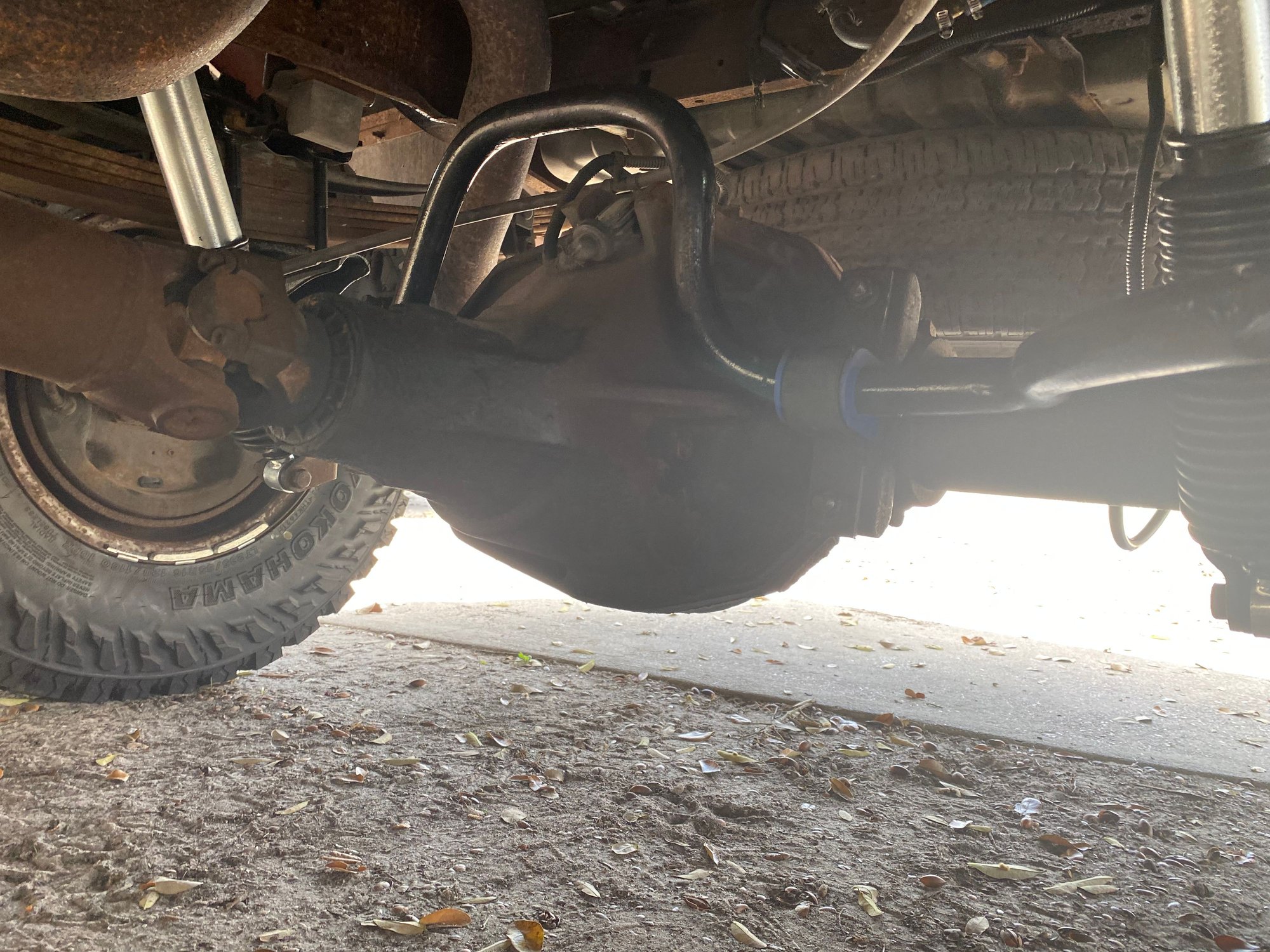

The brake line for the rear was a pistol to get the old one off, it sets on a “shelf” and allows a lot of rust and corrosion to build up so you need to be careful you don’t round off that little 7/16 copper nut. The old brake line went back on the opposite way (picture)👇🏻 It points down instead of up like the stock one did. Not a big deal really I just don’t like that it’s hanging down to catch on a piece of road debris and leave me brakeless! Each side of that little block has different size ports so it has to go that way. Not a whole lot you can do, I will need new pre-bend ss brake lines soon so that may fix the problem depending how they come!
Taking it to get an alignment in the morning then I’ll post the Finished Product Of Step 1
Brake line inverted

I forgot to mention that the SRW sway bar end links are different than the DRW end links! The SRW are straight and the DRW have an offset to them. So one less thing you need to take from the donor!
You can see it in pictures above 👆🏻

Thats odd, your end links are different then mine. Don't mind the cheap shocks I went with instead of your sweet Bilsteins.

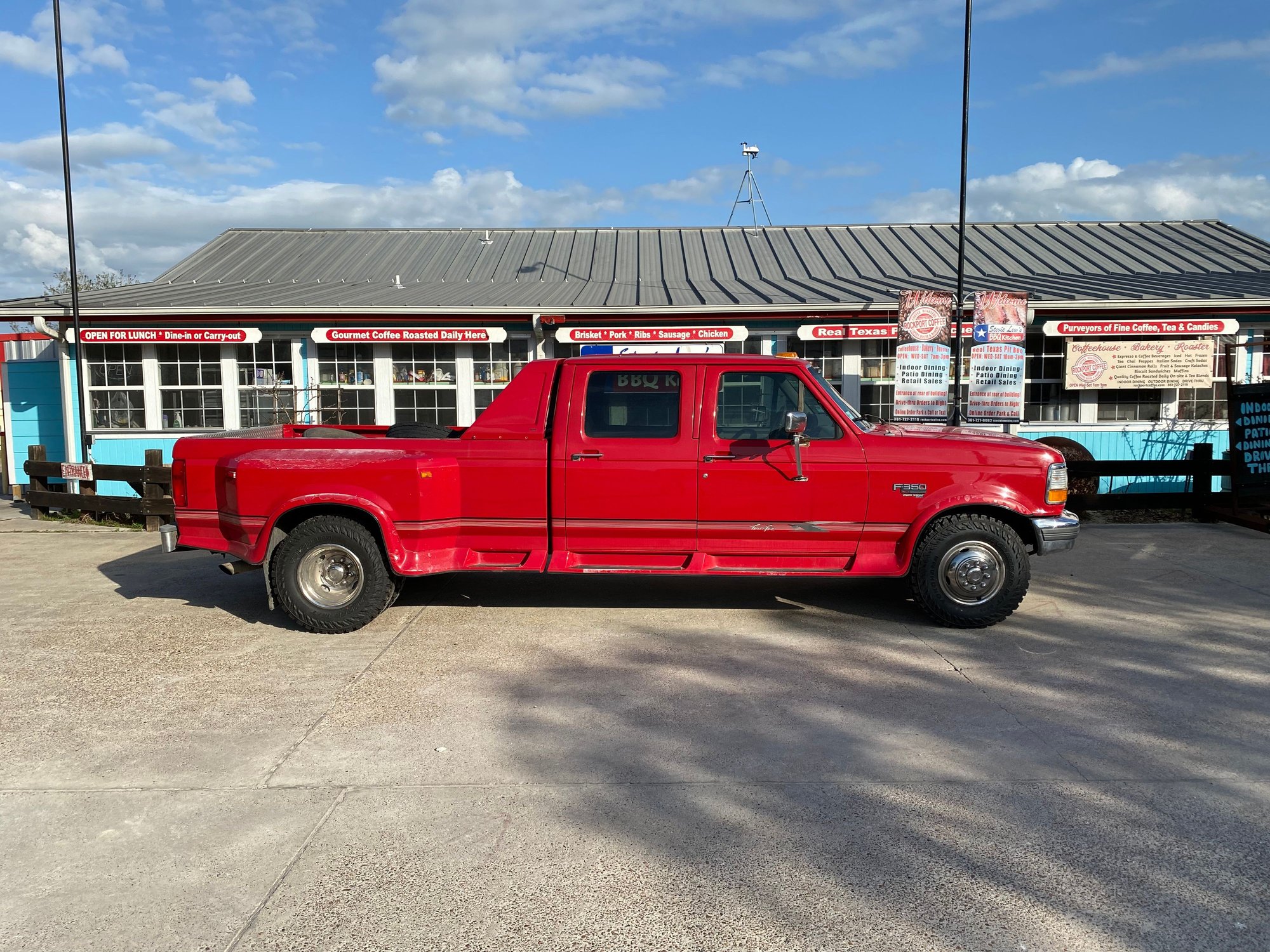

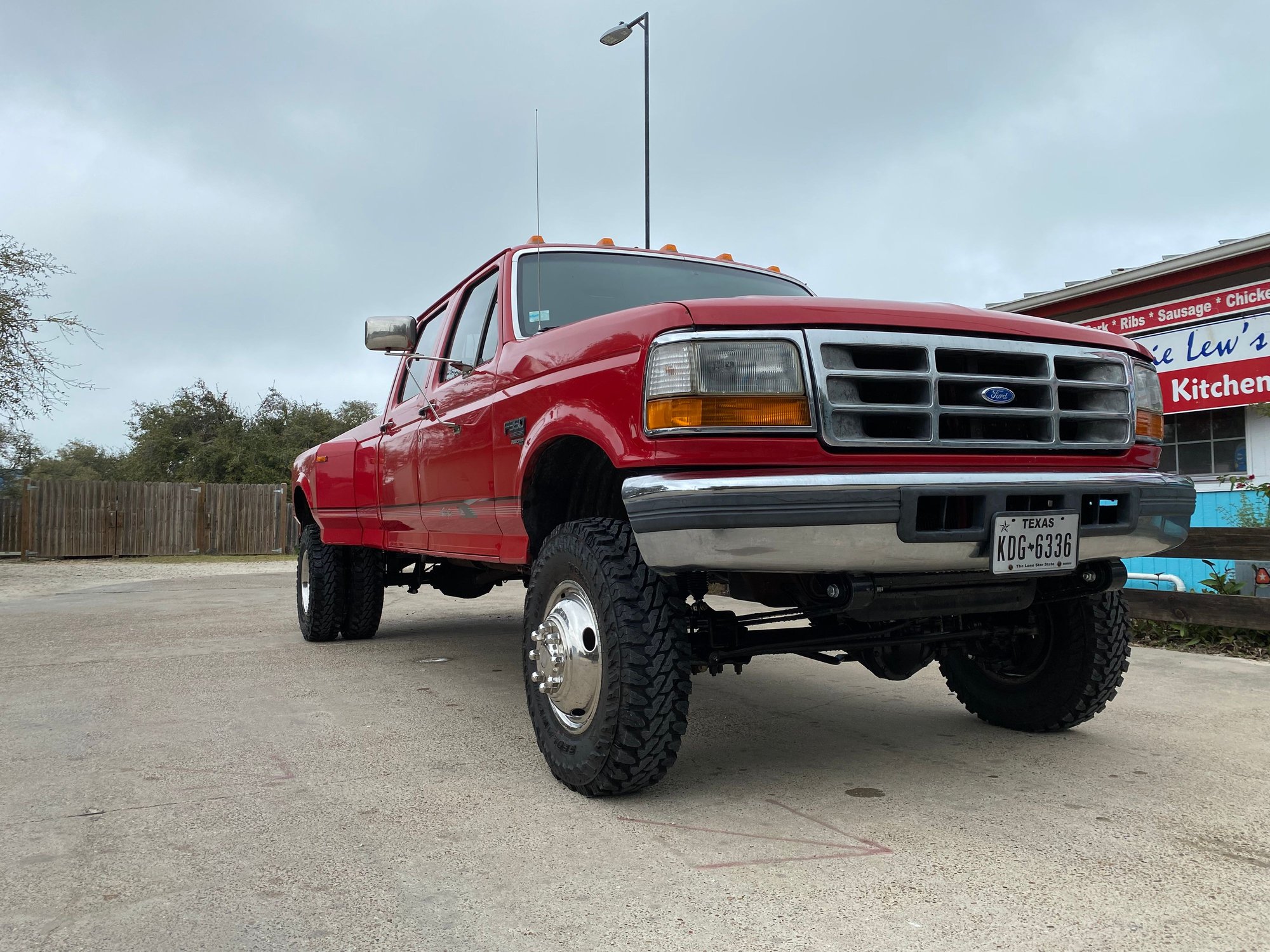

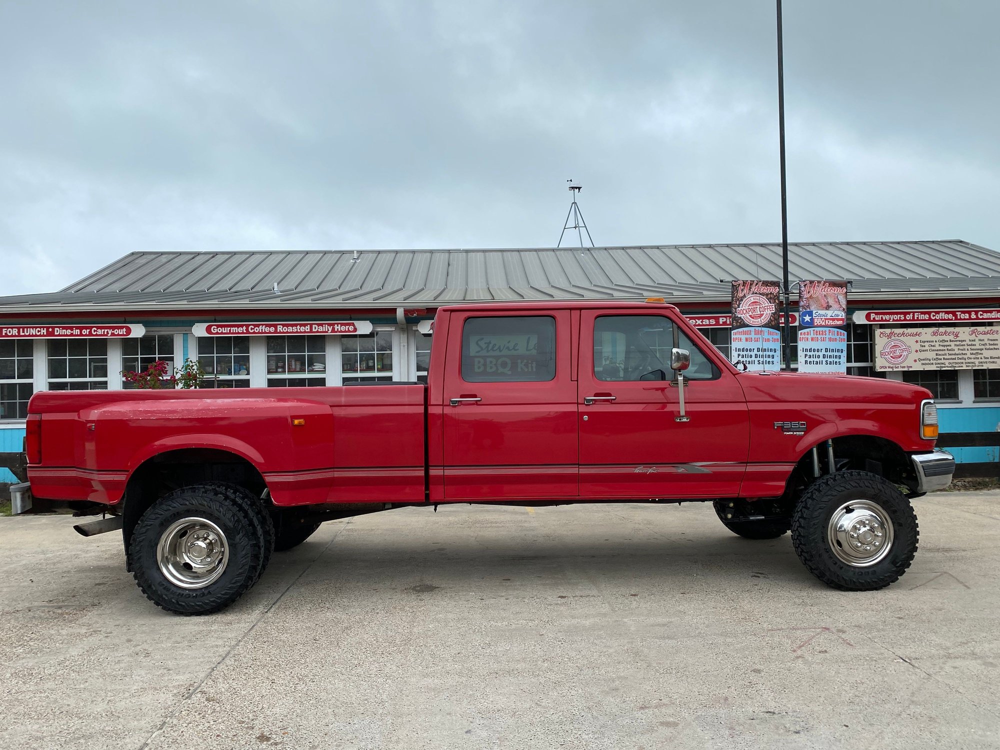

Step 1 Complete!
Alright the moment we’ve been waiting for!!
Before and afters!

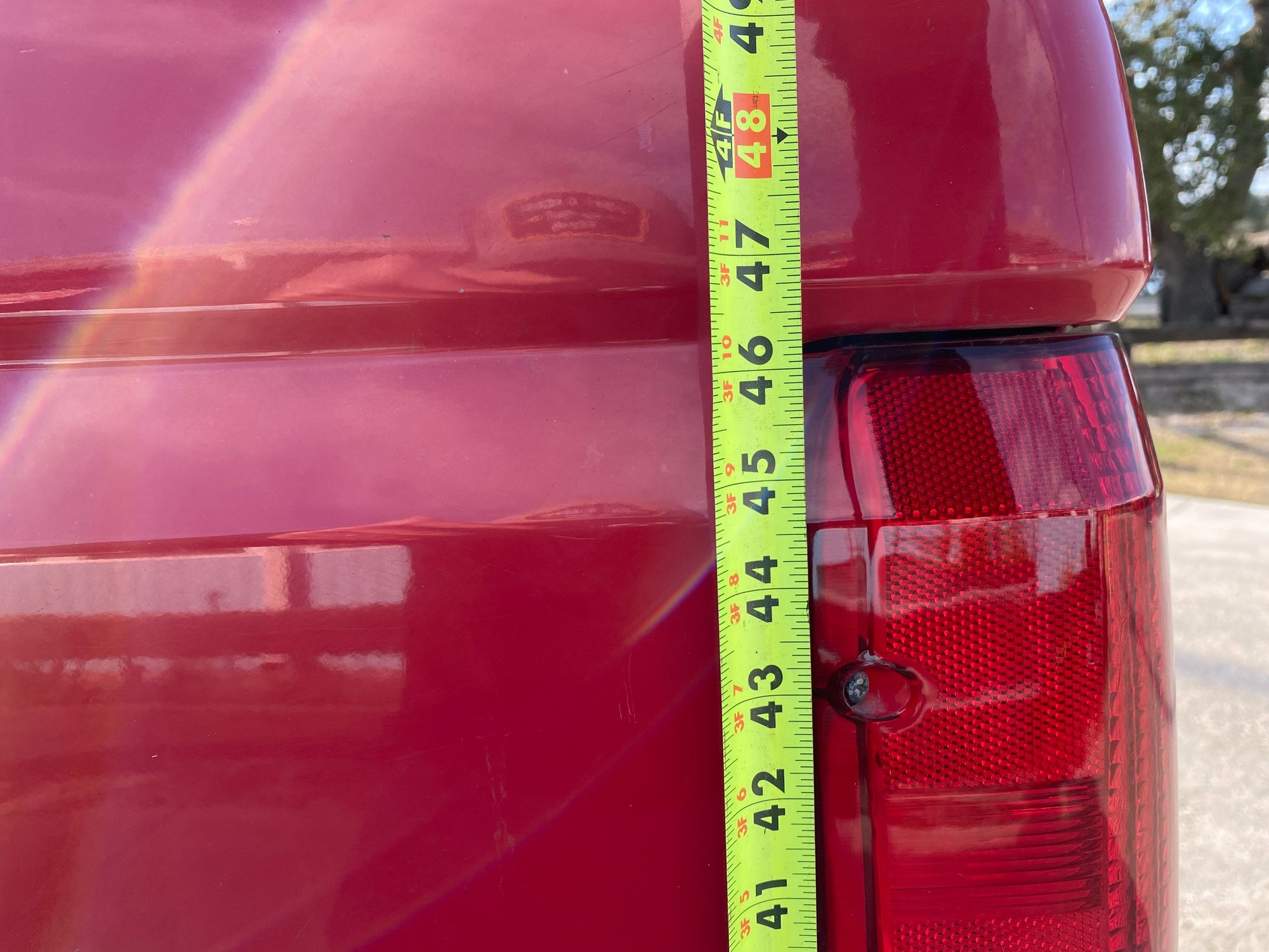

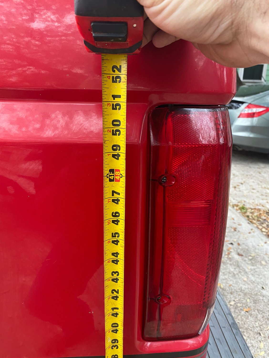

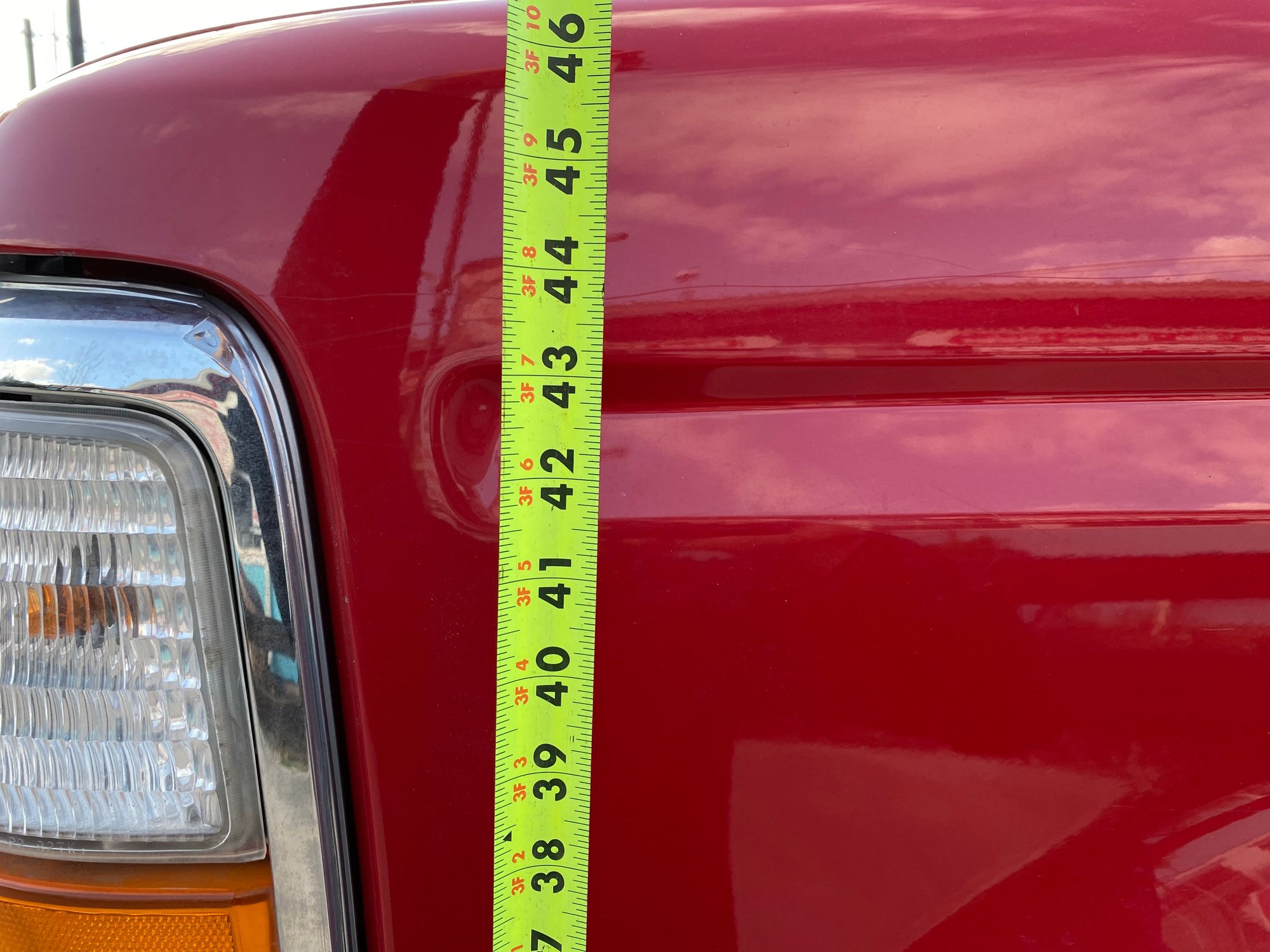

Lift Height
Front Before
Rear Before
Front After
Rear After
