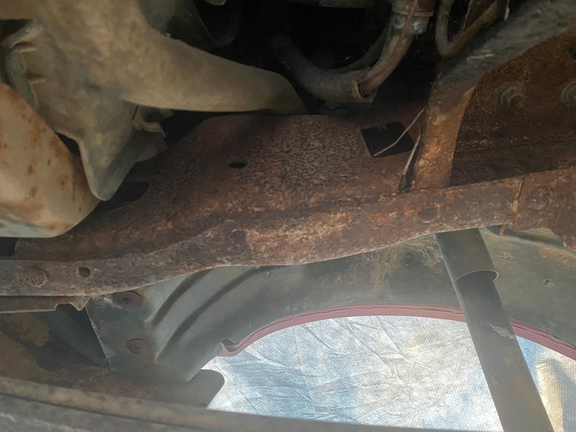

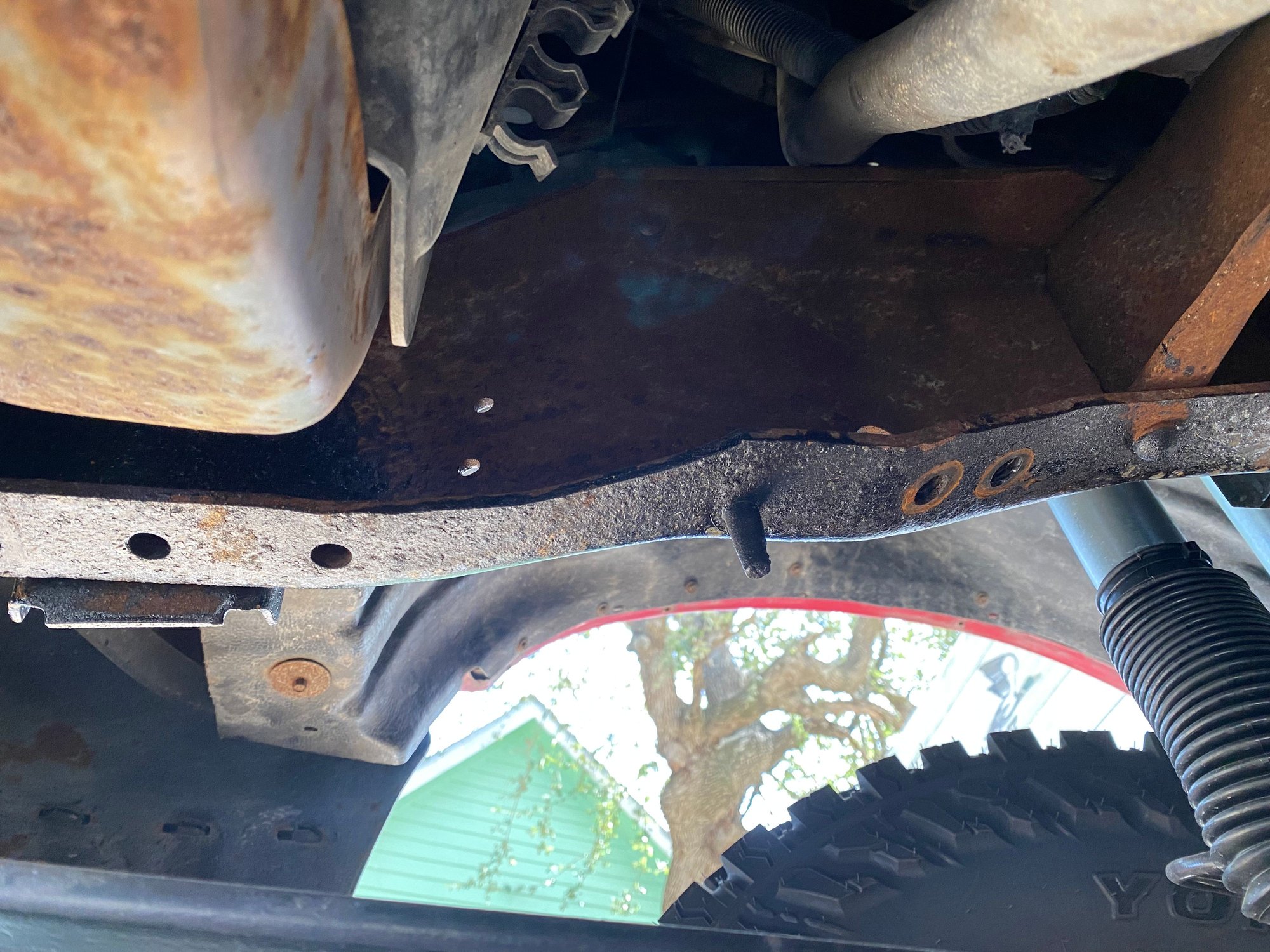

2wd Frame vs 4wd Frame?
Alright! John Wayne said it best, “every man is entitled to his own opinion”
So this post is directed to the people that are considering doing a job like this, not to the people that my disagree with my opinion.
When comparing the 2wd frame to the 4wd frame the differences will be shown in a photo below, there is an ~18” chunk of support on the 4wd frame that is not on the 2wd frame and that is the only substantial difference between the two frames, when doing a RSK like me.
So the argument that the 4wd frame is “stronger” than the 2wd, that argument is based on one ~18” piece of metal along the entire frame.
Now that being said, quesey (forum member) made a good point that if you are not boxing the front frame horns with a reverse shackle kit (RSK) and you are simply taking stock 4x4 parts and adding them to the 2wd frame, then yes swapping frames would be a better route as you will be doing a lot of custom fabrication including welding, cutting and customizing the frame and if you don’t get it correct you’ll have one of those truck rolling sideways down the road!
The other point is that you don’t have the stock leaf bracket holes to bolt your new brackets to but if you can’t use a tape measure to figure that out then the whole job is over your head already.
Now let’s do a little basic physics why don’t we!
You take a 2wd coil sprung truck, the entire front end weight comes down on one point of contact and that is the coil bucket. The control arms and the twin I beams do not have the same gravity-weight on them like the coil buckets. So all that weight comes down on a “weak” part of the frame, but I have not read one single write-up where someone took and beefed up their 2wd truck frame in that one single location because it was breaking, cracking or for whatever reason!
Now a 2wd leaf sprung truck (converted to 4wd) is setting on leaf springs with two main points of contact (each end of the leaf) and one of those points, with a RSK, is on a boxed frame horn that is substantially stronger than the stock 4wd frame horn only after you put 4 big bolts, a 5lb block of iron and the RSK bracket on to snug that front end up.
So to say that someone needs to swap frames because it’s missing one 18” piece of frame support that other Ford trucks didn’t have, is absolutely ridiculous.
Now if you’re building a rock crawler or a sled pull truck or a drag truck then okay sure you may think that would be necessary but for the everyday truck, no.
I would compare that to saying “I’m getting new stage 2 injectors so I have to put a new camshaft in just to make sure the engine can handle the extra hp”
But if you have the time and money to pull your engine, pull your cab, pull the bed, pull the rear axle sand swap it all over, then hey go for it!
So in a nut shell you’d have to be an absolute IDIOT to think you need to swap frames for this job!
Thanks!
4wd frame
2wd frame
But if you have the time and money to pull your engine, pull your cab, pull the bed, pull the rear axle sand swap it all over, then hey go for it! But for someone like me, swapping frames for this job is absolutely unnecessary.
4wd frame
2wd frame
I can not believe you would dare come on this forum with some common sense. Good work! We think these trucks need way more than they really do. I have pretty much gone the KISS method for a few years. It works well. These trucks were already good to begin with.
