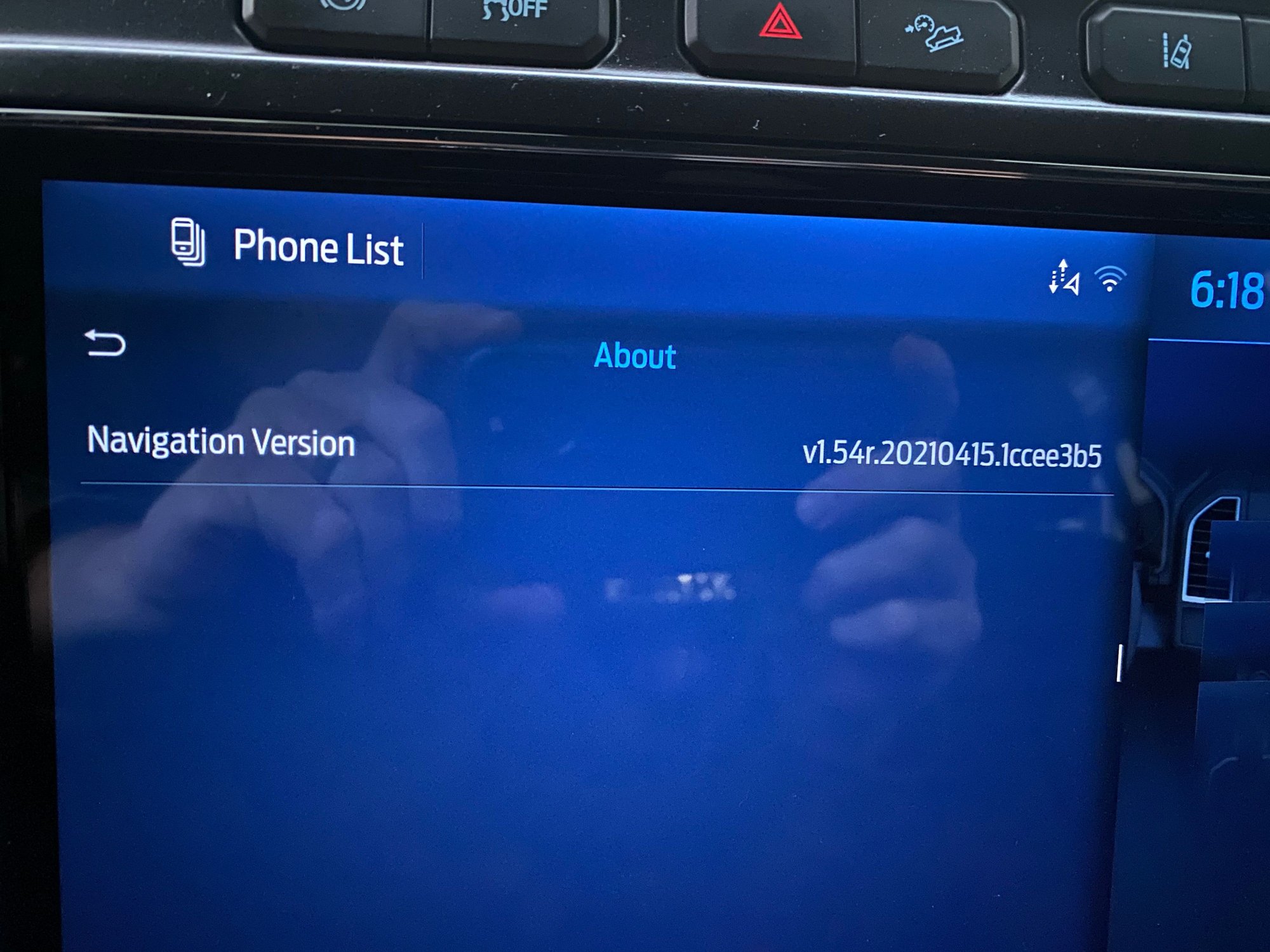

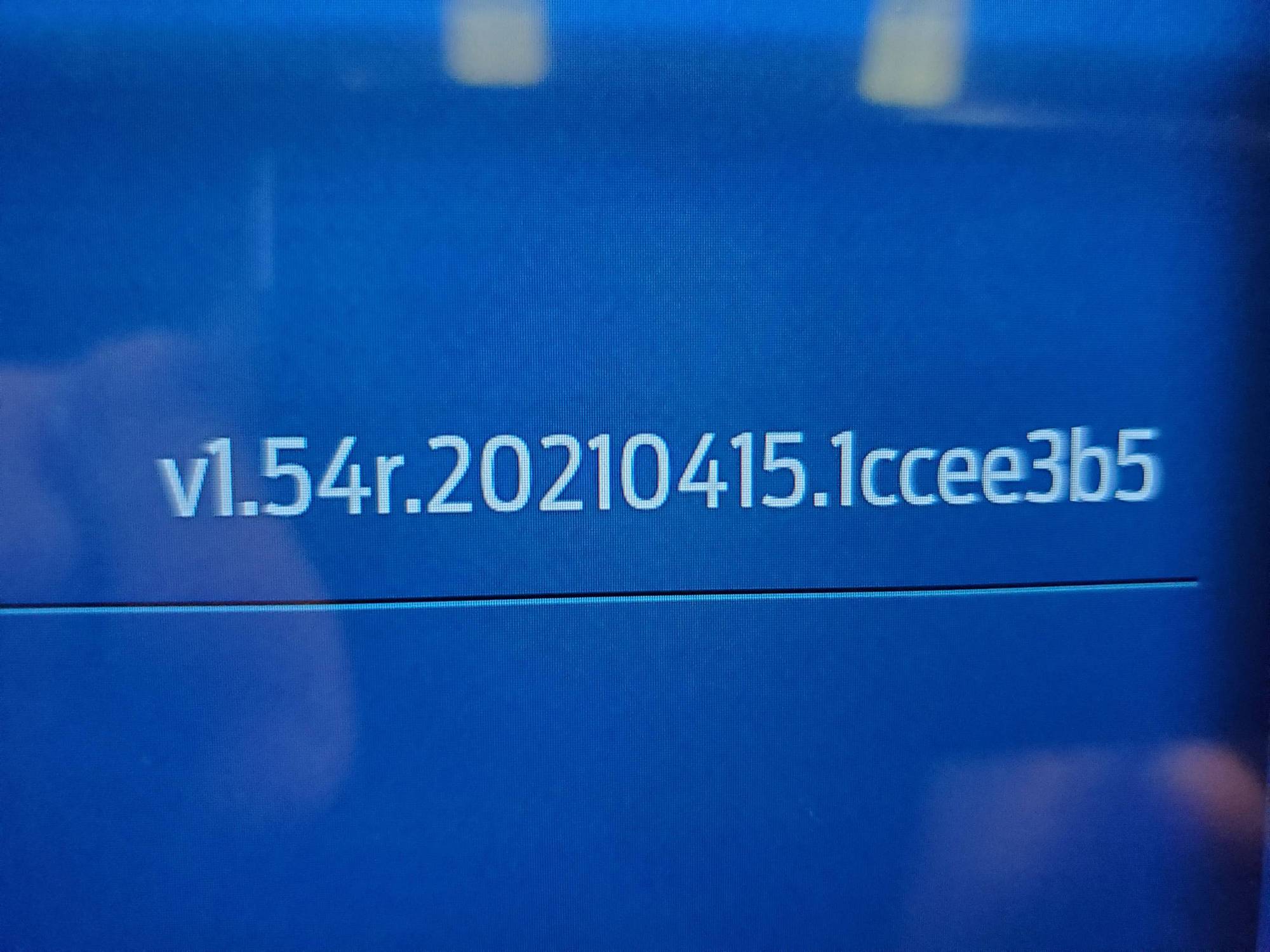

Originally Posted by Brantel
Thanks for posting this. It appears we have the same Sync and Navigation versions of the software (see my post #11). I’m baffled.

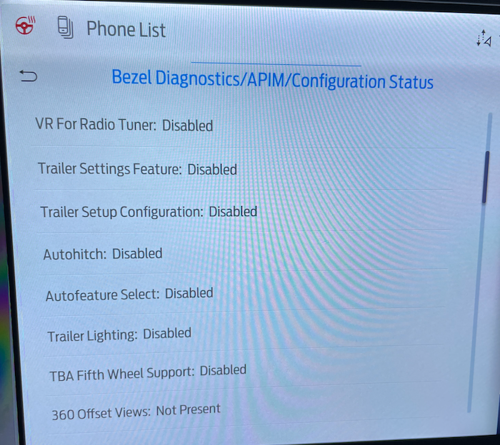

It looks like something may have changed in the APIM coding, because I entered debug mode on my Sync 4 and it clearly shows the Trailer Settings & Trailer Setup Configuration disabled. I wish I had made a full as-built backup when I took delivery last month. I wonder if Ford is pushing configs OTA?
I’m barely a novice user of Forscan, but have wondered if there is an option that needs to be enabled in the APIM. I looked at my APIM configuration and didn’t see anything obvious. Although, there were a few items related to the navigation system.

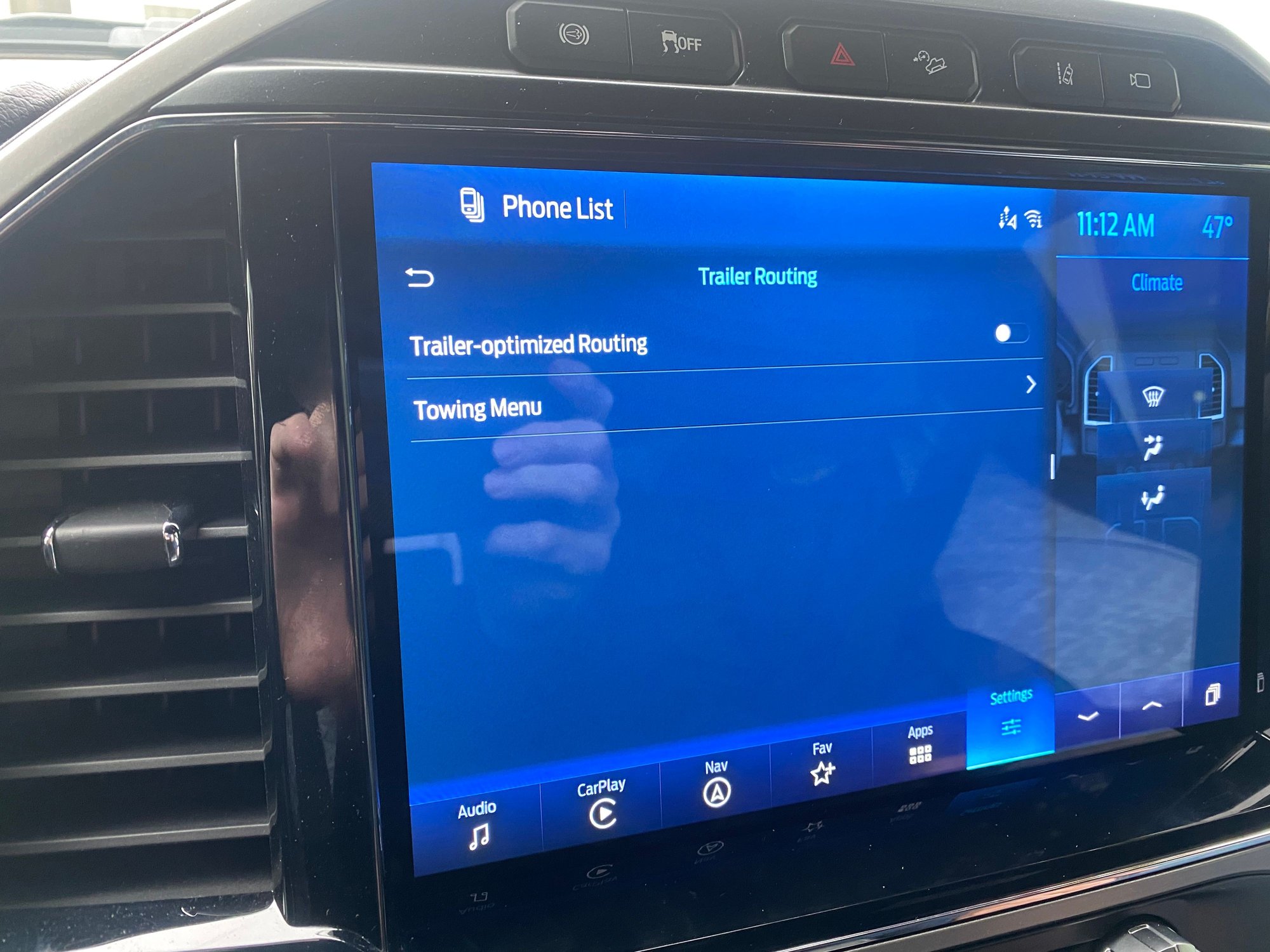

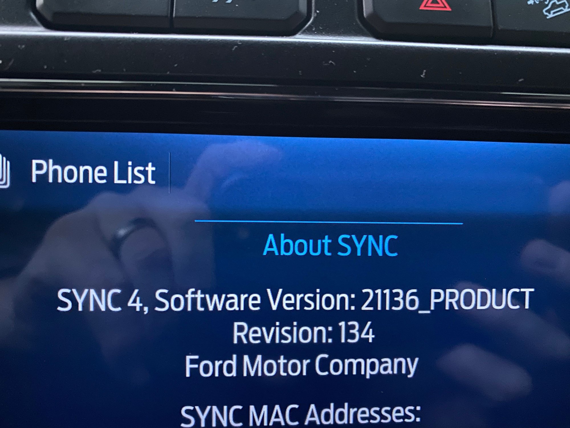

I spent 2 hours on the phone with Ford Sync support. The only way I was able to get that menu to show up was to do a Sync master reset (from the general settings menu). I should have kept them on the phone to ensure correct operation... because there must be a bug in the menu system, as when I turn the option on, the screen goes to the "checklist" menu, never allowing me to setup a trailer. Then after I connected my phone via android auto, the trailer nav menu selection was no longer there.... I did another master reset, and the menu appeared once again, only to then disappear once I turned on "connected navigation".
@Brantel did you try turning it on and setting up a trailer?

I did and it does not allow me to actually create a profile. It did the same as you describe. It only shows a checklist. My Apple Car Play did not cause the menu to disappear however.

I’m guessing this feature is not ready for roll-out. I did a Sync master reset as described by others above. The trailer routing option was available after the reset, but I only got the checklist option as also described; no trailer configuration was available. After I re-established the connected navigation and FordPass, I lost the option for trailer routing.
