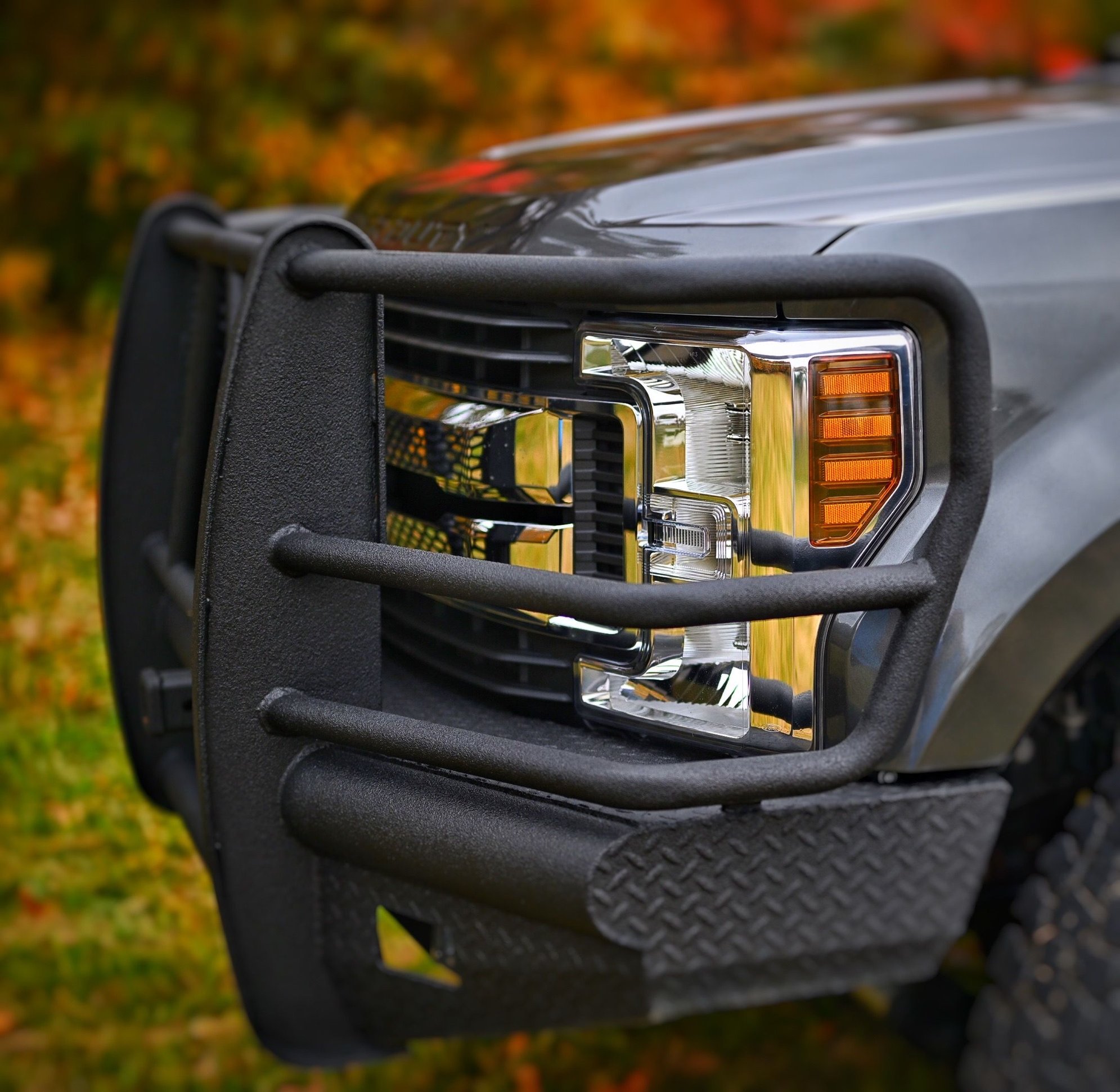

​​​​​​​Done in 2019, still looking great in 2024, two deer “bumped” and still like new. These pics 2024.

install complete
Originally Posted by JoeUser
Just don't get the brackets Line-x'd. They're never seen after installing anyhow, so just shoot a good rustproof flat black on them, and that shouldn't add a thick layer of material that might hinder installation...
My line x guy did a superb job, basically what you said while allowing the install guys to install without issue.
I did have to shell out an additional two hundred dollars for all of the sensor/camera/CC re-calibration upfront.. I know that's an expensive piece of equipment they use to perform that calibration. So I understand they have to recoup some of that expense. But I thought they would have included that in the original quote. Everything has worked extremely well with no false triggering.
Since I had ordered the plow prep package on this truck I feel the added weight allows it to ride exactly where it should. Unfortunately, I won't be able to put a plow on it like this. But that was really a backup plan anyway since I plow with my tractor. Obviously not critical however, if. anyone knows of a solution that would allow plowing in this configuration please pass it. on. The receiver hitch plows. I've seen would not appear to work as the hitch is just too high..
Uploading some pics. Thanks for all your help and insight!
