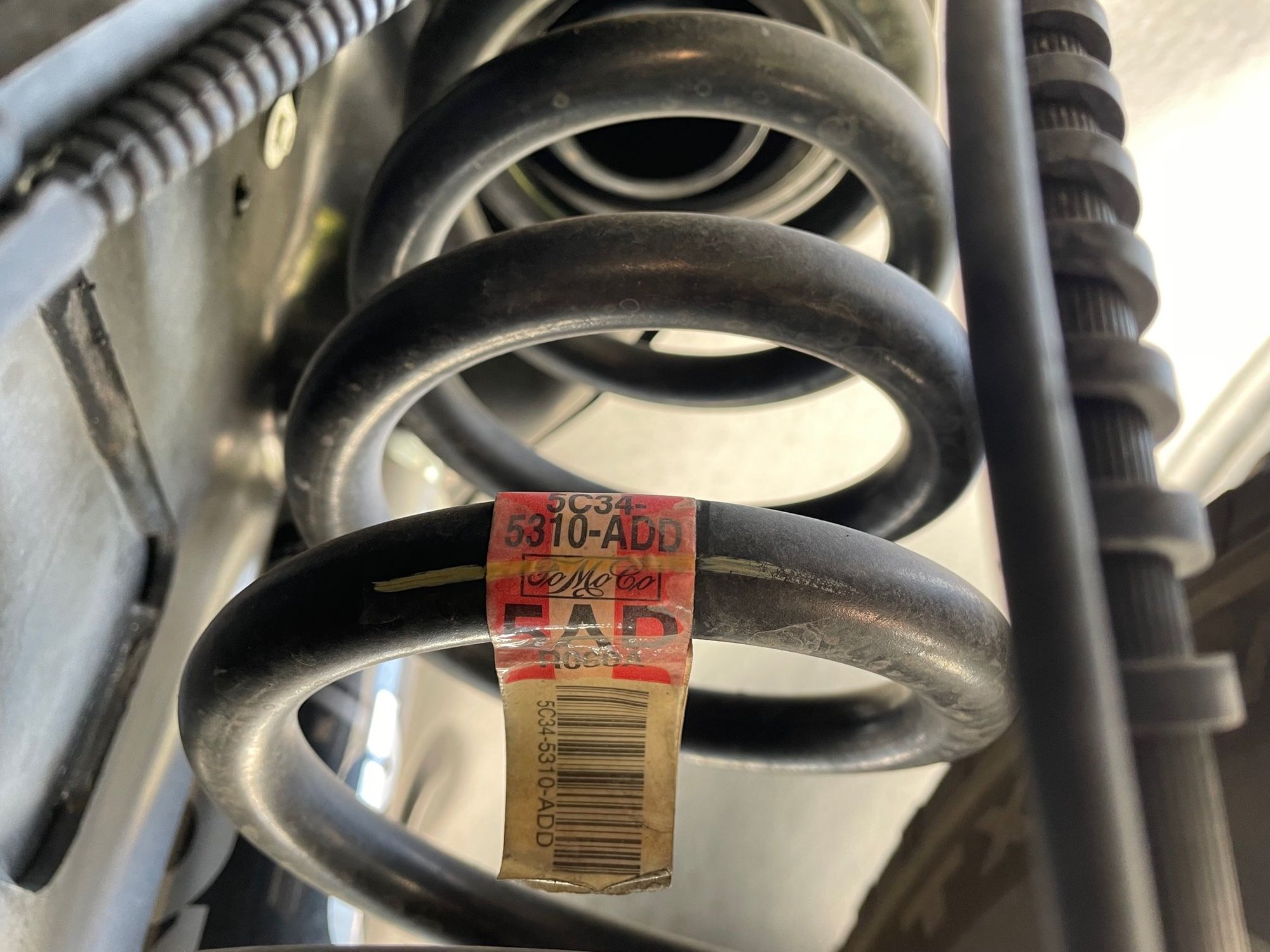

Originally Posted by 4wd6.7L
Do your 2019 5600lb coils have any part numbers on them?
This is the tag that is on my 5600 coil on the front.

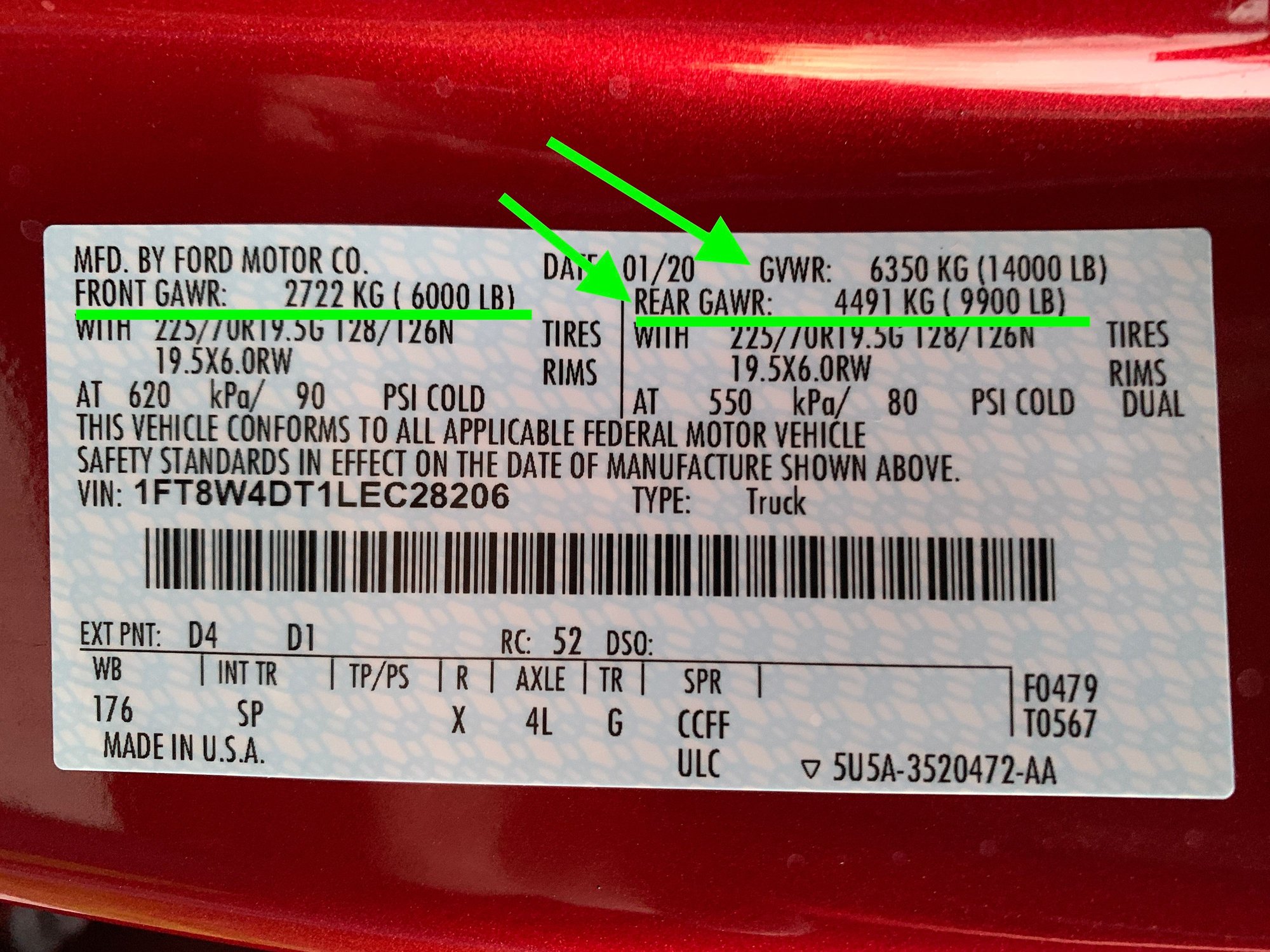

Originally Posted by Joe T
With the 6k springs it would feel pretty close to the heavy service springs unloaded (1/2 inch over stock). Mine was that way. Perfectly fine ride but did have bumpsteer a good stabilizer fixed.
Bumpsteer is not fixed with a SS, that is death wobble. Bump Steer is fixed by proper alignment of your Pittman arm, it is not centered and it has to be centered. Lots of folks confuse DW and Bumpsteer, two different animals two different solutions....
Originally Posted by SARDiverDan
I am just starting to look at springs and have seen heavy duty 6k springs and extra heavy duty 6k springs so I need to see what the differences are, if any, and go from there. Already installed a Kelderman dual stabilizer, Fox shocks, and I also have an aftermarket track bar and drag link. That's about as good as it's going to get up front so I figure a bump up in the coil spring weight will bring it back to, or just a bit over, the stock ride height I had before the install.
Not sure of the diff between HD and Extra??
Here is my door jam

From: SoCal/Wyoming
I went over to a local dealership today and looked up the 6k coil springs. The part number is 5C3Z-5310-CA for the 6k springs. That matches with the “C” code on your sticker so they should be the same. From what information I can gather, these springs will set the stock truck about and one inch higher than the 5600 springs. If that is the case, I should raise the front about 1/2 inch over the way it was before I added the bumper.
