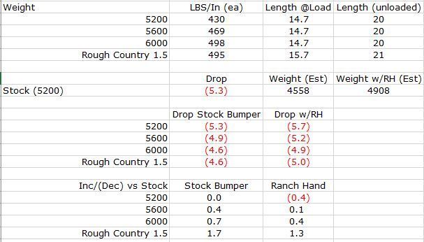

So I am a complete nerd but I decided to build out a matrix of all the options we've been discussing based on that spring rate chart someone posted higher up in the thread. Overall, it seems to track with the results some people are reporting.
I want to caveat, this includes a lot of assumptions, it would almost certainly be more accurate if I pulled my actual coils off and measured the true loaded/unloaded heights to get the actual "weight on front axle", but using the spec'ed loaded/unloaded lengths from Ford gets us close.
In my case I assumed the following:
Unloaded length of 5200lbs coil = 20"
Loaded length of 5200lbs coil = 14.7" (from the chart)
Total drop = 5.3" (20 - 14.7)
Estimated weight: 5.3 * (430lbs/in * 2 coils) = 4558
Ranch hand Legend = 350lbs (someone posted here or elsewhere that it adds this much net of the factory bumper)
Rough country coils (I reached out to their tech support directly): unloaded length of 20 11/16" (used 21 for ease of math) and 495lbs/inch deflection
So with all that in mind, if we hold weight constant and change the deflection rates, you should see an increase in ride height; conversely if you add weight and keep deflection constant then you see a decrease in compressed length.
ETA: I ordered a pair of the Rough Country coils, it'll be a while before I get them on the truck, but I will update/report back what the final results were (I'm expecting ~0.5-1.0" more than the table below since I have a '21 and the spring lengths/rates are for the 17-19 trucks which were taller according to people who've actually measured them).
All of these assumptions yield the following, thoughts?

Tex Hunter: This is the real data we need (with an additional column for part numbers).

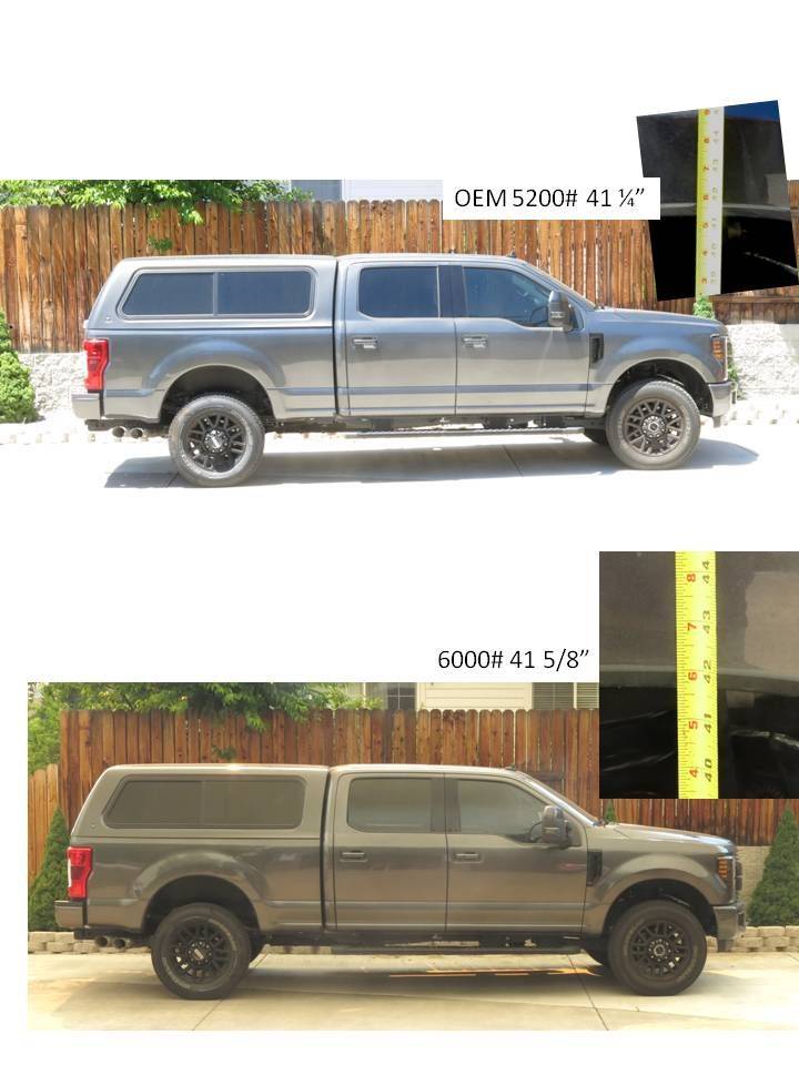

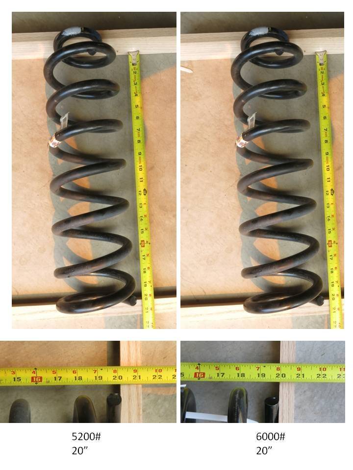

2019 F350 with 60 gal fuel tank (420 lbs), cap, and bed slide. I replaced the 5200lbs springs with the 6000lbs springs (5C3Z-5310-CA) and gained about 1/2" in height but...the steering is MUCH better. The front doesn't dive when breaking, it's solid over speed bumps, and left-to-right steering feels smoother (the fenders don't lean into the turn). I recommend this change, especially if you have the heavier fuel tank installed. I ordered the springs from Ford Parts Giant. They came in two shipments with just a shipping label attached. The part numbers were the same as were the code stickers but the codes were different colors. I have no idea what that means.
