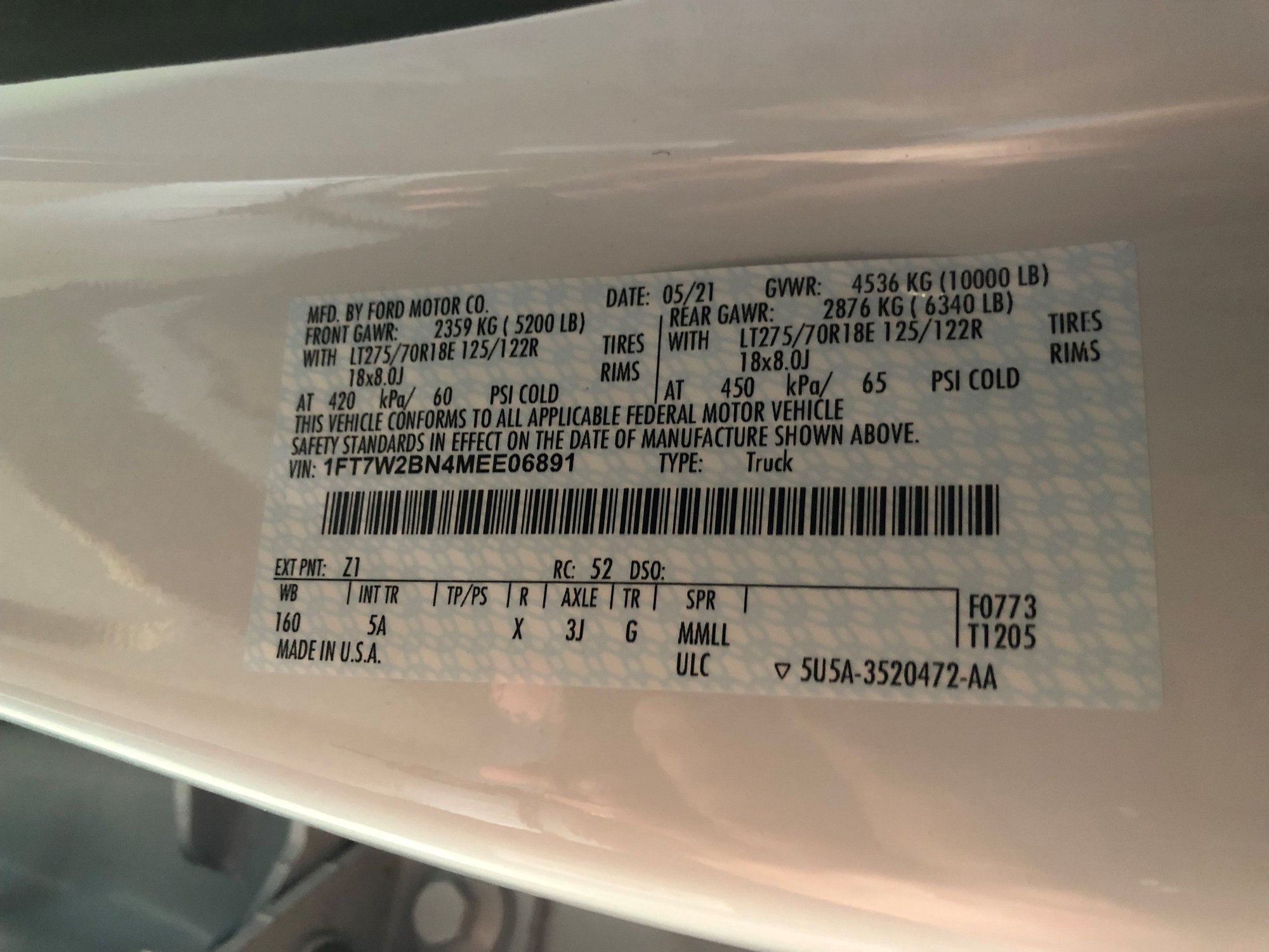

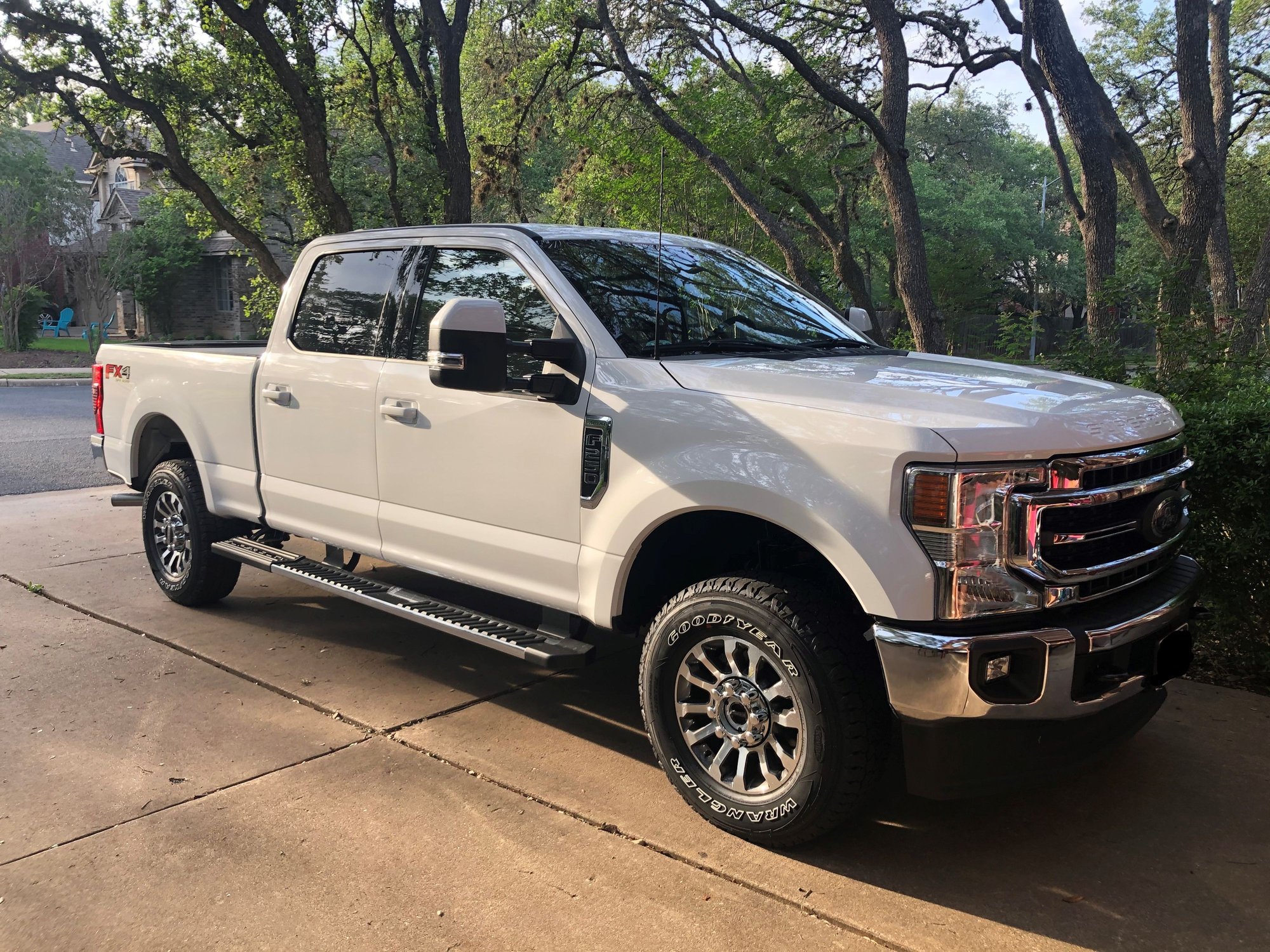

New forum member and first post here; tagging into this one, lots of super helpful information so far as I am about to add a Ranch Hand legend full replacement bumpers to my new truck (I am one of the few lucky ones that had a late May build that was actually built/shipped when it was originally scheduled).
I checked the info that 17 Oaks posted above (by the way, cool to see another McLane Ford customer here, they were awesome throughout my entire purchasing process), and it looks like based on my door sticker I have the 5200lbs front coils. Truck is a '21 Lariat CC SB, 7.3l gasser FX4 10,000 GVWR with the camper package.
So my question is this, would a set of 5600 coils be enough since my frontend is considerably lighter than the diesel? I am mostly looking to keep the factory look or at most take 1-1.5" of rake out of it once the bumpers are on, not looking to put much bigger tires, maybe a set of 295/70r18's when the current ones wear out.
I guess the other option would be to get a set of the Rough Country 1.5" coils, their website says "Diesel or V10 models only" but I checked and the Godzilla is only 90lbs lighter than the 6.8l Triton and with the Ranch Hand that seems to add about 300LBS Net vs stock, anyone have any experience with this route instead?
(Pics since first post and all)

You may just install the bumper and see how much drop you have and if you are OK with it. I wanted the front end to come back as close to the stock height I had before install so overall, I only lost 1/4 of an inch. The heavier spring also lessened that extra bump/wave feeling when going over bumps that I noticed after I installed the bumper. I am also having issues with my steering stabilizer (another thread) so any loss in height on my setup is causing increased issues with my Kelderman stabilizer and I can use all the extra lift I can get, short of going with a lift kit for which I am trying to avoid. You may not experience any of these issues so it's basically trial and error on yours and if it's good, go with it.

Thanks, yeah the front end is already a touch lower than I would like as it sits in the driveway right now and more importantly want to offset any of the wave/bobbing feeling you mentioned in your earlier post. I guess the question was whether to go with 5600 or 6000 since I am driving a gasser. Really annoying that the for the '20+ trucks the only options are either lower coil mount spacers or a 3"+ lift kit. Trying to get a little closer to the stance of the 17-19 trucks, otherwise completely satisfied with the way it is now.

The 5200# springs you have also come on diesel trucks, which have 700lbs more weight up front than your 7.3l. So the weight of the bumper shouldn't be an issue, but it sounds like you don't want to lose height, and possibly want to raise it some. Since SARDiverDan lost about 1/2" with the 5600# coils, I would expect yours to drop some as well, maybe not. You could get a couple buddies to stand on the stock front bumper and see if it lowers the front end haha.
I would first install the bumper, drive it around, and then decide if heavier and/or taller coils are what you want.
Edit- I see that you for sure want to bring the front up some. My guess is you might see 1/2"-1" from the 5600 or 6000 coils, not sure on how it might effect the ride. If the ride is satisfactory with the 5200 coils, a spacer may be a good option. Daystar makes a 1" top mount spacer, or as you have found there are many other spacer options.
