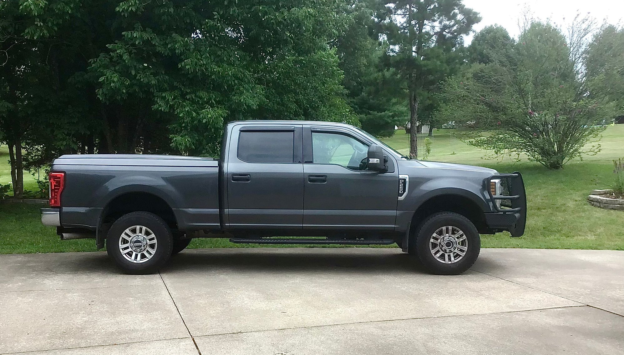

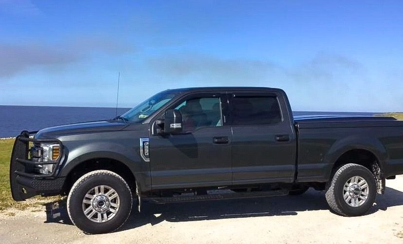

Think that is a smart move, I had the heavy duty alternator and dual batteries with my 6.2l and it still came with the lightest springs. Bet yours comes with 5600.
I took a quick image grab today when traveling, and also posted an early photo from three years ago, you can see a diff even with different locations. I now have a few hundred miles on the 6000 lb springs, and the ride is so much better. The extra weight out past the axle does add a lot to the jounce and bounce on lighter springs and stock factory shocks. I have the new shocks sitting in the garage to be installed sometime this month along with the SumoSprings front and rear, along with the PMFdual stabilizer.
After 6000lb spring install
Stock light GAWR springs 6.2l

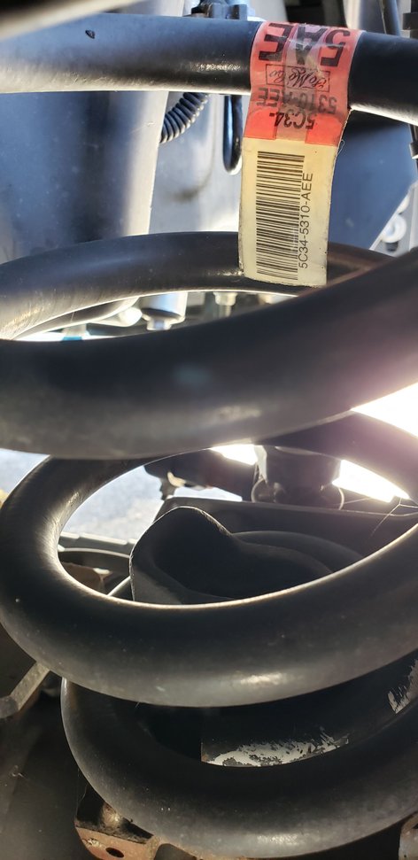

I hope this doesn't hijack the thread. I've been looking all over trying to find a chart that explains the spring codes; not just the rates. I have a /19 F350 with the camper package and I think the front springs are the 5200lbs version. I want to put the snow plow springs in (I had them on my 17 and like the drive) but I want to confirm I don't have them. This are my magic sticker but it tells me nothing since I can't figure out the codes and my door sticker doesn't look like the ones in other posts. If one of you could confirm I have the 5200s, I can order the 6k springs. I'd would really appreciate some help. Thanks.
It is confusing, I haven't found any clear data for spring codes etc. Based on your door sticker I would say that you have the 5200# springs.....but then it gets confusing, the 5200 coils on my 2019 look to have a different tag.
