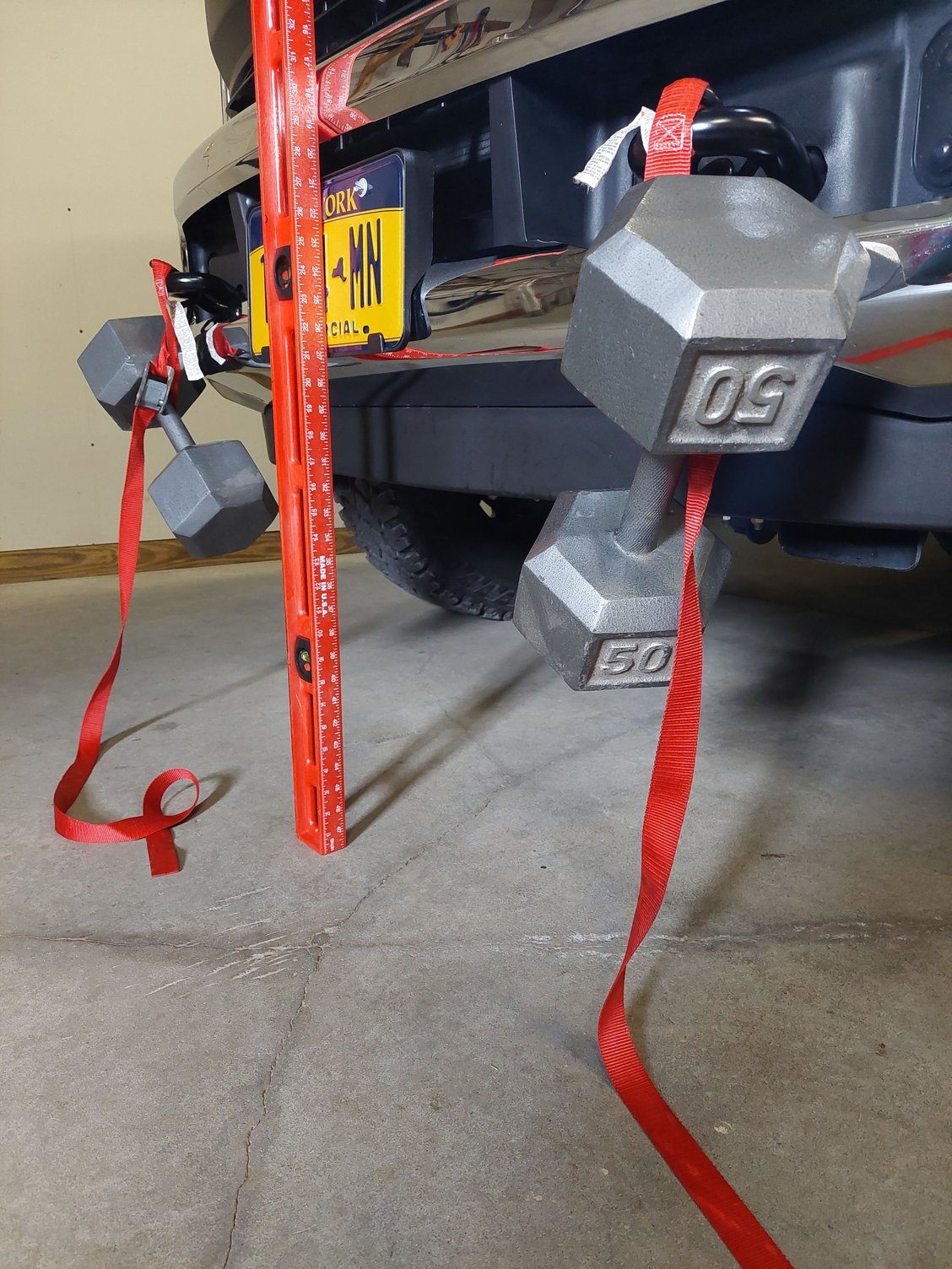

Here are some numbers I experienced. I am considering Buckstop Outback replacement bumper with full deer guard. The bumper part would be aluminum, the uprights and tubes and receiver mount are steel. The net increase is one hundred pounds. So I hung fifty pound dumbells off the front tow hooks and measured a drop.of a quarter inch. My truck has 5600 springs.

The full Ranch Hand Legend bumper that I have with camera cutout non winch plate (according to their site) weighs around 333 pounds give or take. Not sure how much a coat of Line-X on these would weigh but my guess would be no more than 10 pounds or so and even that might be a bit off but for generalization purposes, 350 is a close estimate when you add in hardware and all.

Hang one 50 pounder off the center and see what you get as it might be a better estimate taking into consideration that the OEM bumper won’t be there unless that already adds the OEM bumper weight to the plan. In other words, the new bumper will weigh around 150.

Nice nitebreeze! 100lbs / 469 lbs per inch = 0.21" of drop, so basically you are within rounding error of what would be expected.

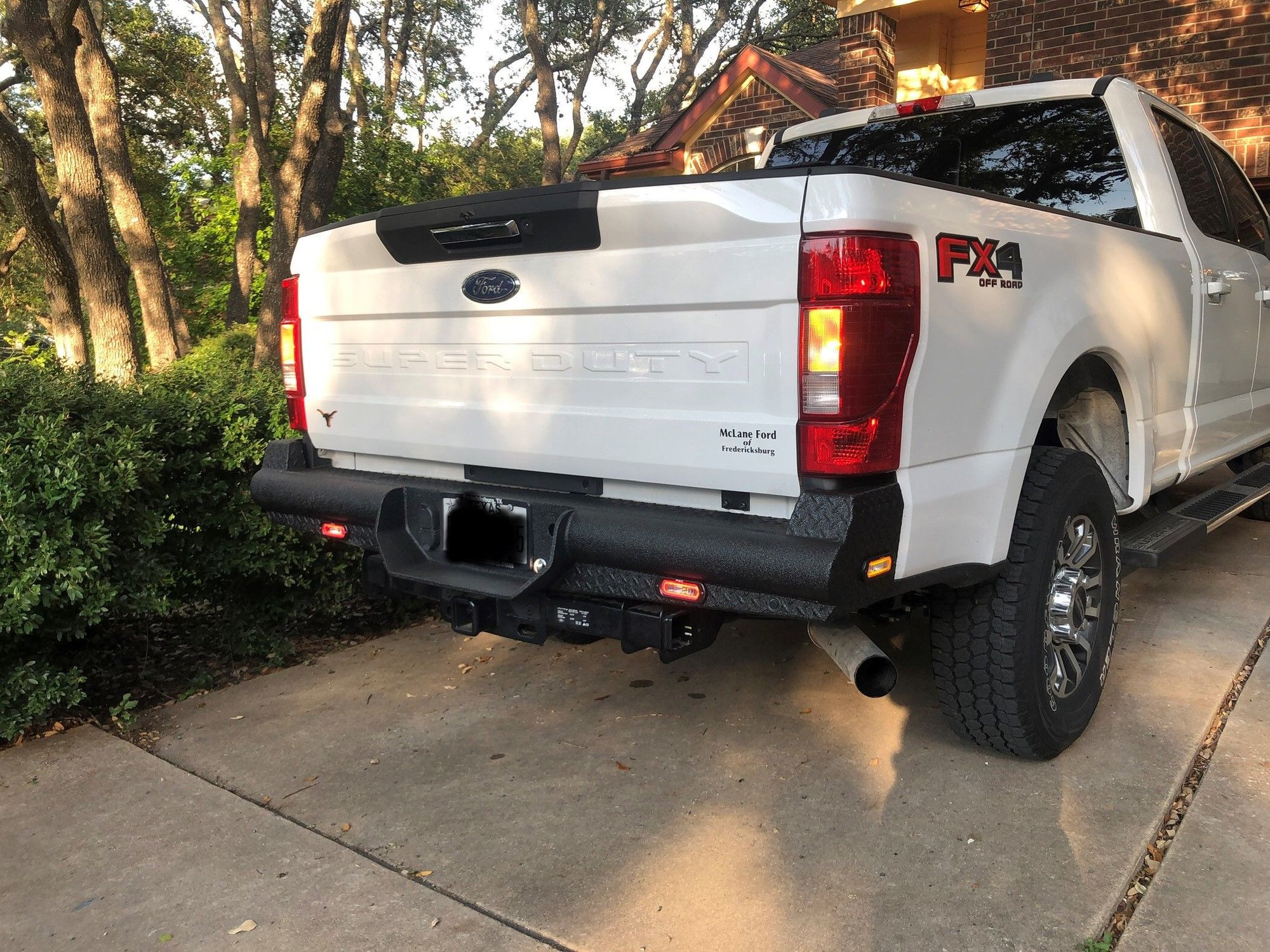

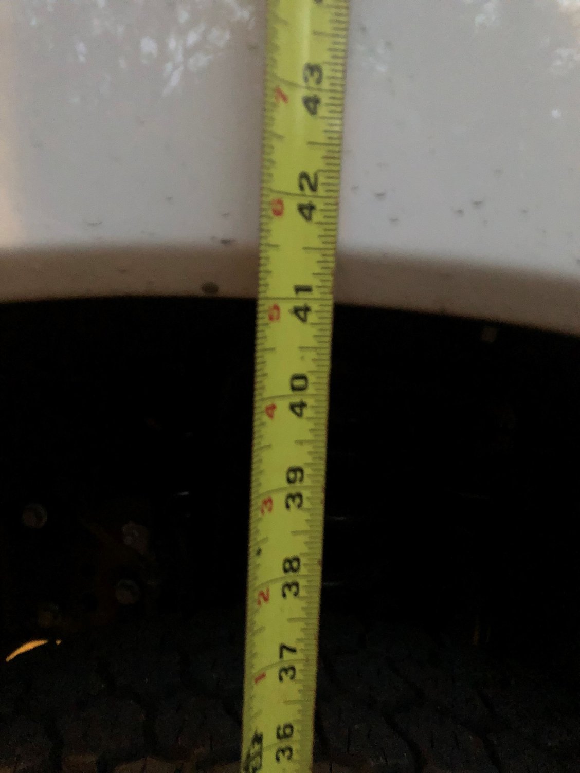

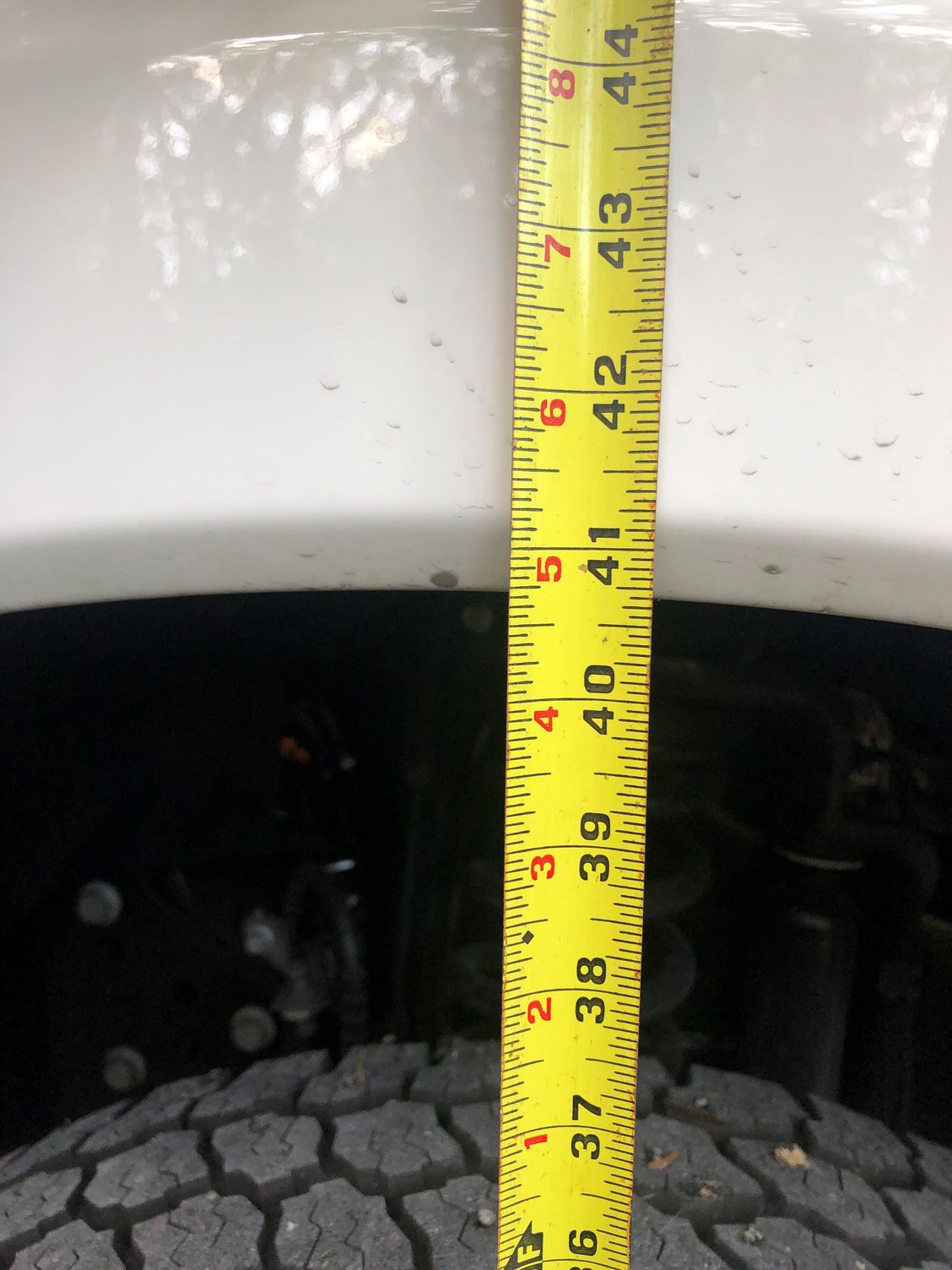

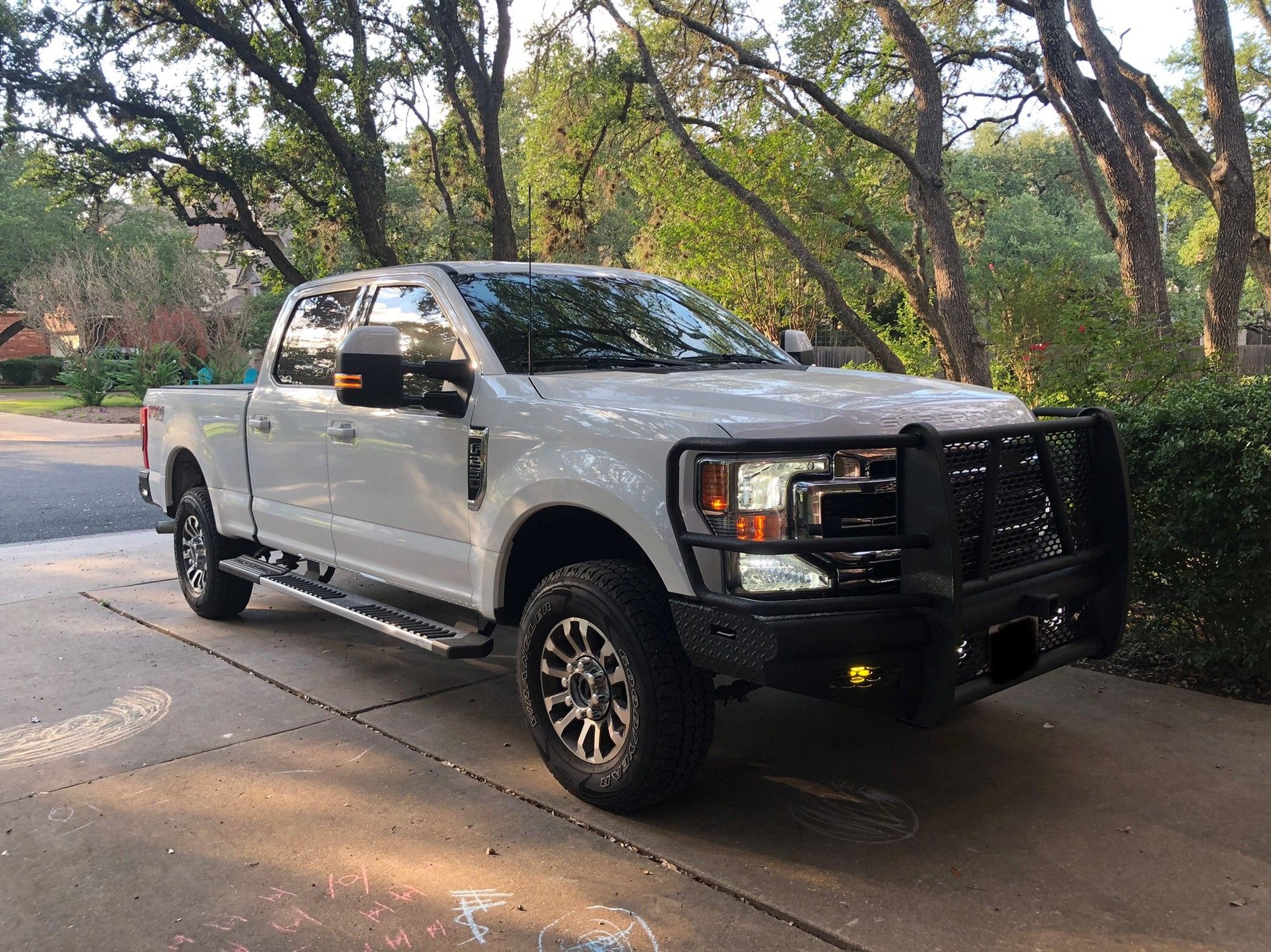

- UPDATE - Bumpers went on last week and the data has been crunched (pics below).
- Ride height before (ground to fender centered on the wheel hubcap): almost exactly 41"
- Ride height after (same spot): Just a shade under 40.75"
So with a total drop of just over 0.25" with 5200lbs coils, we can calculate that the bumper added about 215lbs to the front end (430lbs/inch x 2 springs x 0.25inches = 215lbs)
Initial impressions: overall ride did change, the front end is noticeably more compliant and softer on small bumps. Its not terribly bouncy on bigger stuff like speed bumps so I am going to drive it for a bit before deciding whether to use the 1.5" RC coils or whether to order a pair of factory 5600lbs coils to get me basically back to factory. My biggest concern was ride height, but it honestly isnt terrible once you remove that gawd awful front air dam. So I may wait until I am ready to go bigger on tires and do a proper leveling kit like a Carli Commuter or similar.
Now for the pictures! Want to start by giving huge props to Corey at LineX of Austin, the install of the lights and fit on the bumpers is outstanding. They got every taken care of turned around quick at reasonable pricing. Lights on the front are Rigid D-Series cubes (Pro Driving and SAE amber). I am not 100% satisfied on location yet, trying to figure out how to get both pods together in the factory fog light location, but theres not enough space on the ranch hand bracket to run them side by side, so hitting pause on that for now. I do kinda like the pair in the center section, feels like a throwback to the OG Super Duties from the early '00s. Rear lights for anyone curious are Rigid SR-L flush mount spreader lights.
- The rears are wired to the reverse circuit and an upfitter (with a diode so they dont backfeed into the reverse circuit when the upfitter is on) with the red halo wired to the tail lights so they come on when the headlights are on
- The side lights are wired to an upfitter with the amber halo wired to the blinkers (as an extra reminder to the people who like to camp in your blindspot and then get upset when you change lanes after they sat there while your blinkers were on for half a mile )
- I have an extra pair of the amber halo lights that was backordered that will go in the cutouts on the front bumper and be wired the same way
Let me know what y'all think!
