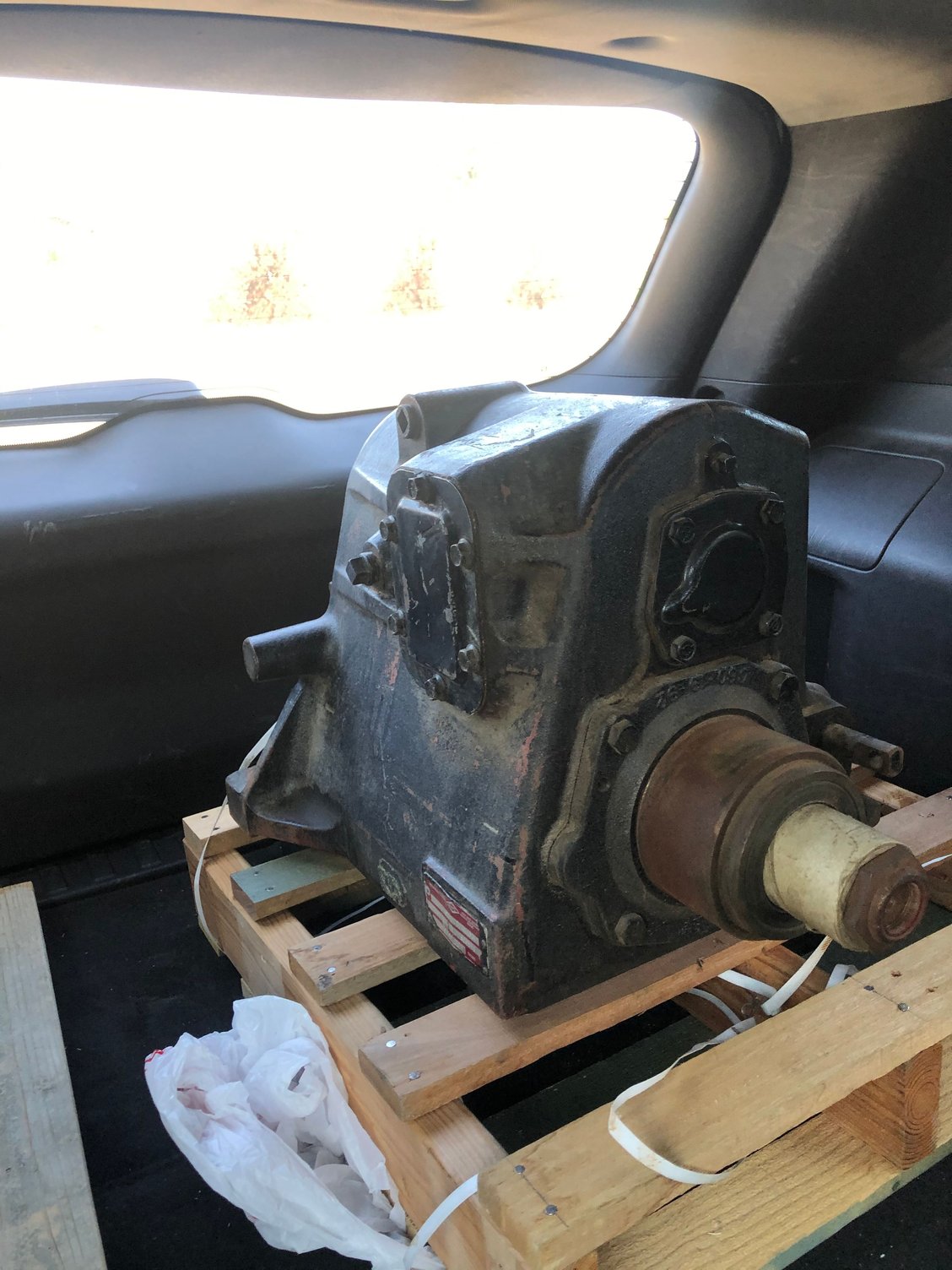

Update: My brother is picking up a 50 gallon transfer flow tank from my buddy this afternoon and will be delivering it to me when he comes to visit for the 4th! I cant wait to fill up once and just drive for 500+ miles! Even at 7mpg that is about 630 miles.
I am also taking a leap into the unknown and am picking up a spicer 7041 on wednesday. I have been giving it a lot of thought and I found one that looks new and has been sitting in a shop for years and years. I may scrap the idea and resell it but if I want to do it, this is the one to do it with. Here are pics of the 7041.
I think the lady is selling it on behalf of her husband (who probably isnt on social media) and to her knowledge it was never installed. Not sure how true it is but it doesnt have flanges or a mounting girdle.
If that is the case I would assume $750 is a good deal.
Here is a chart I put together. As you can see lets say I am going 70 at 2500 rpm and start going up a hill and lose some speed, I downshift to 3rd at 56 mph since I dropped to 2000 rpm. When I hit 3rd I bounce back up to 2800 rpm. I am kind of out of the powerband and wont gain much more speed. 4th under (.71x1.21=.86) brings me up to 2400 which I think is in the powerband and gets me accelerating again. I guess thats all theory. Also, I have some drives where I am unloaded and driving back home loaded. In a few weeks I plan to drive to So Cal unloaded and back with a friends jeep. I am in the middle of nowhere where the speed limit is 80 in some spots. Towing I wouldnt do 80 but unloaded, having 4th over would be nice to cruise at 80 mph at 2300ish rpm

Aux transmission will be badass! OD for empty highway and low for moving loaded trailers. Looking forward to how this works out for you!!!

I cant remember if your truck is a 4R100 or ZF6 but that would sure be cool and unique. I can't really picture how that would work with an automatic main box but know that was common to have a set of sticks in older big trucks before Fuller boxes became common. (I've seen Fuller boxes swapped into Cummins pickups as well)
With an SAE bellhousing adapter, we can bolt almost any medium duty truck transmission to our 7.3’s. BUT, this would require a lot of body lift or extensive transmission tunnel and firewall modifications - or both.
thanks guys! I’m excited. I unfortunately have a 4R100.
this guy shifts with an Allison auto in his. crappy video and I don’t like how he uses the speedo to make his shifts compared to RPM but the theory is, shift it into neutral and basically rev match it, I have seen similar videos where guys are shifting their aux trans with manuals still in gear and they don’t use the clutch. My assumption is that I’d have to do the same

Our speedometer signal comes from rear axle, so no math required.
Shifting should be no different than floating gears in any manual transmission. I only clutch from a stop in my ZF6.

Something followed me home today
