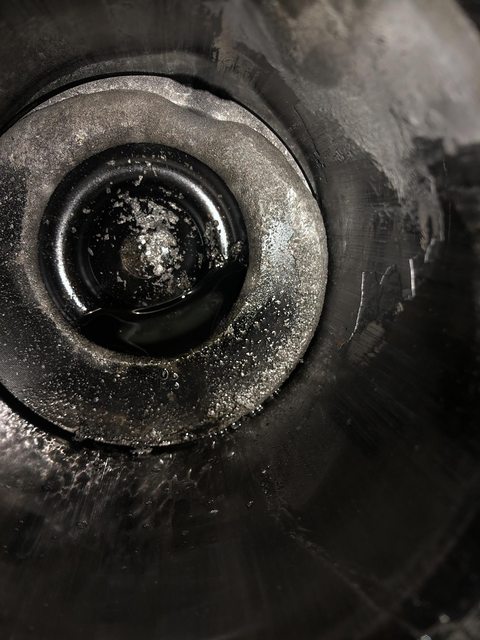

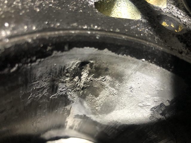

Long story short, I get all this done and the truck is running like ****, my buddy who has worked on 7.3s insisted it runs like **** but if I drive it it will clear itself up. It was smoking non stop if the motor was running....
As I am driving it, I ruin the motor with less then 3 miles on the new setup. I had orielly gaskets/harnesses for the injectors and one was jacked up and had an injector stick open and melted a piston. It was a tough day....

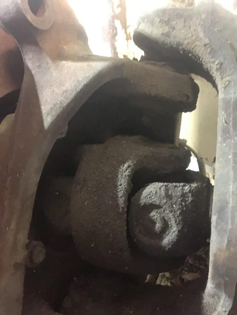

Sooo off comes the heads....I found out it was the injector harness because when I replaced it, it ran way better but the damage was already done and the blow by was bad.
Attachment 279967
Attachment 279968
So in comes this guy....
Attachment 279969
I pick it up for 2k, sell a bunch of parts off of it and make a little over half my money back.

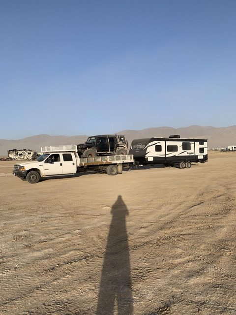

So it is almost time, to go to King of the hammers! I have the truck running 2 weekends before leaving. So the truck was driven around for 2 weekends to test everything, the new trans felt great, motor felt great and I had the driveshaft shortened and the manual shift 271 installed. I had to cut and modify the 2wd crossmember to make it all work but it wasnt too bad. It all worked out and had no driveline vibes....
I load the hummer on the back and go for the first loaded test ride up a grade.
It is my first time running loaded with all these new upgrades so I am being extremely cautious of the EGT gauge, that is the only thing I am watching. My ******* FORGOT to put the fan clutch back on and wasnt paying attention to anything but EGTs and POOF! The damn radiator cap comes off, coolant everywhere...I overheated. Oil hit 285. I let it cool off but the oil was so thin it wouldnt start back up. I thought I seized the motor. AHHHHHHHHH!!!!! Sure enough she ran again, got her down the grade to a gas station to fill the rad back up and gingerly drove home. The head studs paid for themselves at that moment.
Big idiot award goes to me! I was so happy with how it was running, especially for a diesel newb who looked at the 7.3 as a foreign engine when the HPOP lines blew up when I first bought it. I felt like I knew the truck inside and out rather quickly and messed up on something so stupid...but in the end, in some miracle, I didnt hurt the engine....
So off to KOH I go.

On the road and doing great!!! I am running in the 1023 medium tow tune.
Outside of bishop....
This setup weighs in just a tad under 20k gross. I had it weighed but no slip, they just wrote it on a piece of paper.
The truck is 11k, the Hummer is 6500-7k the rest is spare parts, camping stuff, etc.

At about 64 feet and at 28k lbs there she is in all her glory.
Attachment 279728
Towing up the 14 freeway went surprisingly well. I was able to maintain 65 most of the way and got under 55 once when I got stuck behind a truck, this was on a heavy tow tune.
Attachment 279727
We enjoyed the week and I even had to leave to tow my friends broke 4500 Ultra 4 car to his place to thrash 2 days straight and get it ready for the race. That was probably around 20k gross.
All in all she got us from Idaho to so cal and back with plenty of pit stops in between to tack on mileage. She did 2200 miles, about 1900 of it was 20k gross and 300 of it was 28k gross.
