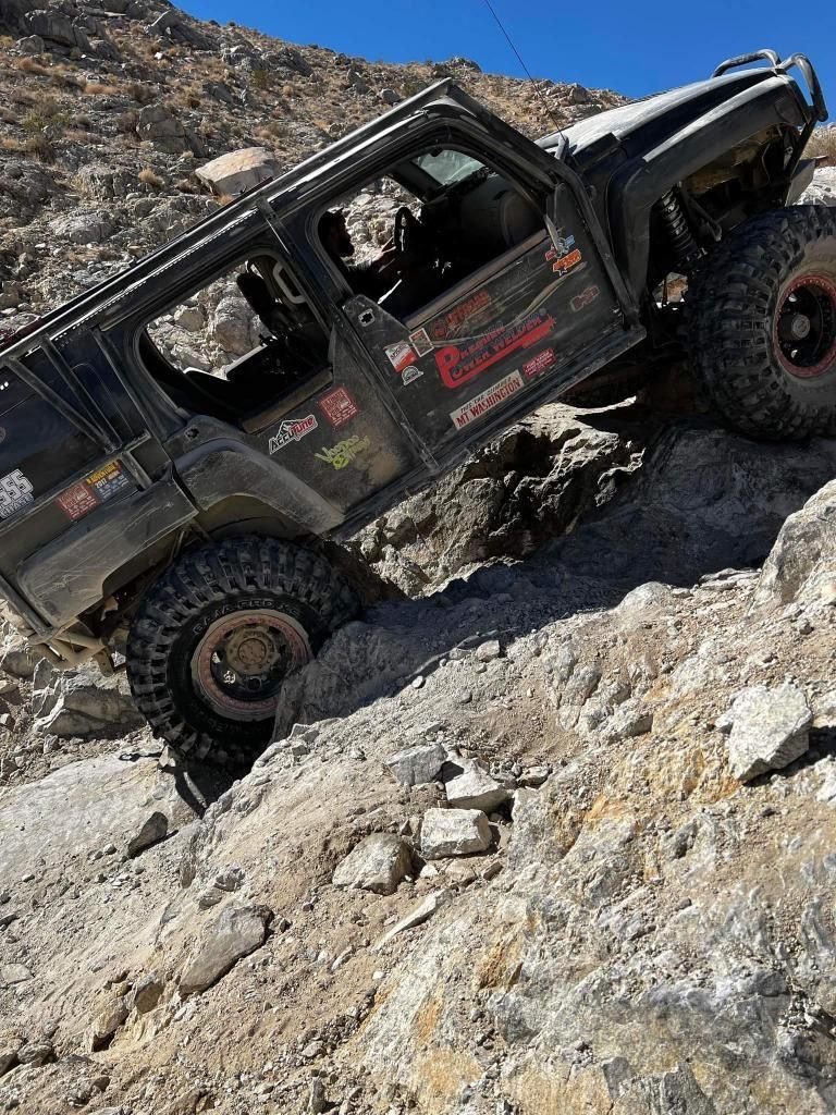

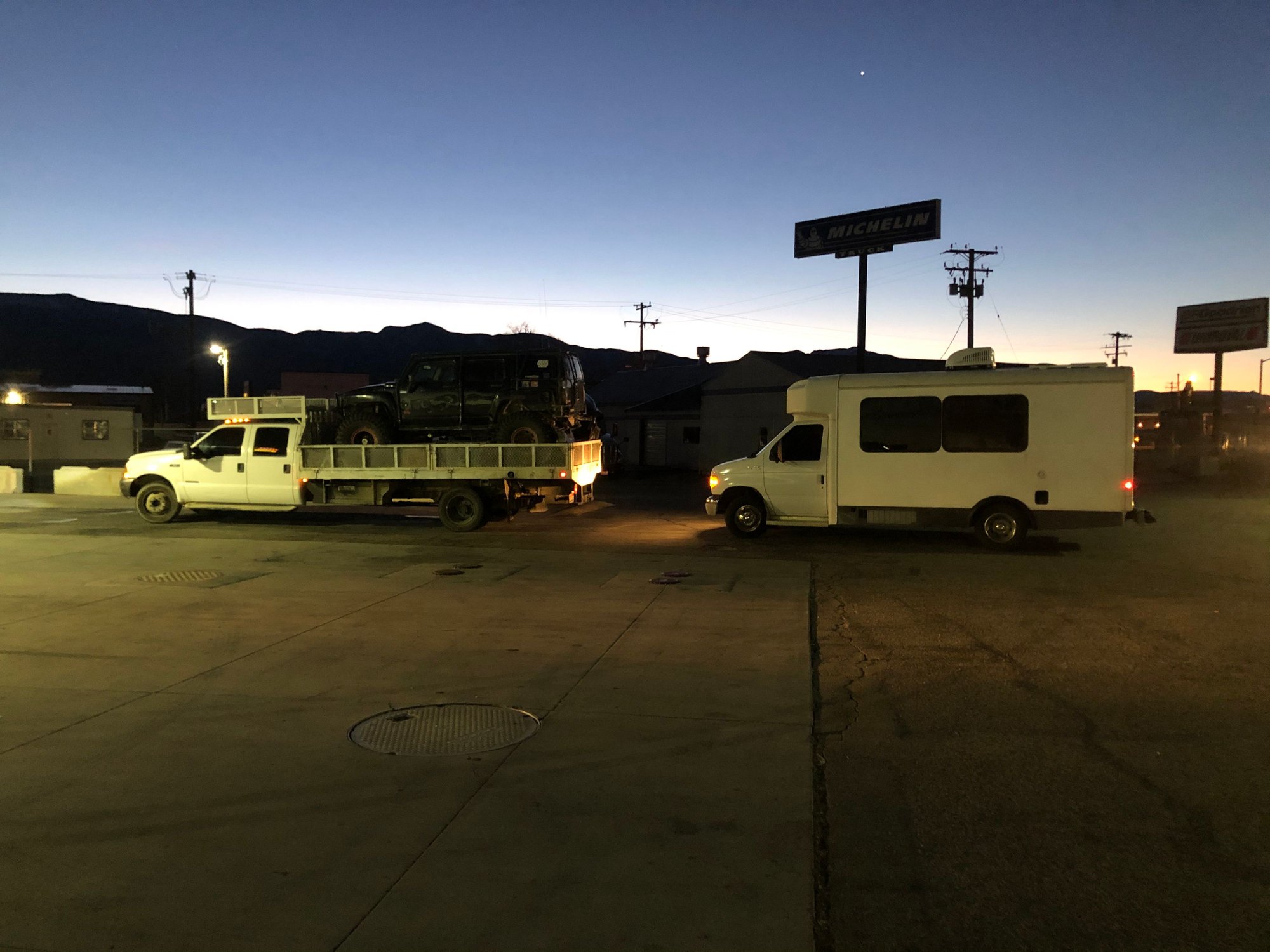

Got home 4 days ago. What a trip! Put another 1700+ miles on the truck.
I had an HPOP fitting leak. Kind of irritating. I think doing this trip in Nov where I had 60 miles of dirt roads knocked it loose.
It’s a cool feature to know that instead of blowing up the motor it loses enough oil to make it run like crap due to hpop pressure 😂
truck was flawless otherwise. I think I want to really dive into boost leak testing everything, I haven’t really done that since putting it together.
other then that I have another 1000 mile trip coming up to pick up those axles. I really want to make a priority to have the 4WD swap and aux trans in by June/July.
here are some pics.

The white E350 bus is my wife’s project. It’s a 2003 V10/4R100/2WD/dually dana 70.
it’s been converted to an RV inside.
