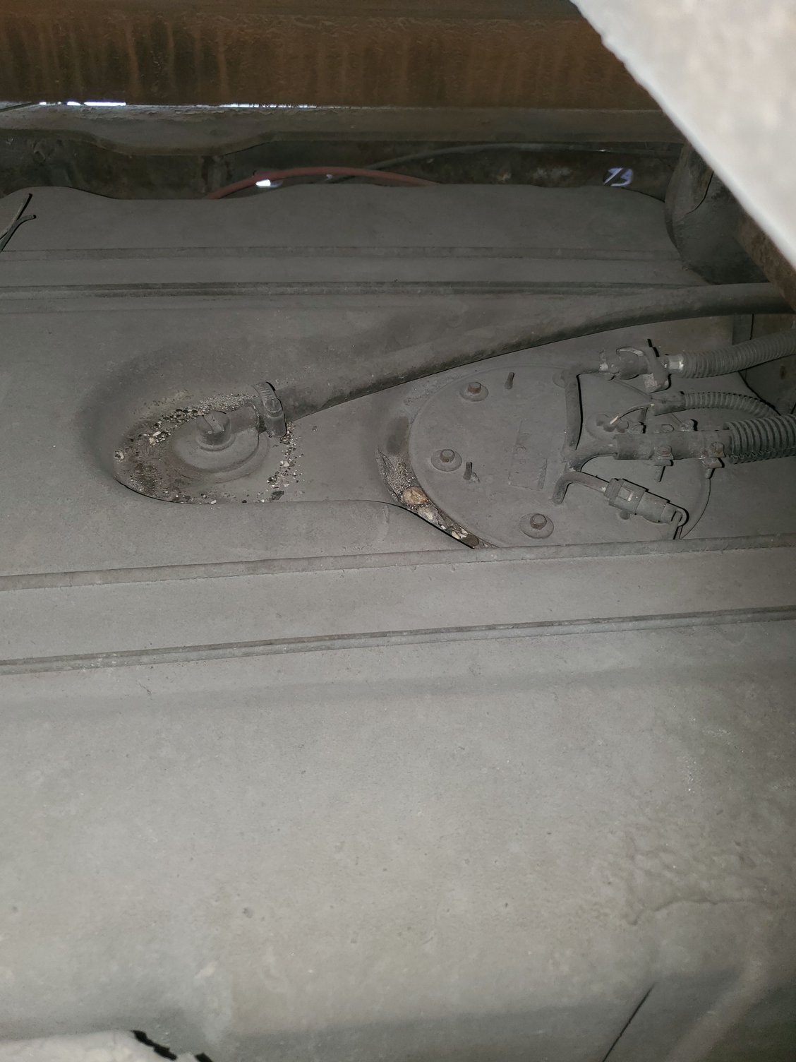

Thanks for all the info guys on the tanks.
I did confirm it is a 6 bolt sending unit. I also decided to pull the fuel bowl cap and look at the fuel pump before dropping the tank.
There isn’t anything visible inside the fuel lines near the pump.
I wasn’t sure if this is an issue or not, I don’t remember if this is new or not. The fuel bowl filter has 1200 miles on it and shows no sign of crap. It’s pretty clean, but I did find this stuff in the bottom.
https://youtube.com/shorts/XepL8apwtLE?feature=share
The fuel looks pretty clean to me. That could just be some of the residue that ends up on the inside the bowl.
A delaminating tank will clog the two little screens inside the tank sending unit that filter the larger particles that could ruin the fuel pump. You very well might have that problem by the sounds of your fuel pressure symptoms...
You'll need a new tank if that's the case. I'd be tempted by that aluminum one!

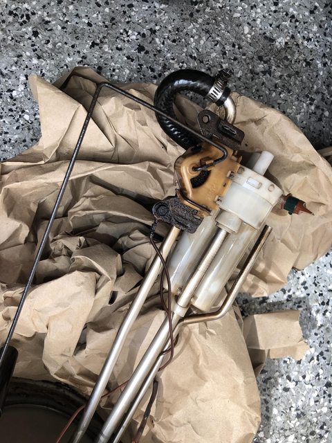

Here is what I found....

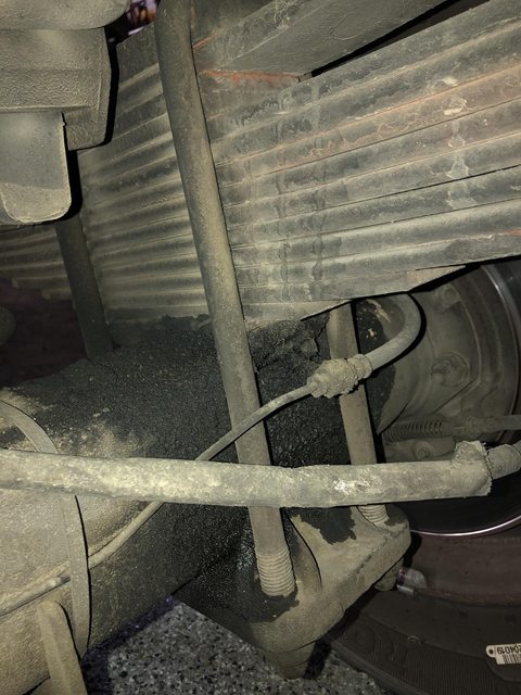

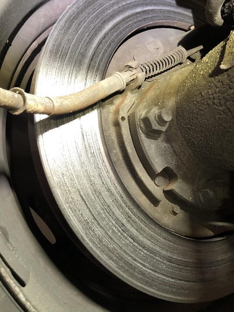

Then on another note, I never checked the brakes since purchasing the truck....this previous owner didnt believe in maintenance
and the damn drain plug was halfway out
So it leaked and had fluid about this high....awesome....
I noticed it was wet around the perches....
Everything was intact, I was suprised at how little they welded the perches from the factory though.
So what are your thoughts? The tank was red as hell, I assume it ran the red diesel for years since it was a state owned truck? Anyways, the pickup foot was gone, but other then that the fuel looked ok but the tank had some funky stuff going on.
