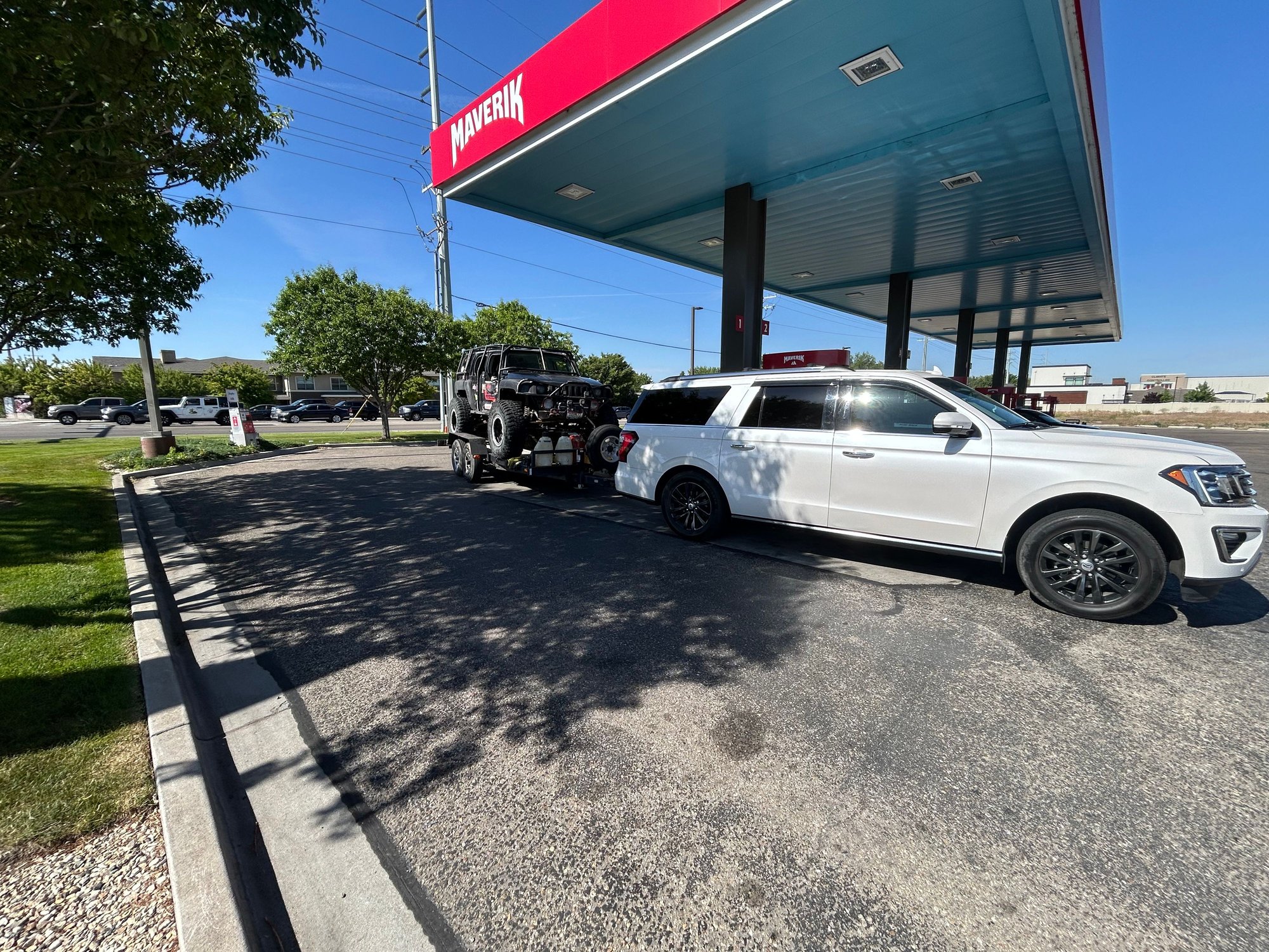

Well, my wife’s expedition Max with the Max tow package came in to save the day.
I’ve been driving this truck for a couple weeks doing pulls, data, logging, driving it and making sure it’s all good…. And it was.
10–15 miles into my drive, I have a boost leak.
Since I was so close to home, I turned around. I went back home.
It ended up being the boot off the turbo, so I tightened it back up and hit the road. It immediately had the same leak so I changed boots. After changing the boot it’s still leaked at that point. I wasn’t sure if it was that same boot or somewhere else, but I had already wasted hours and I had to hit the road.
This truck has been phenomenal, I’ve put 25,000 miles towing between 25K – 30 K gross but crap like this pisses me off. I am not sure if it is time for a change my first 1800 mile trip with the VGT went flawless the second trip, which is this one, with the 11+0 wheel ended up being problematic thankfully it was close to home.
I need to find out if this is VGT related or T4 related or just bad luck.
I have a S363/73/VGT with a 11+0 wheel. The 11+0 wheel picked up low end maybe I slap a .83 exhaust housing on it because I had a .91 before
Maybe I go to a KC GEN3 stage 1? It will alleviate boot issues. It will make turbo installation and removal easier. The T4 set up was a little bit of a pain, but the VGT set up is an absolute nightmare to work on while I do like it.
I guess I would love to hear some feedback and I will ponder this over my trip. The T4 is given me many good miles towing and the VGT has significantly improved school up, but hope this is not the cause of today’s issues

I am slightly over GCWR on the expedition. I know the engine and trans are the same as an F150. The max tow package puts in an F150 transfer case in it. I assume my only real concern is the rear diff. Let’s hope I don’t burn it up on this 1800 mile trip.
