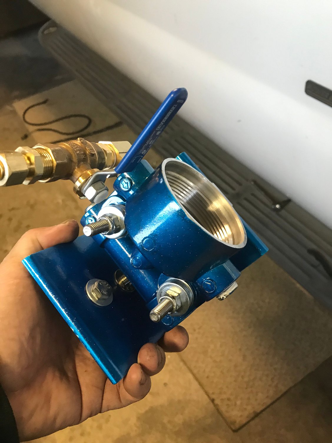

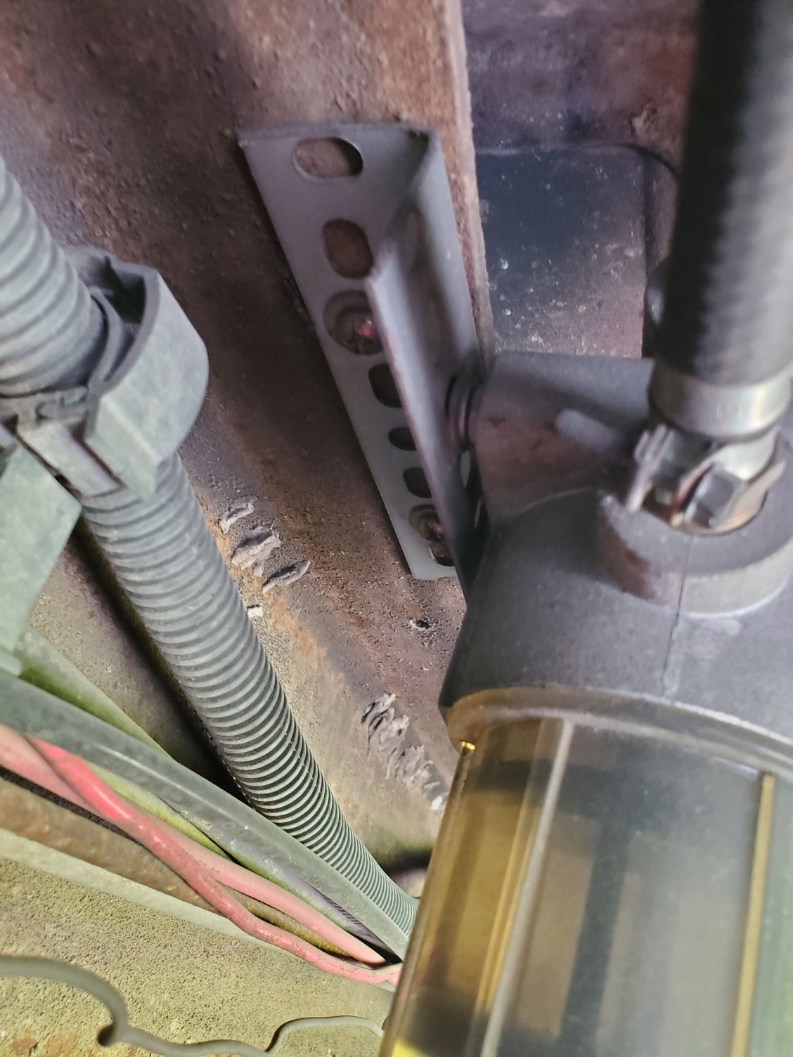

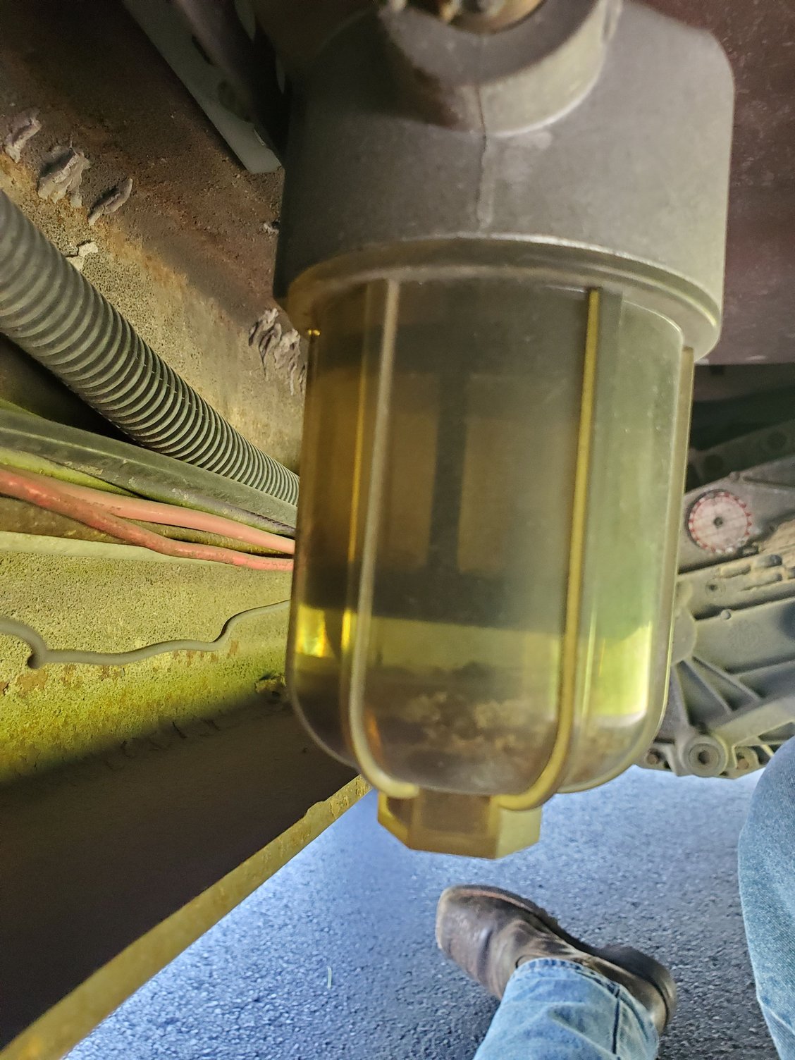

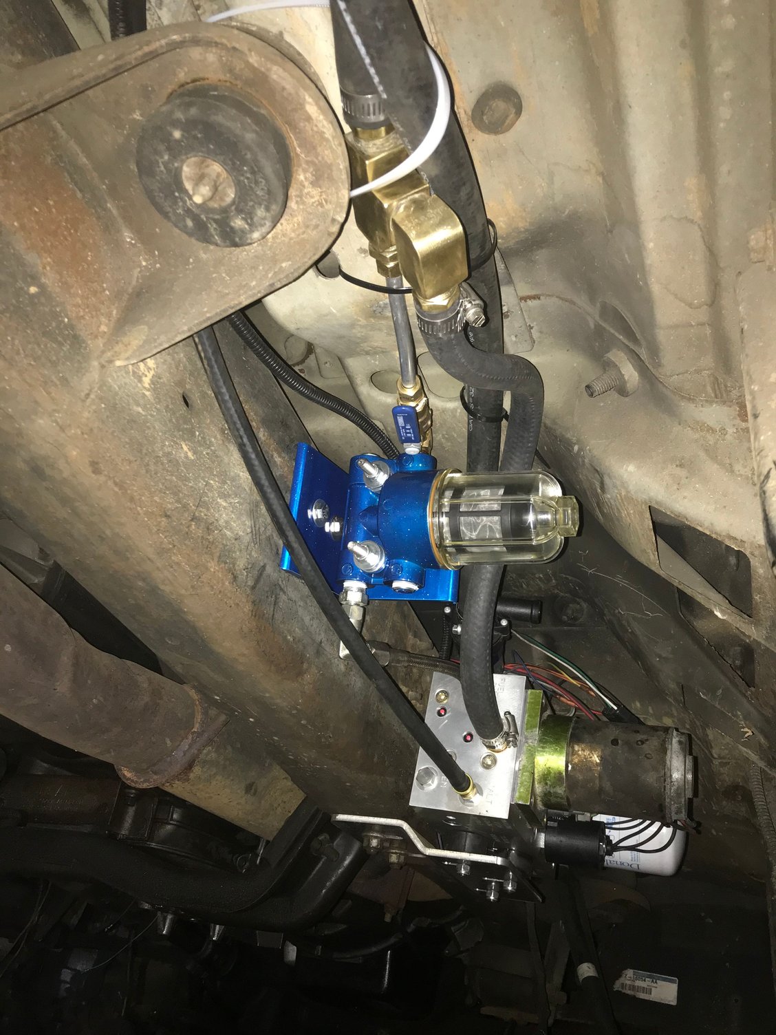

Yes I mount the racor ps120 on the frame rail using this angle with holes stamped in it from home depot. there should be holes already in the frame rail about 2 ft behind the transfer case. Here are some pics, you can see all the junk the filter has kept out of the fuel pump. I think it's time for me to clean the filter

Yes, install the PS120 instead of the WIX I used in my write-up.
I do not recommend running rubber hose all the way to the tank. Just put the PS120 in a similar place that I put the WIX 33972.
Rubber hose should be 30R9 or similar that is ‘lined’ to prevent internal degradation over time. ‘Cheap’ hose like 30R7 has a much shorter service life.
I use the PS120 on all of my vegetable oil conversions. I mount it horizontally because water separation doesn’t work on VO the way it does on diesel. You’ll want it to be vertical.
I also add a valve so fuel isn’t running out when I service filter.
