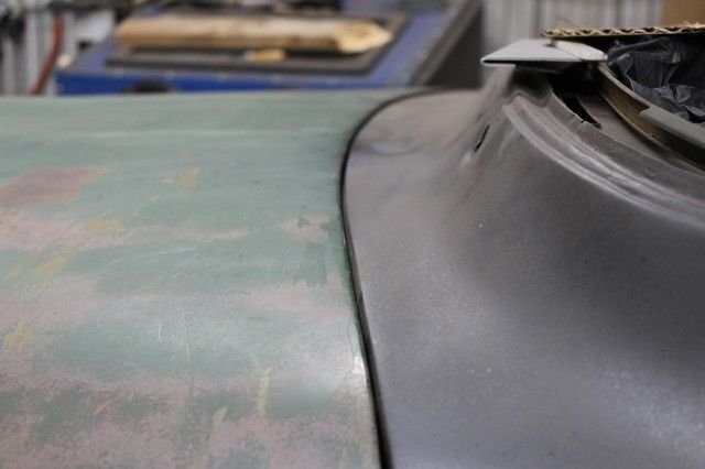

I was thinking I needed help getting the hood in place but managed on my own today..
Going to require a lot of adjustment and have my doubts it will be perfect but if I get it closer than it is now I'll be a happy camper..
Right now it's fitting too close to the cab and rubbing the cowl. It's like a puzzle right now trying to figure out what hole needs hogged out..
The contour of the roll over on the hood and fender don't match up either..
Left fender needs to come forward more yet..
