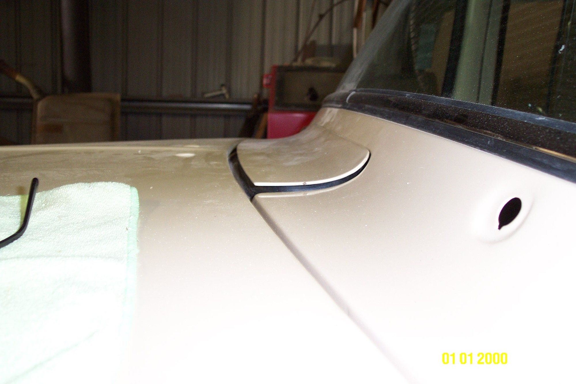

Here's mine , it's too tight at the back and won't sit down like yours .
i'm going to try bending the hinge where it is spot welded up under the cowl .
When i bought this truck the hinges were frozen and i think i've bent something when i was freeing them up .

Seaves46, I had the same problem. That's how/where my paint chipped. Bending the hinges won't move it forward. I elongated the mounting holes to tilt the front up a bit which allowed the vent to shift a bit more to the front.
