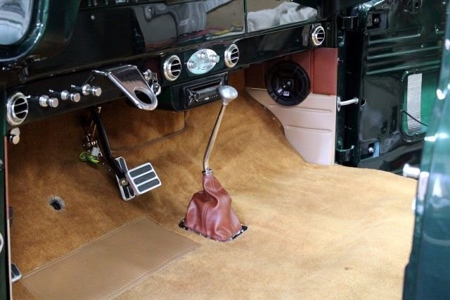

I need to get a shifter for my1956 F100. It has a C6 transmission. I've looked at what Lokar offers. They look a little more period correct but lever length, trans mount, floor mount, cable operated, linkage operated gets to be a little confusing for what combination will fit the best. I've also looked at the light truck shifter Hurst offers, the Pro-matic 2. It obviously doesn't look period correct but would probably be the easiest installation. Cost is about the same regardless. Either way, a cable setup seems like it would be the best option. Has anybody here used either a Lokar or some other aftermarket shifter in their F100? If so what combination and how did it fit?

I used lokar cable shifter. Here are some other threads about this topic. Remember,the search button is your friend.

Lokar 16 inch looks great in our trucks . Make sure you know if bench or bucket seats.

I have the lokar trans mount in my 55 f-100 bench seat. I has numerous adjustment settings. I bought the long handle and just got done hooking up the neutral safety switch on it . I am happy with it but one thing that I wish it had was a detente for each gear I should say each forward gear. Lokar say's that the trans internal detentes are okay but I would still like to have one in the shifter itself. I like the long and s curved handle. Good luck

In my panel I used a 12 inch Lokar cable drive shift lever because of the console
On my pickup I intended to make a console as well and bought a 16 inch cable drive shift lever
but changed my mind on the console...
Although it worked fine I decided to change out the stick to a double bend 23 inch

It has the original bench seat. Does that mean Lokar's handle for bench seats is the only style they offer that fits? For Lokar shifters I kind of prefer the look of their single bend handles.
I've wondered about the detent feature of the Lokar shifters. A feature I like about the Hurst Pro-Matic 2 truck shifter is its ratchet and lockout features ensure you cannot accidentally move it into the wrong gear. I guess ideally would be if Lokar offered something with some of the features found on the Hurst shifter.

Lokar locks in neutral and park...also has a neutral safety switch..
